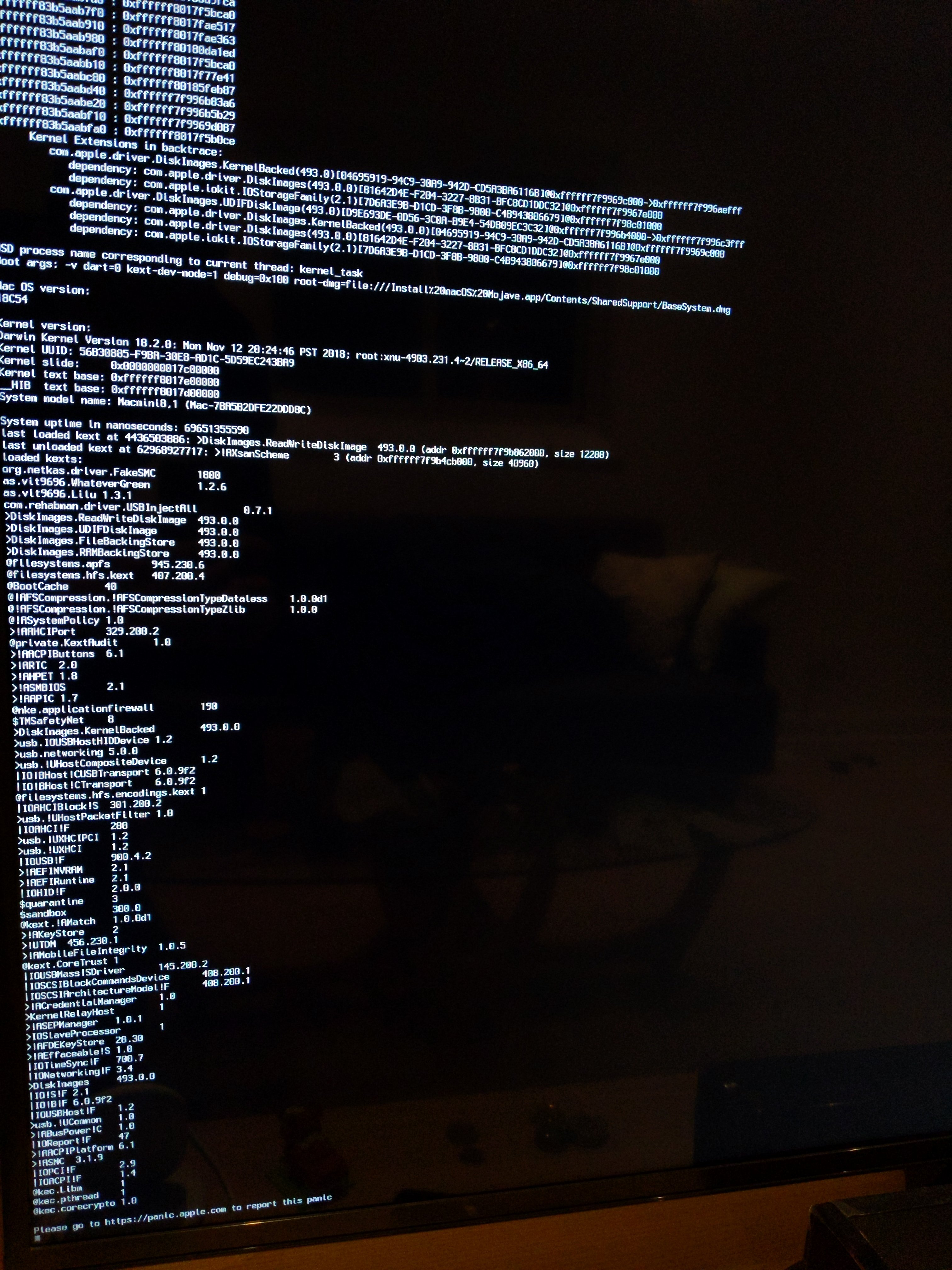

Been browsing the forums for a while and trying to setup a Mojave 10.14.3 with the following hardware:
  • Motherboard: ga-z370n-wifi - BIOS revision F5
  • CPU: Intel i7-8700k
  • RAM: G.Skillz Trident Z 32gb (2x 16gb) DDR4-3000
  • HDD: Samsung 860 Evo M.2 1 TB
  • PSU: Corsair RX750
USB used is 2.0
I've run into an issue where I'm trying to load the installer, but I am getting a panic error before getting to the Grey install screen.
Followed this guide:
See attached Screenshot for kernel panic.
If I need to provide more info, let me know and I'll do my best to provide the info :)
Also i'm not sure how to get the panic logs since I don't get shell unless I boot into single-user mode. (That of which I noticed a panic error whenever I try to run diskutil from single user mode)

I followed the video exactly and i still came up with the above error.
Do you think it makes a difference if it booted from panic?

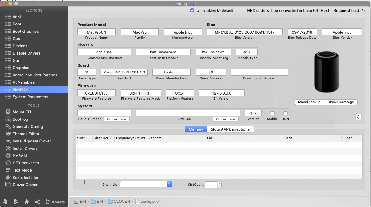

I don't believe it would make any difference.
I noticed for a system model Mac Mini 8,1 has been selected have . you tried to select something else?
This is mine you just select from the dropdown in Clover.
Thanks. What hardware to you have? the same?
I tried iMac 18,1. I can try a different one.
Do i need to clear the Serial # and Serial UUID or leave them auto-generated?

I have a Gigabyte GA-Z370m-D3H Motherboard which is very similar it also only has USB3 & 3.1 ports and Intel i7 8700 .
I never reset the serials i just tried a couple of different Models until i found one the mostly every thing worked straight up, now the only issue i have is the sleep issue which seems to be common..

      Open the the /Volumes/EFI/CLOVER/config.plist inside this new partition with Clover Configurator (used 5.5.0.0)
      Important modifications
      config.plist
      ACPI Page
      - Check: SSDT - PluginType
      BOOT Page
      - Add: Arguments - darkwake=2
      - Check: Legacy - XMPDetection=Yes
      KERNEL AND KEXT PATCHES Page
      - Check: KernelPm
      RT VARIABLES Page
      - Change: CsrActiveConfig - 0x3E7
      SMBIOS Page
      - Change: Macmini8,1 - Mac mini (Late 2018) | Intel Core i7-8700B @ 3.20 GHz
      - Click: Generate New (few times in the two buttons)
      Need some Kexts in the folder /EFI/CLOVER/kexts/Other/
      - Download the HWSensors 3 from here. I used the FakeSMC.kext, ACPIMonitor.kext, ITEIT87x.kext and IntelCPUMonitor.kext inside of DMG version r240.
