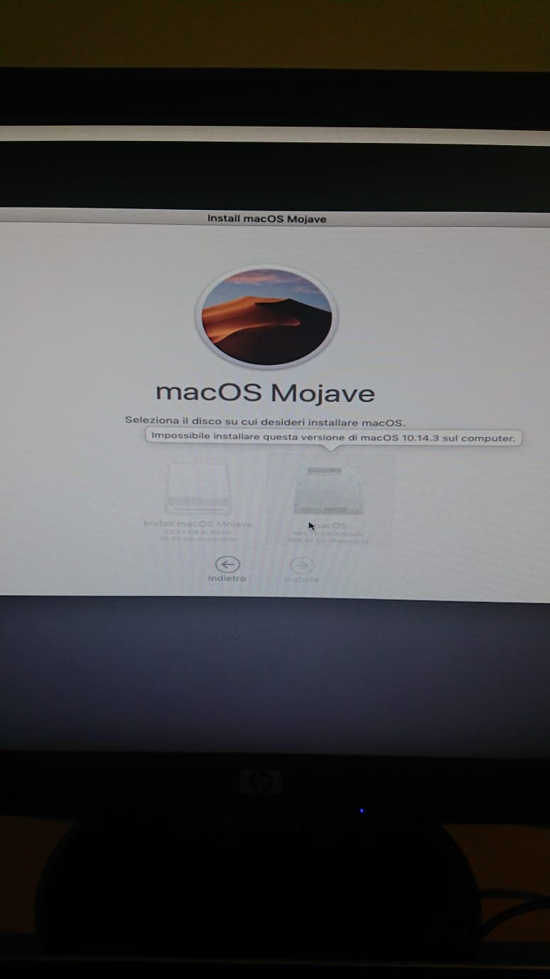

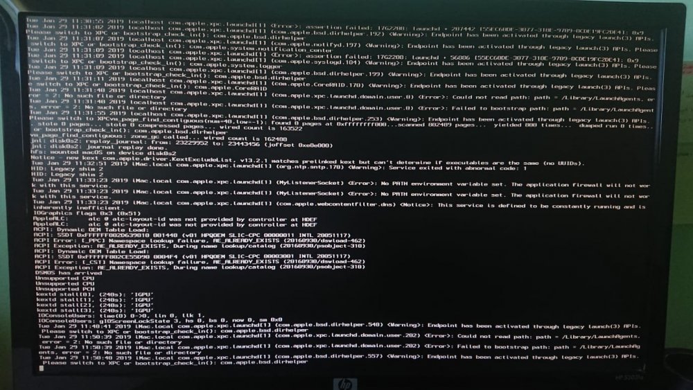

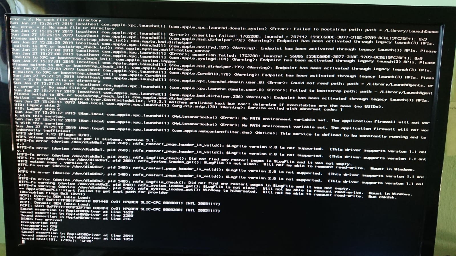

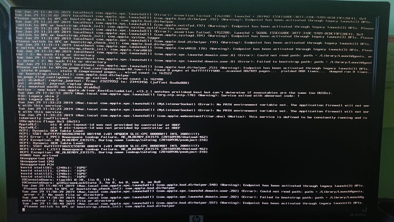

lollized Posted January 27, 2019 Share Posted January 27, 2019 (edited) Hi all, I just got the pc in the title (it's desktop, not laptop) and I want to do a vanilla install of high Sierra or Mojave. I put the hardware in signature. I just need a little help. I created a vanilla install of high Sierra, I downloaded the .pkg from the apple store and I installed clover 2-2 legacy (this pc doesn't support UEFI, I mean..). During boot I got stuck at "Kextd stall IGFX0". I booted using "-v npci=0x2000 IntelGFX=0x12345678 GraphicsEnabler=No". I also tried "-v -f -x" and the system doesn't boot at all and keeps restarting. Now I'm waiting to receive the Nvidia GeForce GT710M since by searching, the integrated graphics it's not fully working. Could anyone help me doing this hackintosh? Edited January 27, 2019 by lollized Screenshot added. Link to comment Share on other sites More sharing options...

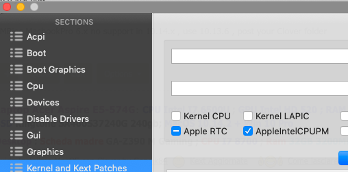

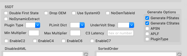

Baio77 Posted January 27, 2019 Share Posted January 27, 2019 (edited) Post your Clover folder SMBios in use ?? On 10.13 select IMac 11.x and put as in images on configplist Edited January 27, 2019 by Baio77 1 Link to comment Share on other sites More sharing options...
Baio77 Posted January 27, 2019 Share Posted January 27, 2019 Sorry if I dare to contradict you, I was a Laptop owner with this generation of CPU, the settings I recommended created perfect PMThis is written in the Arrandale CPU guide 1 Link to comment Share on other sites More sharing options...
lollized Posted January 29, 2019 Author Share Posted January 29, 2019 On 1/27/2019 at 7:29 PM, Hervé said: You're mistaken, that's all. All that's required on 1st gen Core CPU is to Generate PStates and CStates. The AppleIntelCPUPM patch is to avoid KP with CPU power management on the above mentioned platforms. It's not applicable to C2D/C2Q and 1st gen Core CPUs. I think it's Kepler.I paired the specs and seems that. It's not specified in Product page. On 1/27/2019 at 3:37 PM, Baio77 said: Post your Clover folder SMBios in use ?? On 10.13 select IMac 11.x and put as in images on configplist Did it, but can't reach the installer... here is my clover folder. @Baio77 clover.zip Link to comment Share on other sites More sharing options...

lollized Posted January 29, 2019 Author Share Posted January 29, 2019 (edited) 11 hours ago, Baio77 said: Test this in 10.13 clover.zip Thanks for your help. Nothing happens, still stuck at "kextd stall[0], (240s): 'IGPU".' Got stuck here... I just created a Mojave install usb + clover Legacy and in Other I put "USBInjectAll" by RehabMan and VirtualSMC. It booted to installer using "-no_compat_check -v" flags. Once reached the installed, it says that I couldn't install Mojave on the system during the selection of the target hard disk. I can format the hard disk, tried both APFS and HFS+ in GUID. @Baio77 I searched lot of forums and seems that could be the SMBIOS too old (I was using iMac 11.2). I'm trying to use a different SMBIOS, but could I use a casual smbios, or I need a specific? Edited January 29, 2019 by lollized Screenshot added, Edit 2: Added new test made. Link to comment Share on other sites More sharing options...
