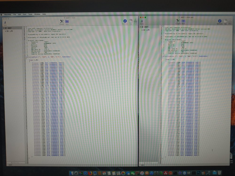

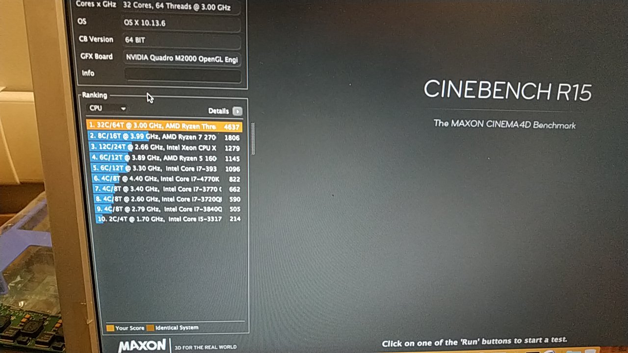

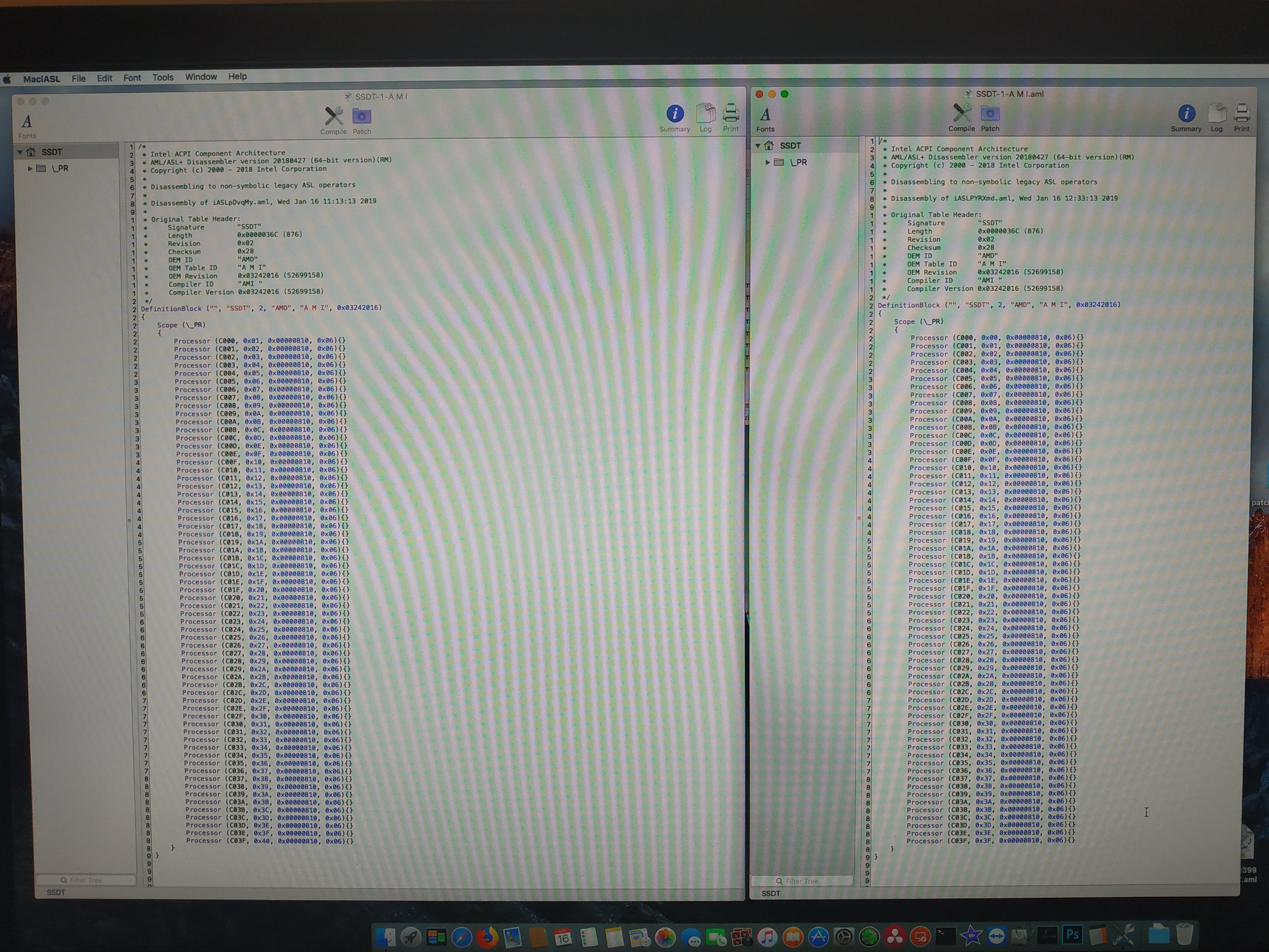

tomnic Posted January 16, 2019 Author Share Posted January 16, 2019 Boom... https://www.dropbox.com/s/fjgsetepi6yh9q2/EFI Gigabyte X399 Aorus Gaming 7.zip?dl=0 using this EFI folder https://www.dropbox.com/s/fjgsetepi6yh9q2/EFI Gigabyte X399 Aorus Gaming 7.zip?dl=0 solved every problem, I had to patch the SSDT with the processors aliases starting from 0x01 not from 0x00, just like suggested in this post as I'd already found https://osx86.org/forums/topic/20691-expert-needed-how-to-make-xeon-e5-2687w-v2-to-work/?page=2, as you can see in the attachment. So... happy AMD hackintoshing to everybody, this cpu is really nice in multithreaded apps!!! Link to comment https://www.insanelymac.com/forum/topic/337217-gigabyte-x399-aorus-gaming-7-and-2990wx-both-sierra-and-high-sierra-not-booting/#findComment-2659334 Share on other sites More sharing options...
