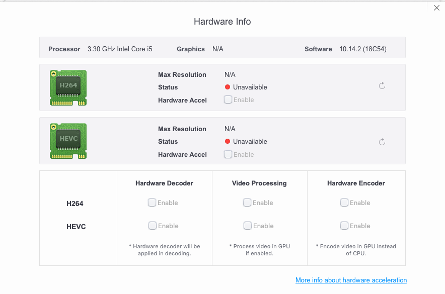

Napsi Posted January 9, 2019 Share Posted January 9, 2019 Hello everyone, I have a problem with the PC in Firma. The video card does not work properly, as you see the hardware acceleration is not enabled. Link to comment https://www.insanelymac.com/forum/topic/337155-rx-560-hardware-acceleration/ Share on other sites More sharing options...
ctich Posted January 9, 2019 Share Posted January 9, 2019 44 minutes ago, Napsi said: Hello everyone, I have a problem with the PC in Firma. The video card does not work properly, as you see the hardware acceleration is not enabled. show your config and composition EFI. Link to comment https://www.insanelymac.com/forum/topic/337155-rx-560-hardware-acceleration/#findComment-2658174 Share on other sites More sharing options...
Napsi Posted January 9, 2019 Author Share Posted January 9, 2019 1 minute ago, ctich said: show your config and composition EFI. CLOVER.zip Thanks Link to comment https://www.insanelymac.com/forum/topic/337155-rx-560-hardware-acceleration/#findComment-2658177 Share on other sites More sharing options...
ctich Posted January 9, 2019 Share Posted January 9, 2019 11 minutes ago, Napsi said: CLOVER.zip Thanks Enable bios IGPU DVMT - 32mb test this EFI. CLOVER-3.zip Link to comment https://www.insanelymac.com/forum/topic/337155-rx-560-hardware-acceleration/#findComment-2658184 Share on other sites More sharing options...
Napsi Posted January 9, 2019 Author Share Posted January 9, 2019 47 minutes ago, ctich said: Enable bios IGPU DVMT - 32mb test this EFI. CLOVER-3.zip I don't have IGPU. Asus P8P67 Pro, not support. Link to comment https://www.insanelymac.com/forum/topic/337155-rx-560-hardware-acceleration/#findComment-2658188 Share on other sites More sharing options...
ctich Posted January 9, 2019 Share Posted January 9, 2019 9 minutes ago, Napsi said: I don't have IGPU. Asus P8P67 Pro, not support. replace config. config.plist.zip Link to comment https://www.insanelymac.com/forum/topic/337155-rx-560-hardware-acceleration/#findComment-2658190 Share on other sites More sharing options...
e14883362 Posted January 10, 2019 Share Posted January 10, 2019 Clover - Graphics - Inject ATI Clover - Graphics - FB Name = Acre Reboot, Check it! Link to comment https://www.insanelymac.com/forum/topic/337155-rx-560-hardware-acceleration/#findComment-2658209 Share on other sites More sharing options...

vandroiy2012 Posted January 17, 2019 Share Posted January 17, 2019 Hardware acceleration didn't work without IGPU on Polaris cards. Read WhateverGreen.kext FAQ for details. There is no solution. Quote How do I use my IGPU? In most cases IGPU should be used for hardware video decoding (with a connector-less frame). In case you need extra screens, IGPU may be fully enabled. You should not use -radlogo boot argument with IntelGraphicsFixup. How do I get hardware video decoding to work? Generally hardware video decoding is performed by an IGPU, and thus you are required to inject a connector-less frame. For some GPUs (e.g. HD 7870, HD 6670, HD 7970) it is still possible to get AMD hardware video decoding to work. Please refer to Shiki's FAQ for further details. You may need shikigva=1 on mac models that have forceOfflineRenderer on. For now only RX Vega 56/64 with iMacPro1.1 macmodel can provide hardware acceleration without IGPU. 1 Link to comment https://www.insanelymac.com/forum/topic/337155-rx-560-hardware-acceleration/#findComment-2659524 Share on other sites More sharing options...
CMMChris Posted January 20, 2019 Share Posted January 20, 2019 Hardware Encoder of RX 4xx and 5xx card is not supported on macOS. You always need to use Quick Sync (IGPU) with those cards. Link to comment https://www.insanelymac.com/forum/topic/337155-rx-560-hardware-acceleration/#findComment-2660058 Share on other sites More sharing options...
