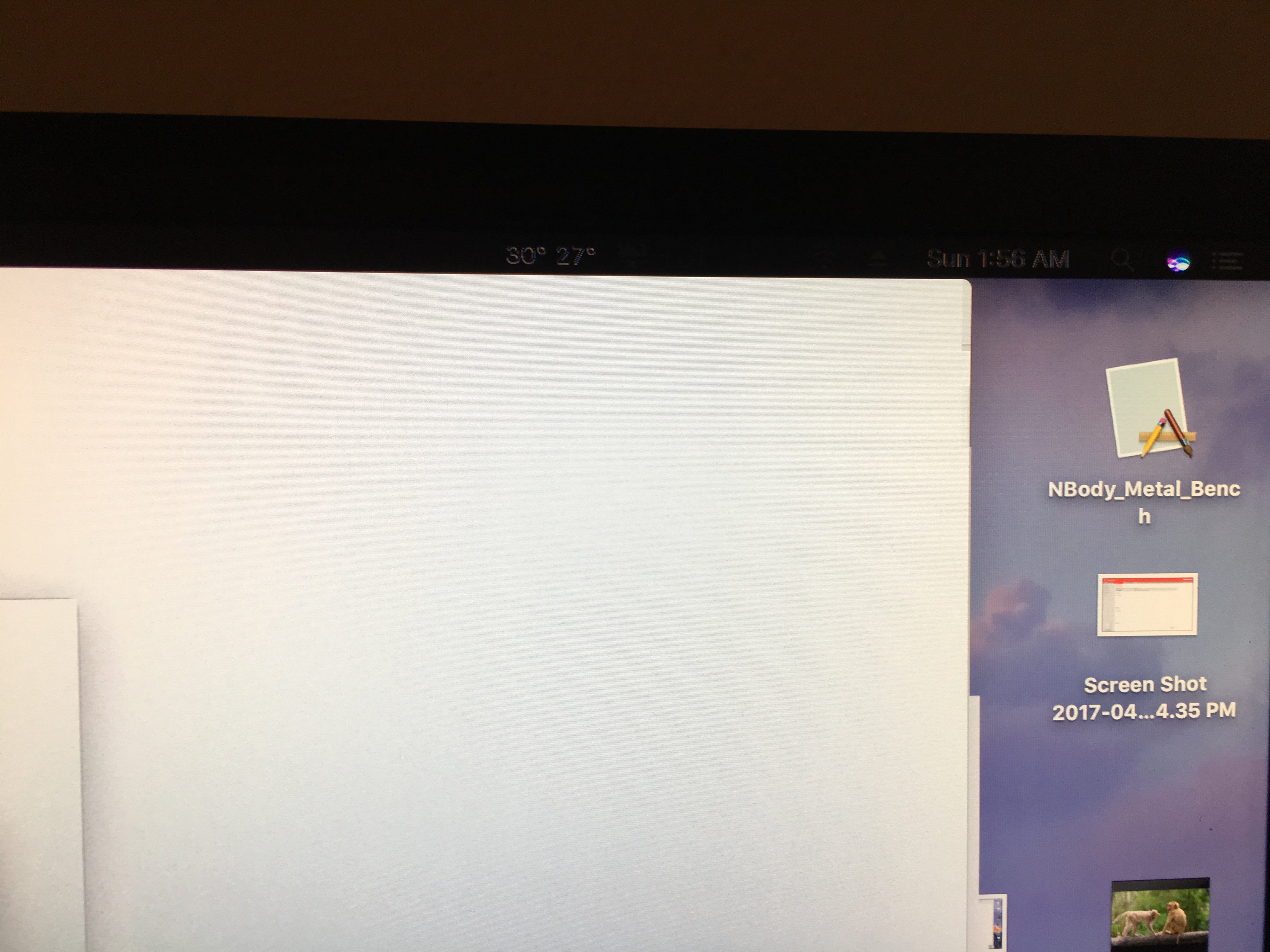

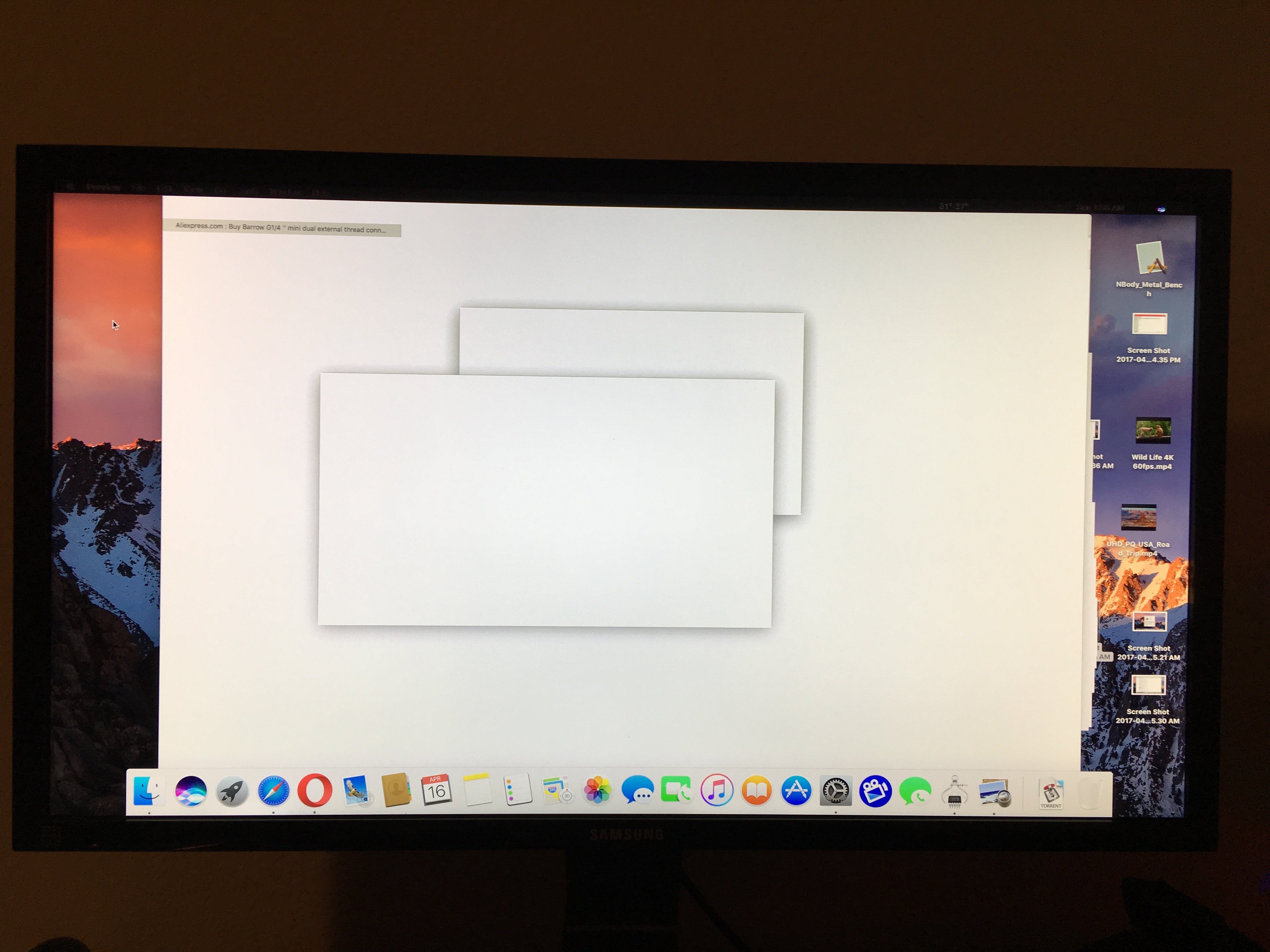

RandomTech Posted December 17, 2018 Author Share Posted December 17, 2018 (edited) Thanks for asking, as I mentioned above my Nvidia GTX 970/980Ti cards were never stable in terms of functionality from basic stuff to the most demanding, the only thing I remember that Heaven Benchmark OpenGL ran stable but still those GPUs had glitches in some games, I did game only for testing. I do really a lot of graphical testes on my system in things which I even don't use, I also wanted to know if that rumor about CUDA and Adobe was right but after my tests on Adobe Premier I saw no difference in performance between GTX 970 and GTX 980Ti or HD 7970 (anyone is free to test them of course if he got those hardware and Adobe Premier). just a small information about Adobe Premier I see a lot of Pro people on internet switching to DaVinci Resolve because it's offering more than what Adobe Premier offers. in addition to other problems mentioned above (writing for web drivers, bootflags, macOS apps won't even open, glitches and etc..) I tried to switch to AMD GPU and since then all problems are literally gone. This is an example for my Desktop on Sierra 12.6 and GTX 980Ti, stable macOS version and stable also latest Nvidia web driver and CUDA driver installed. Edited December 17, 2018 by RandomTech Link to comment Share on other sites More sharing options...
RandomTech Posted December 18, 2018 Author Share Posted December 18, 2018 I wish even myself to be wrong because I really don’t like to be limited to any brand, at least in this case I would have more selection of cards to choose from not only AMD, but trust me I did everything possible to solve those issues with GTX cards back then but had no chance. Most of time they worked fine but for no reason they gave me those kind of issues in between and for no reason, from Yosemite10.10.5 to all El Capitan versions to Sierra 10.12.3-4, then switched to AMD. I also still see in forums here and there people having different problems with Nvidia and macOS but I pass them away because are not my concern anymore. Maybe on real macs are different as I understand from your experience, in my Hackintoshes HD7970 works like a real mac card, RX 480 too, only RX Vega has fan control issue which is very easy to solve anyway and the fix was found from very early Vega days. (My own fix for that is that I have it in Waterblock, so no fans are involved there). Those open windows are System Preferences, a Finder folder and Opera, but that happened to any other app too. I will consider about what said anyway because for me it’s very good to know, please if you have any more information to add ill be glad to receive. Link to comment Share on other sites More sharing options...
