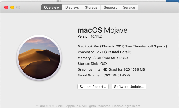

wikedone Posted December 16, 2018 Share Posted December 16, 2018 I need help with my graphics, if I boot with -lilucpu=8 I have no issues with graphics but about this Mac shows if I dont boot with -lilucpu=8 the graphics is all messed up and can't read text, I'm trying to follow the frame buffer thread but im confused what I need to do Link to comment Share on other sites More sharing options...
mnfesq Posted December 17, 2018 Share Posted December 17, 2018 20 hours ago, wikedone said: I need help with my graphics, if I boot with -lilucpu=8 I have no issues with graphics but about this Mac shows if I dont boot with -lilucpu=8 the graphics is all messed up and can't read text, I'm trying to follow the frame buffer thread but im confused what I need to do Please provide more details regarding your config. Are you using WhateverGreen? Do you have a FHD or UHD display? I use -lilubetaall because I am always testing new betas as they come out. You shouldn't need -lilucpu=8 for your kabylake processor. The About This Mac you have above shows that you are not getting QE/CI. It should show 1536MB, not 5MB. If you look in system information, it will show you that your graphics kexts are not loaded. Therefore, you need to focus on your other settings. Are you using 0x59160000 as your ig-platform-id? Are you using 0x59168086 as your device fake ID? Try those settings in your config.plist. Link to comment Share on other sites More sharing options...

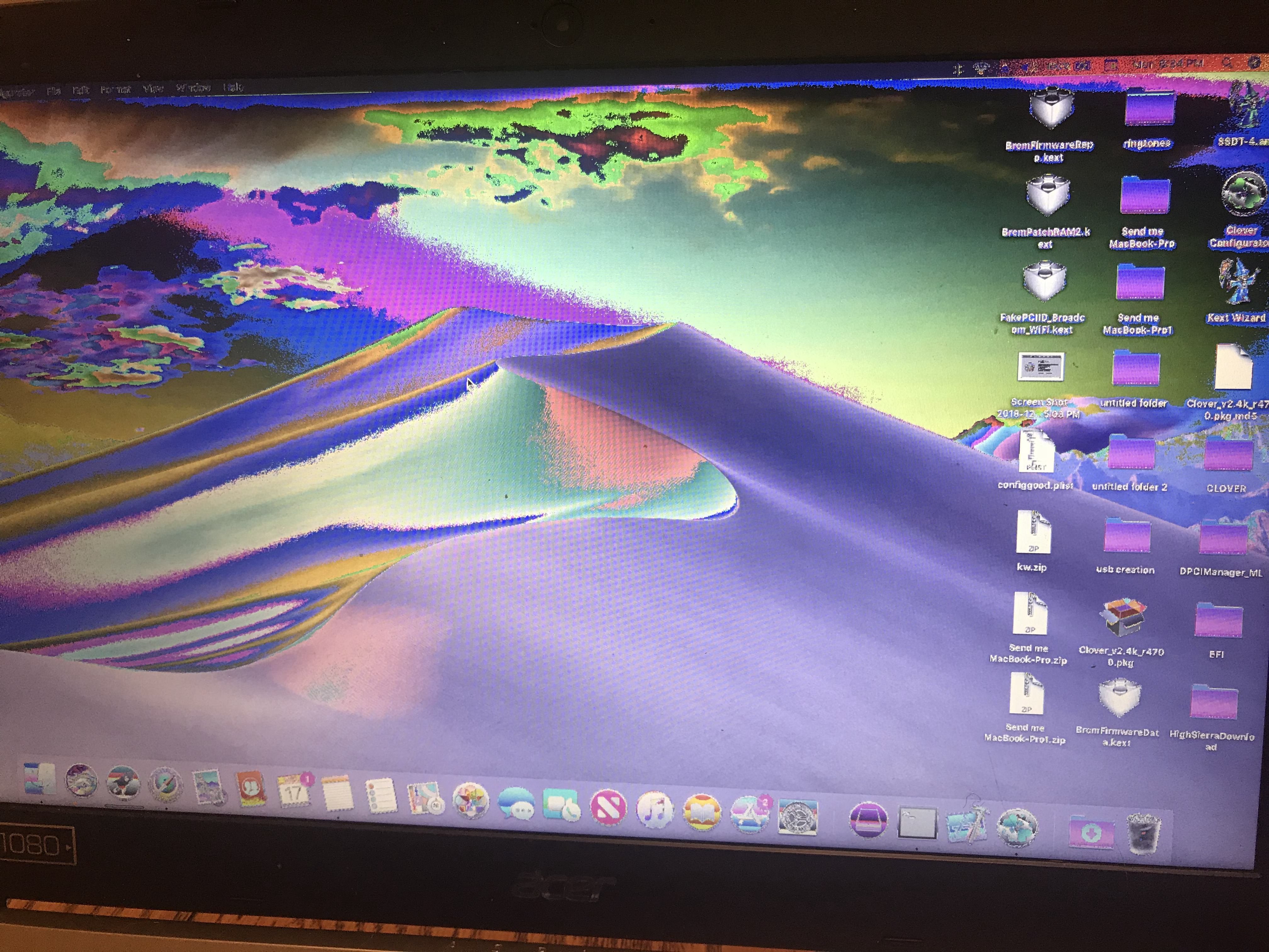

wikedone Posted December 18, 2018 Author Share Posted December 18, 2018 (edited) I am using whatevergreen kext So my display is FHD as System Information shows my ig-platform-id is set to 0x59160000 and the Devices fake id is set to 0x59168086 inject intel is checked when I boot up this is what it looks like But when I put the laptop to sleep and out of sleep the graphics is fixed and system information shows Edited December 18, 2018 by wikedone added whatever green Link to comment Share on other sites More sharing options...
mnfesq Posted December 18, 2018 Share Posted December 18, 2018 Well, it sounds like you are getting closer. After you added WhateverGreen, do you still get the incorrect colors before putting the laptop to sleep and waking it up? Does it need to be full system sleep or just video sleep? If it's just video sleep, you can set a hot corner to sleep and put it to sleep and wake it up when you boot, at least until you find a better solution. Link to comment Share on other sites More sharing options...
