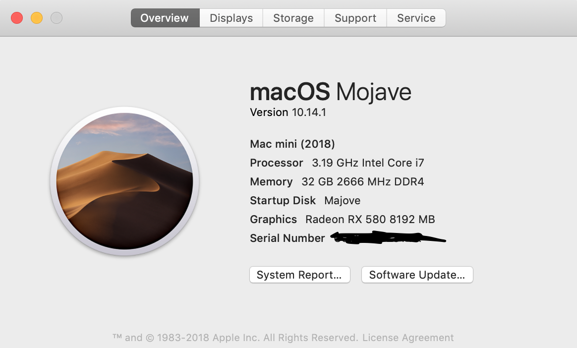

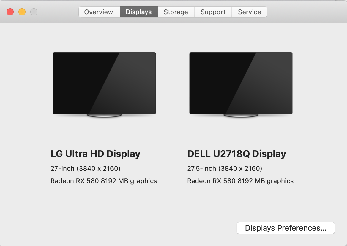

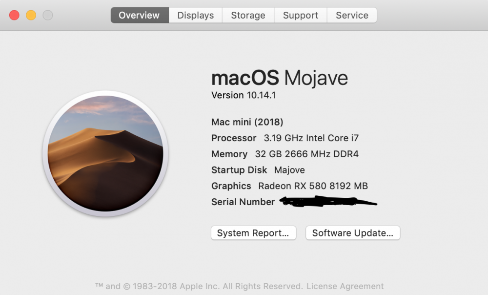

emeee Posted December 2, 2018 Share Posted December 2, 2018 (edited) This clover setting should work for recent Alienware Aurora R7 desktops (released on 2017 and 2018). It may need some minor modifications to completely fulfill your machine.The hardware details for my machine: i7-8700, Gigabyte RX 580, Adata sx8200 480g nvme ssd, DW1830 wifi+bluetooth cardWorking condition:I connect two 4k monitors to the machine both through display port on RX 580, they work good.Facetime and imessage work good.Bluetooth works good.Airdrop works good.Sleep and wake are good.Usb ports are injected through SSDT-USB.amlIntel integrated GPU UHD 630 is natively supported by Mojave when using macmini 8,1.I have no related devices, so I did not test USB-C ports and HDMI ports.Killer 1535 Wifi+bluetooth card does not work (need to be replaced).Magic mouse and Trackpad work good.Download: https://github.com/jianghaizhi/DELL-Alienware-Aurora-R7-macOSWelcome to star this Github repository There may still exist some issues in this configuration, if you have any problem or improvement, please comment below. Edited December 3, 2018 by emeee 2 Link to comment Share on other sites More sharing options...
