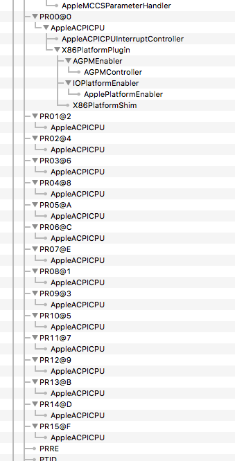

MaLd0n Posted December 3, 2018 Share Posted December 3, 2018 in ioreg appears 16 for wifi try this patch <dict> <key>Comment</key> <string>10.11-BT4LE-Handoff-Hotspot-lisai9093</string> <key>Disabled</key> <false/> <key>Find</key> <data> SIX/dEdIiwc= </data> <key>InfoPlistPatch</key> <false/> <key>Name</key> <string>IOBluetoothFamily</string> <key>Replace</key> <data> Qb4PAAAA60Q= </data> </dict> <dict> <key>Comment</key> <string>10.11-BCM94352-Airport-Extreme-skvo</string> <key>Disabled</key> <false/> <key>Find</key> <data> axAAAHUN </data> <key>InfoPlistPatch</key> <false/> <key>Name</key> <string>AirPortBrcm4360</string> <key>Replace</key> <data> axAAAJCQ </data> </dict> <dict> <key>Comment</key> <string>10.11-BCM94352-Airport-Extreme-skvo</string> <key>Disabled</key> <false/> <key>Find</key> <data> axAAAHUN </data> <key>InfoPlistPatch</key> <false/> <key>Name</key> <string>AirPortBrcm4360</string> <key>Replace</key> <data> axAAAJCQ </data> </dict> <dict> <key>Comment</key> <string>10.12-BCM94352-5GHz-US-FCC-darkvoid</string> <key>Disabled</key> <false/> <key>Find</key> <data> gflSqgAAdSk= </data> <key>InfoPlistPatch</key> <false/> <key>Name</key> <string>AirPortBrcm4360</string> <key>Replace</key> <data> gflSqgAAZpA= </data> </dict> Link to comment Share on other sites More sharing options...
djeans Posted December 3, 2018 Author Share Posted December 3, 2018 10 hours ago, MaLd0n said: in ioreg appears 16 for wifi try this patch <dict> <key>Comment</key> <string>10.11-BT4LE-Handoff-Hotspot-lisai9093</string> <key>Disabled</key> <false/> <key>Find</key> <data> SIX/dEdIiwc= </data> <key>InfoPlistPatch</key> <false/> <key>Name</key> <string>IOBluetoothFamily</string> <key>Replace</key> <data> Qb4PAAAA60Q= </data> </dict> <dict> <key>Comment</key> <string>10.11-BCM94352-Airport-Extreme-skvo</string> <key>Disabled</key> <false/> <key>Find</key> <data> axAAAHUN </data> <key>InfoPlistPatch</key> <false/> <key>Name</key> <string>AirPortBrcm4360</string> <key>Replace</key> <data> axAAAJCQ </data> </dict> <dict> <key>Comment</key> <string>10.11-BCM94352-Airport-Extreme-skvo</string> <key>Disabled</key> <false/> <key>Find</key> <data> axAAAHUN </data> <key>InfoPlistPatch</key> <false/> <key>Name</key> <string>AirPortBrcm4360</string> <key>Replace</key> <data> axAAAJCQ </data> </dict> <dict> <key>Comment</key> <string>10.12-BCM94352-5GHz-US-FCC-darkvoid</string> <key>Disabled</key> <false/> <key>Find</key> <data> gflSqgAAdSk= </data> <key>InfoPlistPatch</key> <false/> <key>Name</key> <string>AirPortBrcm4360</string> <key>Replace</key> <data> gflSqgAAZpA= </data> </dict> Weird. I was confused because the activity monitor cpu graphs only showed 12 instead of 16. I'm beginning to wonder if I have a bad wifi/bluetooth card? Bluetooth worked on my first boot, but hasn't worked since. Wifi never has. Currently, in the wifi Menu Bar area it says "Wifi:No Hardware installed" and in the bluetooth menu it says "Bluetooth: Not available." I wasn't sure if the patch goes in the "Kexts to patch" area, or the regular patches area. Tried in both - no luck with either. Link to comment Share on other sites More sharing options...
MaLd0n Posted December 3, 2018 Share Posted December 3, 2018 3 hours ago, djeans said: Weird. I was confused because the activity monitor cpu graphs only showed 12 instead of 16. I'm beginning to wonder if I have a bad wifi/bluetooth card? Bluetooth worked on my first boot, but hasn't worked since. Wifi never has. Currently, in the wifi Menu Bar area it says "Wifi:No Hardware installed" and in the bluetooth menu it says "Bluetooth: Not available." I wasn't sure if the patch goes in the "Kexts to patch" area, or the regular patches area. Tried in both - no luck with either. u use activity monitor from Apple in utilities folder? post ur config.plist here, i'll add Link to comment Share on other sites More sharing options...
