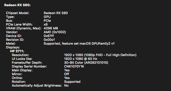

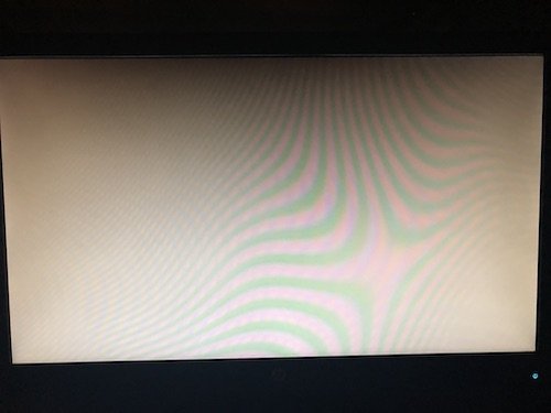

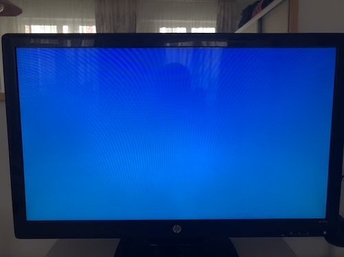

telepati Posted November 21, 2018 Share Posted November 21, 2018 (edited) I really need help 'cause I really don't know what's going on. When I am using my Hackintosh, for example, I am using for 5 days without any problem and suddenly I am losing my screen while using it and turns different colors. This is not happening all the time but suddenly screen turns full of grey and no cursor. This grey looks like apple installer background greyish. But this doesn't mean it turns each every time grey sometimes turn blue sometimes green. I really don't get it why this happening. When this happening I am making force restart from the case. This problem started after installing Mojave. I never faced of this type of screen error in High Sierra. I also tried on windows and dont get any error. I updated all kexts with the latest versions but it doesn't help. I removed all SSDT and add DSDT (which @MaLd0n created) it doesn't help either. I checked my Ioreg but doesn't seem anything wrong. Getting full acceleration from RX560. I disabled and enabled IGPU from BIOS it doesn't help either. I also tried to pull off the HDMI cable and pull back when this happening nothing changed still full grey. I attached my all files. Here is some picture of the error. A very long time I didn't get blue or green screen error but I pictured it when turned blue. Very long time didnt get blue screen. debug_1712.zip Edited November 21, 2018 by telepati Link to comment Share on other sites More sharing options...

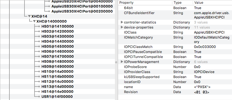

telepati Posted November 23, 2018 Author Share Posted November 23, 2018 On 11/21/2018 at 6:20 PM, MaLd0n said: use only my clover folder CLOVER.zip don't need any ssdt, u have a collection check CSM option in bios enable IntelHDGraphics in bios USB 3.0 Flash Drives doesn't work. When I connect my USB 3.0 Flash Drive to the Hack nothing happening. Just USB 2.0 working. Link to comment Share on other sites More sharing options...
MaLd0n Posted November 23, 2018 Share Posted November 23, 2018 30 minutes ago, telepati said: USB 3.0 Flash Drives doesn't work. When I connect my USB 3.0 Flash Drive to the Hack nothing happening. Just USB 2.0 working. patch don't work more, u need other way, u can check here https://olarila.com/forum/viewtopic.php?p=65287#p65287 1 Link to comment Share on other sites More sharing options...

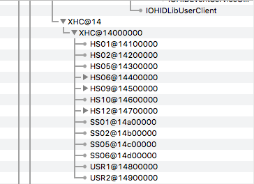

telepati Posted November 23, 2018 Author Share Posted November 23, 2018 (edited) 45 minutes ago, MaLd0n said: patch don't work more, u need other way, u can check here https://olarila.com/forum/viewtopic.php?p=65287#p65287 Thanks but problem is there is no any SSP in the ioreg I think this is DSDT related. I discovered my port before; These are all included ports. If I add these ports to the boot argument SS port will show again or? HS01 // HS Case USB3 Front Right HS02 // HS Case USB3 Front Left HS05 // HS Case USB3 Rear Middle Right HS06 // HS Case USB3 Rear Middle Left HS09 // HS Case USB2 Rear Top Right HS10 // HS Case USB2 Rear Top Left HS12 Inside Left// Bluetooth SS01 Case Front Right SS02 Case Front Left SS05 Middle Right SS06 Middle Left Edited November 23, 2018 by telepati Link to comment Share on other sites More sharing options...
MaLd0n Posted November 23, 2018 Share Posted November 23, 2018 1 hour ago, telepati said: Thanks but problem is there is no any SSP in the ioreg I think this is DSDT related. I discovered my port before; These are all included ports. If I add these ports to the boot argument SS port will show again or? HS01 // HS Case USB3 Front Right HS02 // HS Case USB3 Front Left HS05 // HS Case USB3 Rear Middle Right HS06 // HS Case USB3 Rear Middle Left HS09 // HS Case USB2 Rear Top Right HS10 // HS Case USB2 Rear Top Left HS12 Inside Left// Bluetooth SS01 Case Front Right SS02 Case Front Left SS05 Middle Right SS06 Middle Left the problem is limit, 15 ports if u exclude some HSxx, SSxx start appears 1 Link to comment Share on other sites More sharing options...
telepati Posted November 25, 2018 Author Share Posted November 25, 2018 On 11/24/2018 at 12:23 AM, MaLd0n said: the problem is limit, 15 ports if u exclude some HSxx, SSxx start appears Thank you MaLd0n after excluding unused ports all working ports came. Link to comment Share on other sites More sharing options...
