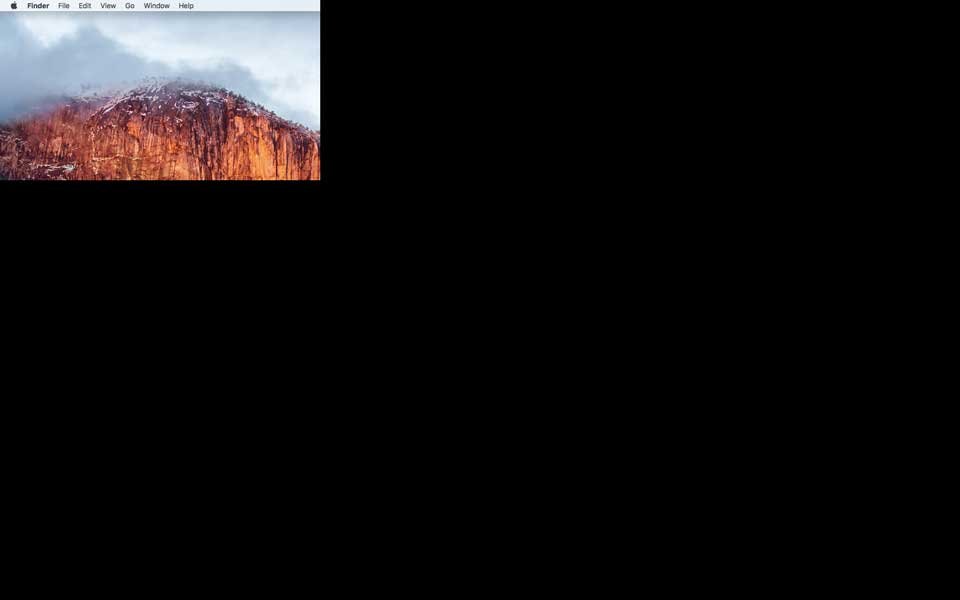

Here i have an Asus P5Q with a flashed HD6850.
It took a while to make the DSDT working looks like a real mac.
Now the *only* problem is the wake up. The bootloader is clover. With no flags for the graphx card. After sleep i get a black screen.
Tested Whatevergreen, but the result looks like the attachment. And, it is blinking. The same effect comes with the clover RadeonDeInit option.
Any ideas?
Thanks!

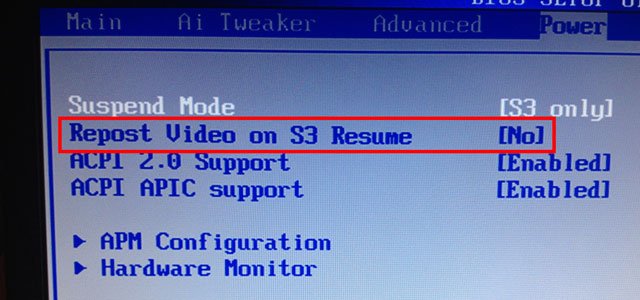

UPDATE: OMG! Okay, got it fixed. It was a wrong BIOS setting. The right flag is "No".
