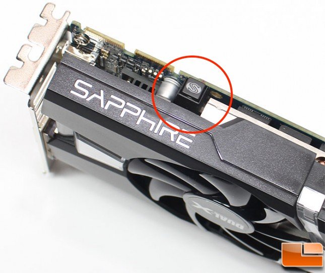

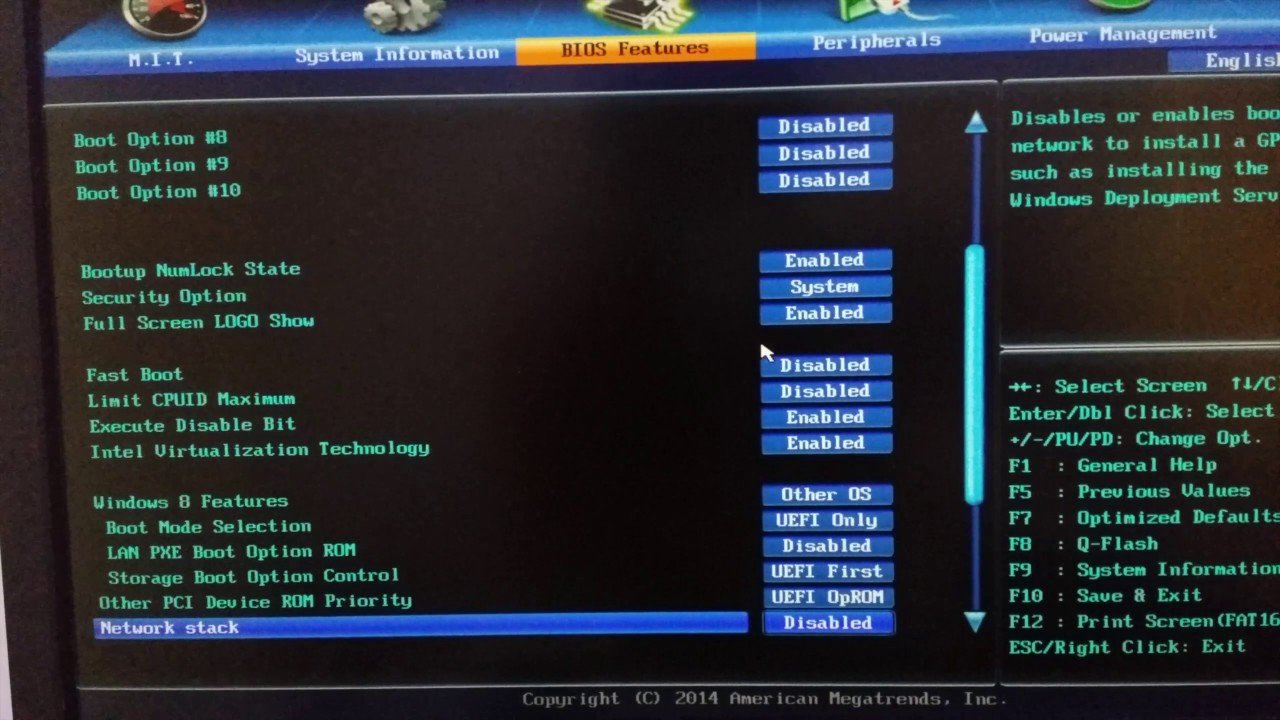

Taruga Posted November 9, 2018 Share Posted November 9, 2018 (edited) I have the same board, I don't worry about sleep now but I think I had it fixed when I used to put my system to sleep. I think I had to change in bios: OS Type to Windows 8 WHQL CMS Support to Never and press a button in my 280x GFX to switch the dual bios from normal to EFI, the button looks like this: Edited November 9, 2018 by Taruga Link to comment Share on other sites More sharing options...

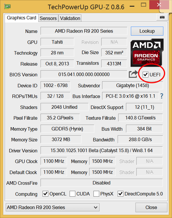

Taruga Posted November 9, 2018 Share Posted November 9, 2018 This is an example image from GPU-Z that I remember using when I was testing this issue. In my case, it did not show up the UEFI check box checked, after pressing that button on the GFX card to switch bios, then GPU-Z showed UEFI checked like in this screenshot example. Link to comment Share on other sites More sharing options...
zeuscba Posted November 9, 2018 Author Share Posted November 9, 2018 3 hours ago, MaLd0n said: idk, i just disable ur nvidia, don't work in mojave When you sat that disable my Nvidia, you mean that I need to disconnect the Video Card from motherboard? I only using the onboard video (Intel HD4000) trougth HDMI cable when testing Mojave. 26 minutes ago, Taruga said: OS Type to Windows 8 WHQL What Bios Version your have? I can't find that option Link to comment Share on other sites More sharing options...
Taruga Posted November 9, 2018 Share Posted November 9, 2018 2 minutes ago, zeuscba said: What Bios Version your have? I can't find that option I'm using F16j It's that "Windows 8 Features", change it to "Windows 8 WHQL" Then CMS will appear below, and change it to "Never" 1 Link to comment Share on other sites More sharing options...
