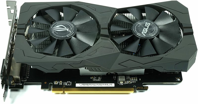

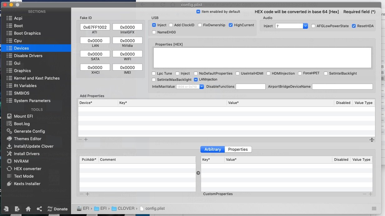

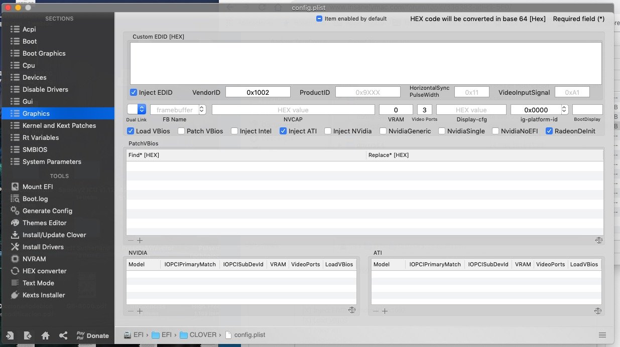

Derty Posted November 7, 2018 Share Posted November 7, 2018 (edited) Bueno, me agoté con el tema de los controladores web para nvidia y cambié a ATI, encontré una "reacondicionada" en una tienda por 150 €, que esta realmente impecable. seteo de clover: ID del dispositivo ATI - RX 560 = 0x67FF1002 [X] EDID de inyección - ID de proveedor = 0x1002 [X] Cargar VBIOS [X] inyectar ATI [X] RadeonDeInit se precisan: WhateverGreen KEXT Lilu Kext WhateverGreen.kext.zip Lilu.kext.zip Edited November 7, 2018 by Derty 1 Link to comment https://www.insanelymac.com/forum/topic/336383-ati-rx-560/ Share on other sites More sharing options...

Derty Posted November 7, 2018 Author Share Posted November 7, 2018 Set in clover: In Devices: Device ID ATI - RX 560 - 0x67FF1002 In graphics: Select: [X] Inject EDID - Vendor ID 0x1002 [X] Load VBIOS [X] Inject ATI [X] RadeonDeInit Install: Lilu & WhateverGreen - EFI/EFI/CLOVER/KEXTS/Other Link to comment https://www.insanelymac.com/forum/topic/336383-ati-rx-560/#findComment-2646126 Share on other sites More sharing options...
Andres ZeroCross Posted November 7, 2018 Share Posted November 7, 2018 Set in clover: In Devices: Device ID ATI - RX 560 - 0x67FF1002 In graphics: Select: [X] Inject EDID - Vendor ID 0x1002 [X] Load VBIOS [X] Inject ATI [X] RadeonDeInit Install: Lilu & WhateverGreen - EFI/EFI/CLOVER/KEXTS/OtherWhy should you use fakeid of ati??? Rx560 is support natively at high sierra and mojaveSent from my Mi Note 2 using Tapatalk Link to comment https://www.insanelymac.com/forum/topic/336383-ati-rx-560/#findComment-2646127 Share on other sites More sharing options...
