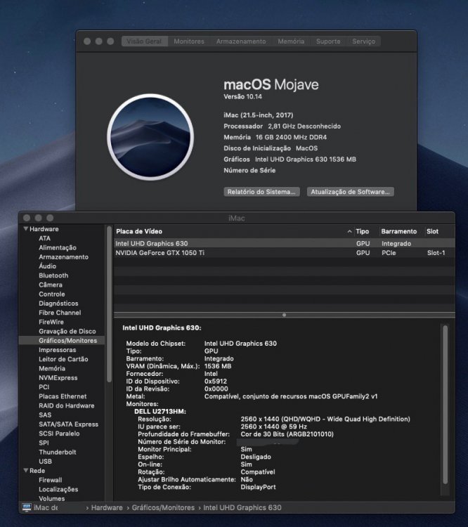

Sphinx777 Posted October 8, 2018 Share Posted October 8, 2018 (edited) I would like to share my experience installing Mojave on my PC - for those who are not getting full acceleration on IGFX and Nvidiacard together. After more than 5 days trying to get Clover to recognize my CoffeLake Processor using their ig-platformIDs I realized that it would be impossible. So I´m posting both EFI folders here (USB Installer and Pos-installation). I´ve used Clover 4674. 1. USB Installer - No configuration in ACPI - Boot - just using -v dart=0 nv_disable=1 - Devices - must use Fake IntelGFX (0x12345678) - Graphics - use Inject Intel - Kernel and Kext Patches - just two patches (AppleACPIPort and AppleUSBXHCI) - RTVariables - use CsrActiveConfig 0x3 - SMBIOS iMac 14,2 - ACPI Folder - no files inside Origin and Patched (always Kernel Panic) 2. Pos-Installation - Use last Nvidia Quadro driver from High Sierra (387.10.10.10.40.105 - working well in Mojave) - https://www.nvidia.com/download/driverResults.aspx/136062/en-us - Kexts (last version): AppleALC, AppleIntelKBLGraphicsFramebufferInjector_3e9x.kext (thanks to Rehabman), BroadcomWifiInjector, FakePCII_Broadcom_Wifi, FakePCIID, FakeSMC, Lilu, USBInjectAll, WhateverGreen and XHCI-300-Series-injector - Bluetooth kexts must be in System/Library/Extensions (BrcmFirmwareData, BrcmFirmwareRepo, BcmNonPatchRAM2 and BcmPatchRAM2) - Just two patches in Clover ACPI - HDAS to HDEF and HECI to IMEI Fix Shutdown - You should use F4 and create original files to Clover ACPI/Origin folder - Important: you must use in Boot - -disablegfxfirmware and dart=0 Devices/IntelGFX = 0x59128086 Graphics/IgPlatformID = 0x59120000 Use Inject Intel SMBIOS = iMac18,1 Here are all EFI folders to demonstrate how to fill both clover.plist. Sorry for my horrible English. Post-Folder are here (34mb) - https://drive.google.com/file/d/1xoxwDSz4QzM91KmdOzMhaW7Gnz1sRnEc/view?usp=sharing USB Installer at the end of this topic. EFI_USB.zip Edited October 8, 2018 by Sphinx777 Link to comment https://www.insanelymac.com/forum/topic/335880-guide-mojave-on-z370n-wifi-uhd-630-gtx-1050-ti/ Share on other sites More sharing options...
HPB25 Posted November 29, 2018 Share Posted November 29, 2018 Sphinx777 Thank you very much, endlich läuft Intel UHD630, nach vielen Fehlschlägen, mit deiner Anleitung und deinen kext's! GA Z370N i5-8700K Link to comment https://www.insanelymac.com/forum/topic/335880-guide-mojave-on-z370n-wifi-uhd-630-gtx-1050-ti/#findComment-2650507 Share on other sites More sharing options...
