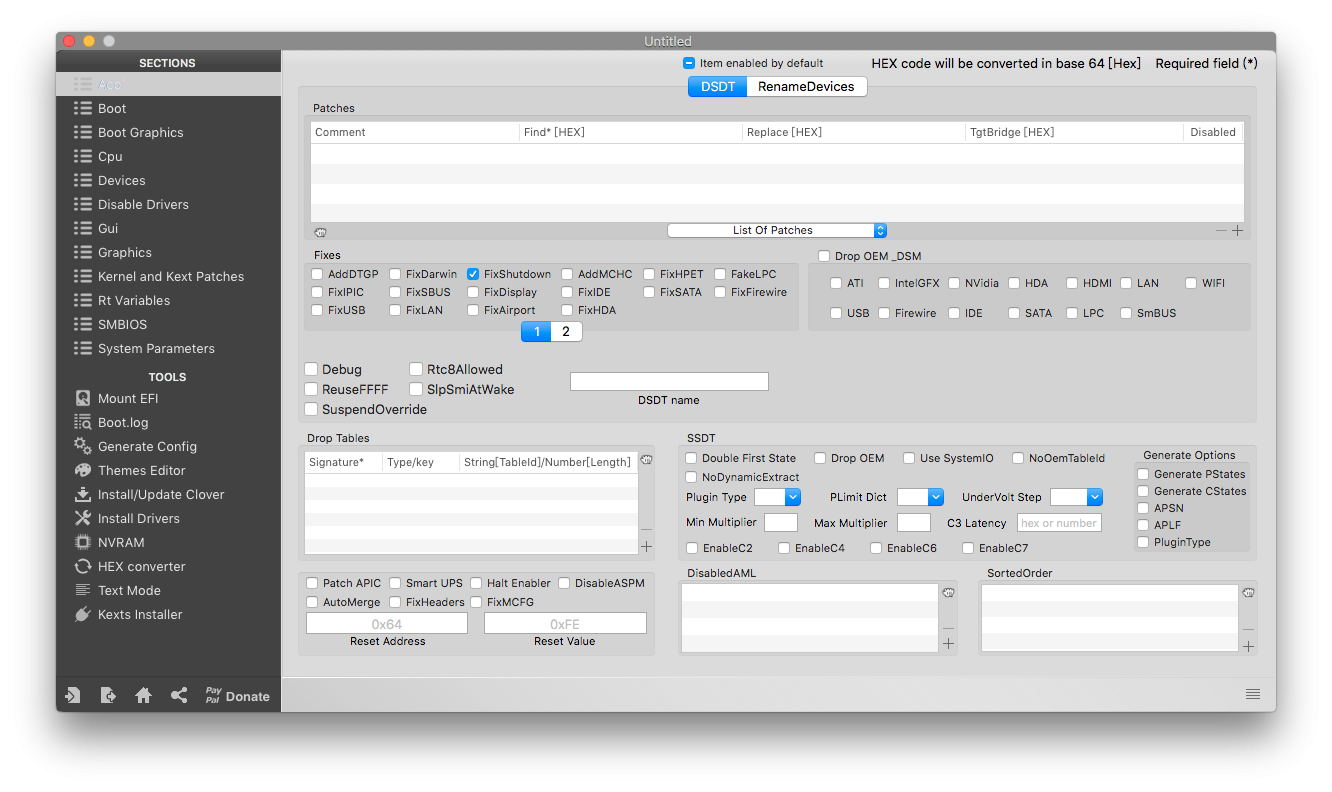

ZHLI Posted September 24, 2018 Share Posted September 24, 2018 (edited) CPU:i3 7100 主板:B250ET2 显卡:HD630 操作系统版本:10.13.6 我试过在三叶草中选择fixshutdown,DSDT命中关机关机补丁。但是,它没有效果 dsdt.aml Edited September 24, 2018 by ZHLI added attached Link to comment Share on other sites More sharing options...

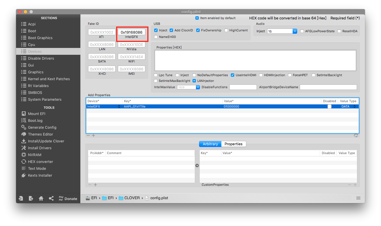

foskvs Posted September 25, 2018 Share Posted September 25, 2018 ACPI patching is wrong: 1) SSDT-IGPU injects layout-id on Device IGPU, but your HD 630 is named GFX0 in OEM tables. Remove it. 2) ig-platform-id in config.plist is good for SkyLake mobile, not KabyLake desktop. Use 59120000 instead. 3) SMBIOS: use iMac18,1 or iMac18,2 3) config.plist -> Kernel and Kext Patches 4) Why are you using fake ids to fake it like a Skylake CPU/GPU? As of 10.13.6 there's full support for Kaby Lake CPUs/GPUs DSDT.aml.zip Link to comment Share on other sites More sharing options...
ZHLI Posted September 25, 2018 Author Share Posted September 25, 2018 (edited) 12 hours ago, foskvs said: ACPI patching is wrong: 1) SSDT-IGPU injects layout-id on Device IGPU, but your HD 630 is named GFX0 in OEM tables. Remove it. 2) ig-platform-id in config.plist is good for SkyLake mobile, not KabyLake desktop. Use 59120000 instead. 3) SMBIOS: use iMac18,1 or iMac18,2 3) config.plist -> Kernel and Kext Patches 4) Why are you using fake ids to fake it like a Skylake CPU/GPU? As of 10.13.6 there's full support for Kaby Lake CPUs/GPUs DSDT.aml.zip I searched on internet Find that one person use same CPU or Mainboard,So I using fake id like a Skylake CPU/GPU I changed ig-platform-id=0x59120000,SMIBIOS,Kernel and Kext Patches, And how remove ssdt-igpu injects ? SMBIOS 18,1 18,2 The HD630 always 7M Edited September 26, 2018 by ZHLI added attached Link to comment Share on other sites More sharing options...

foskvs Posted September 27, 2018 Share Posted September 27, 2018 No ioreg attached... 0x19120000 is a platform-id used for Skylake graphics. Read here: https://en.wikipedia.org/wiki/Skylake_(microarchitecture) and here: https://en.wikipedia.org/wiki/Kaby_Lake As you can easily see, 7100 is a Kaby Lake processor. They are fully supported Out Of the Box, so there is no need to fake their ids. Shutdown problems might also be related to incorrect power management. Hard to say without an ioreg. Link to comment Share on other sites More sharing options...
LockDown Posted September 27, 2018 Share Posted September 27, 2018 Might be your cpu temp? Link to comment Share on other sites More sharing options...
ZHLI Posted September 27, 2018 Author Share Posted September 27, 2018 48 minutes ago, foskvs said: No ioreg attached... 0x19120000 is a platform-id used for Skylake graphics. Read here: https://en.wikipedia.org/wiki/Skylake_(microarchitecture) and here: https://en.wikipedia.org/wiki/Kaby_Lake As you can easily see, 7100 is a Kaby Lake processor. They are fully supported Out Of the Box, so there is no need to fake their ids. Shutdown problems might also be related to incorrect power management. Hard to say without an ioreg. Remove ig platform id, Then ? Uploaded IOReg attached IOReg.zip Link to comment Share on other sites More sharing options...
foskvs Posted September 27, 2018 Share Posted September 27, 2018 2 minutes ago, ZHLI said: Remove ig platform id, Then ? Inject ig-platform-id = 0x59120000 Remove any fake-id from Devices section. Your IGPU is detected as HD 520 (8086-1916), thus loading Skylake framebuffer rather than KBLFramebuffer. Link to comment Share on other sites More sharing options...
ZHLI Posted September 27, 2018 Author Share Posted September 27, 2018 4 minutes ago, foskvs said: Inject ig-platform-id = 0x59120000 Remove any fake-id from Devices section. Your IGPU is detected as HD 520 (8086-1916), thus loading Skylake framebuffer rather than KBLFramebuffer. Remove it ? Link to comment Share on other sites More sharing options...
foskvs Posted September 27, 2018 Share Posted September 27, 2018 Yes Link to comment Share on other sites More sharing options...
ZHLI Posted September 27, 2018 Author Share Posted September 27, 2018 4 minutes ago, foskvs said: Yes You are right .The HD 630 Display memory is normal. Next Help me to Solved the power off and automatically after a few mintues Link to comment Share on other sites More sharing options...
foskvs Posted September 27, 2018 Share Posted September 27, 2018 Place the DSDT attached here in EFI/CLOVER/ACPI/patched, boot in verbose mode, log in and then shut down the computer. Does the problem still persist? Any error message on the display? Link to comment Share on other sites More sharing options...
ZHLI Posted September 27, 2018 Author Share Posted September 27, 2018 19 minutes ago, foskvs said: Place the DSDT attached here in EFI/CLOVER/ACPI/patched, boot in verbose mode, log in and then shut down the computer. Does the problem still persist? Any error message on the display? After clicking Shutdown, the display is black, is not powered off. Link to comment Share on other sites More sharing options...
foskvs Posted September 27, 2018 Share Posted September 27, 2018 53 minutes ago, ZHLI said: After clicking Shutdown, the display is black, is not powered off. Remove the DSDT and try FixShutdown patch in config.plist Retry. Same issue? Link to comment Share on other sites More sharing options...
ZHLI Posted September 28, 2018 Author Share Posted September 28, 2018 14 hours ago, foskvs said: Remove the DSDT and try FixShutdown patch in config.plist Retry. Same issue? The First time power off,Display turn offed But the Host Desktop Keep on,Tried again turn offed Normal. Thank you for your help. Can you explaning the reason? Link to comment Share on other sites More sharing options...
foskvs Posted September 28, 2018 Share Posted September 28, 2018 2 hours ago, ZHLI said: The First time power off,Display turn offed But the Host Desktop Keep on,Tried again turn offed Normal. Thank you for your help. Can you explaning the reason? Golden rule for hackintosh. One fix at a time. Link to comment Share on other sites More sharing options...
