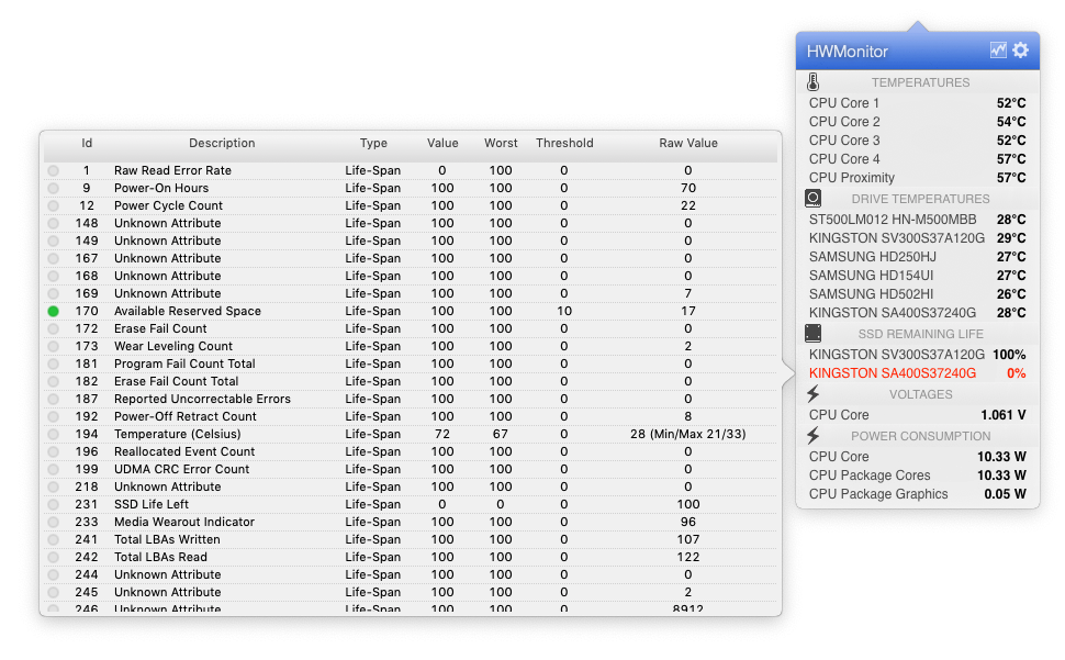

As I was making "clean" installations of all OSs I use and, macOS were the only installed OS when I plugged it, the fact that HWMonitor showed me a warning about its SMART status caught my attention but, as I just started to use VirtualSMC and, I thought that it may be some other issue...

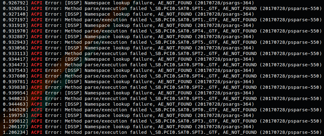

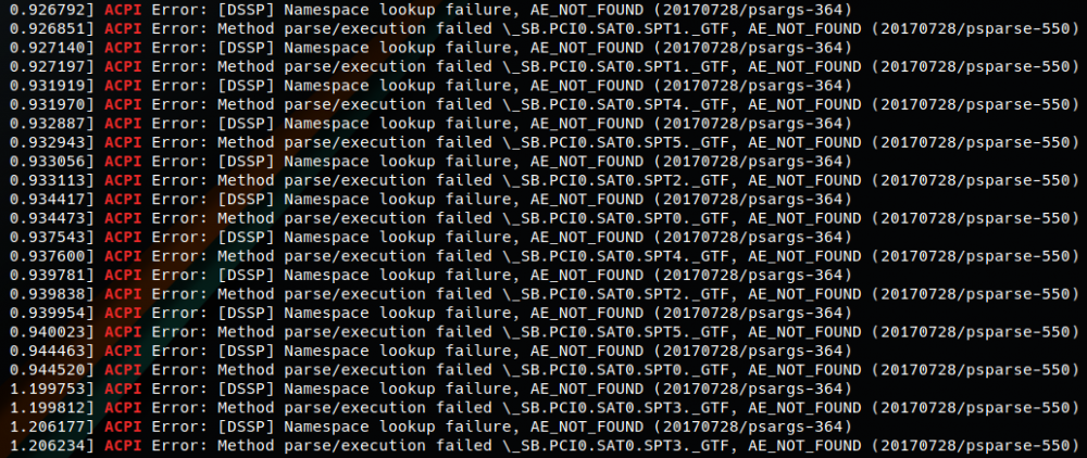

But, after finish, I noticed some ACPI errors at Linux boot...

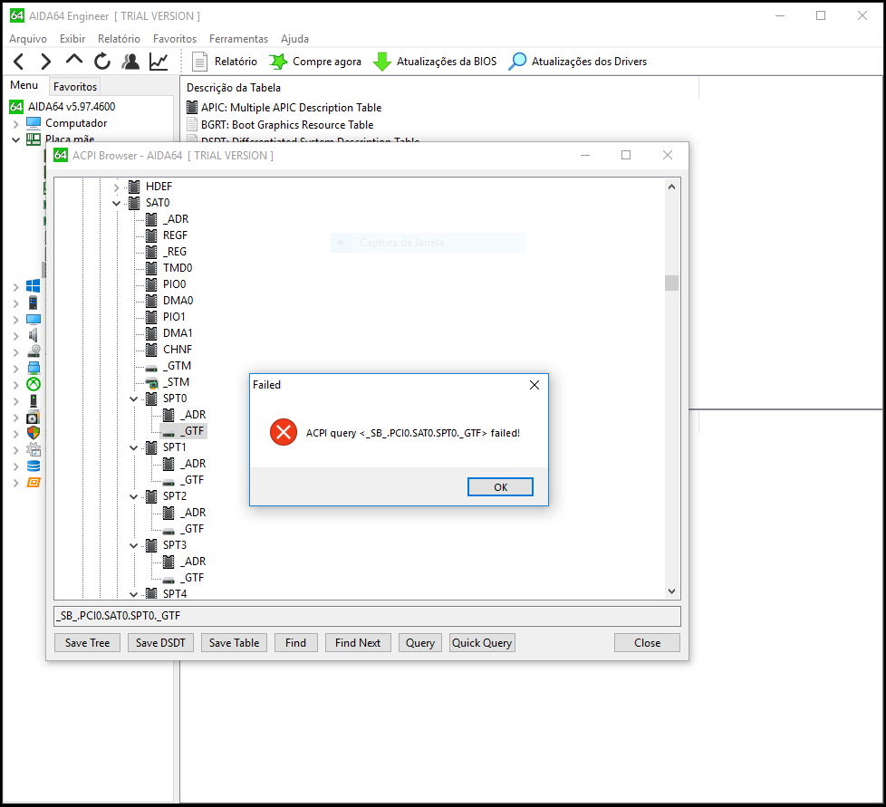

2018-09-15 23:03:47.737322-0300 0x71 Default 0x0 0 0 kernel: (AppleACPIPlatform) ACPI Error:
2018-09-15 23:03:47.737323-0300 0x71 Default 0x0 0 0 kernel: (AppleACPIPlatform) ACPI Error:
2018-09-15 23:03:47.737325-0300 0x71 Default 0x0 0 0 kernel: (AppleACPIPlatform) 1 table load failures, 5 successful
2018-09-15 23:03:47.737326-0300 0x71 Default 0x0 0 0 kernel: (AppleACPIPlatform) 1 table load failures, 5 successful

They are related to "Method (_GTF, 0, NotSerialized)"  and, looking at ACPI specs, apparently it's properly applied at the SSDT... > SSDT1.dsl.zip
My question is, where I have an issue?

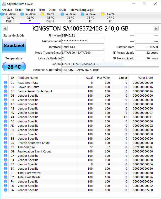

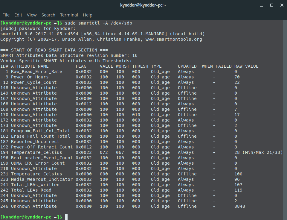

SMART information isn't clear at Linux, Windows or macOS...
At CrystalDiskInfo I have the more "friendly" info, and also, it shows SATA ACS-3 Revision 4 standard, my old SSD, from where I can get detailed SMART information, is from Revision 3...

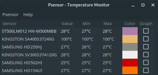

Sensors are crazy at Linux too...
