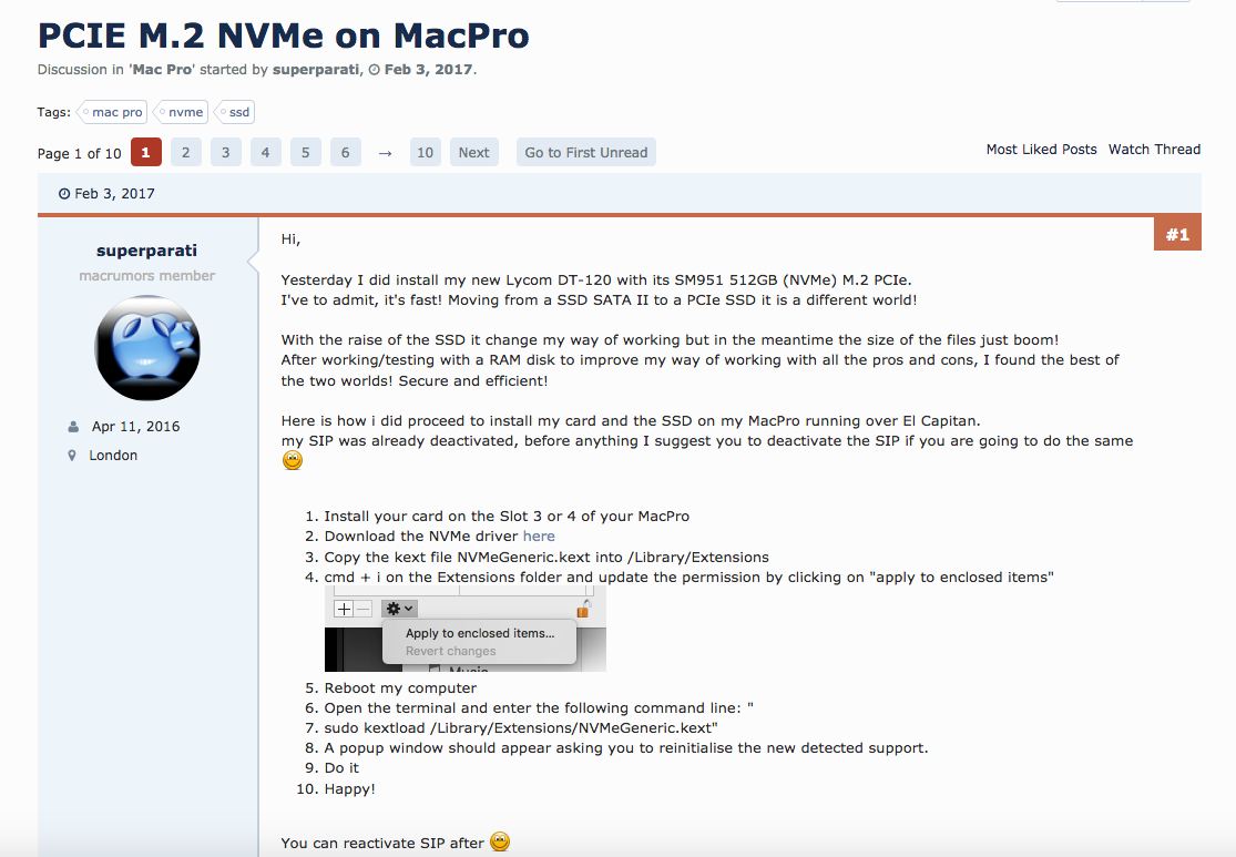

Catsolo Posted August 22, 2018 Share Posted August 22, 2018 Hi, I'm new to the forum. I have a 2010 Mac Pro 12 core which I am trying to keep valid and alive by installing a Samsung 512 GB 960 evo M.2 card connected to a Glotrends M.2 PCIe Nvme or PCIe AHCI SSD to PCIe 3.0 x and M.2 SATA SSD to SATA III Adapter Card. I want to make this SSD my bootable drive. I've tried following the instructions here https://forums.macrumors.com/threads/pcie-m-2-nvme-on-macpro.2030791/ but I get a CPU kernel crash and reboot message when I try to run the program sudo kextload /Library/Extensions/NVMeGeneric.kext" A popup window should appear asking you to reinitialise the new detected support. My full Specs are: OSX High Sierra 10.13.4 ATI Radeon HD 5870 1024 MB now (but moving to a Radeon RX580 8 GB card) 64 GB 1333 MHz DDR3 2 x 3,46 GHz 6-Core Intel Xeon The drive can be seen by my system as an ejectable drive but I can's set it up as a bootable drive. Can someone tell me how I can do this? Any help will be gratefully received. Best regards Catsolo Link to comment Share on other sites More sharing options...
