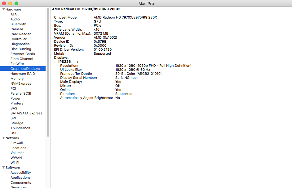

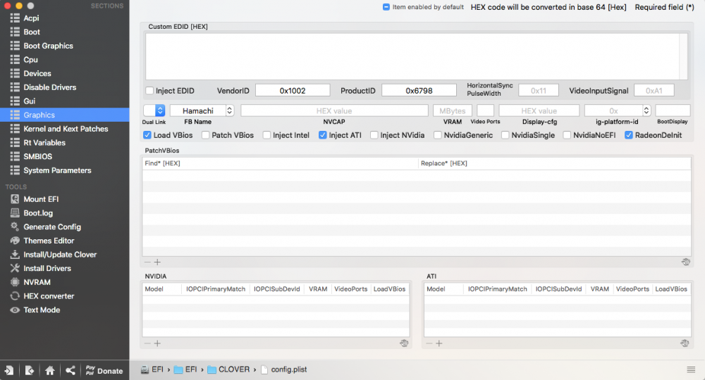

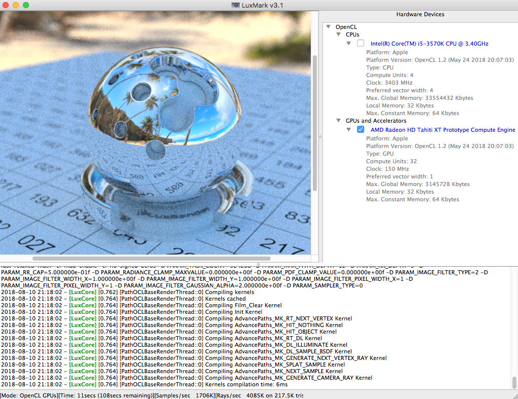

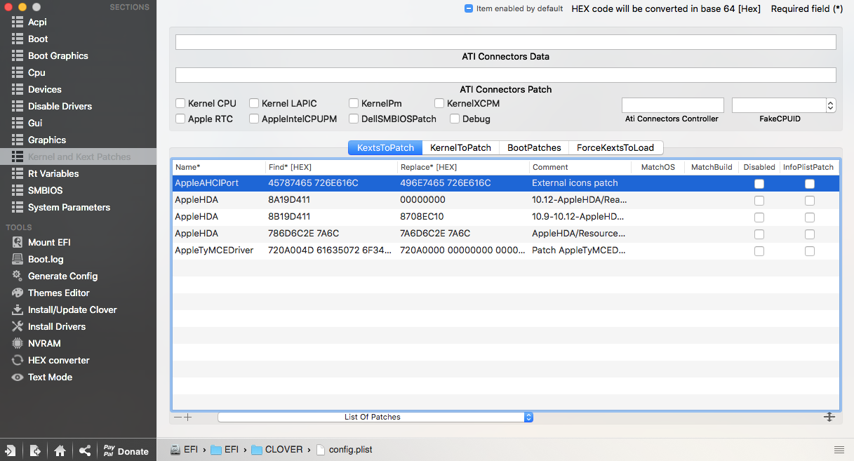

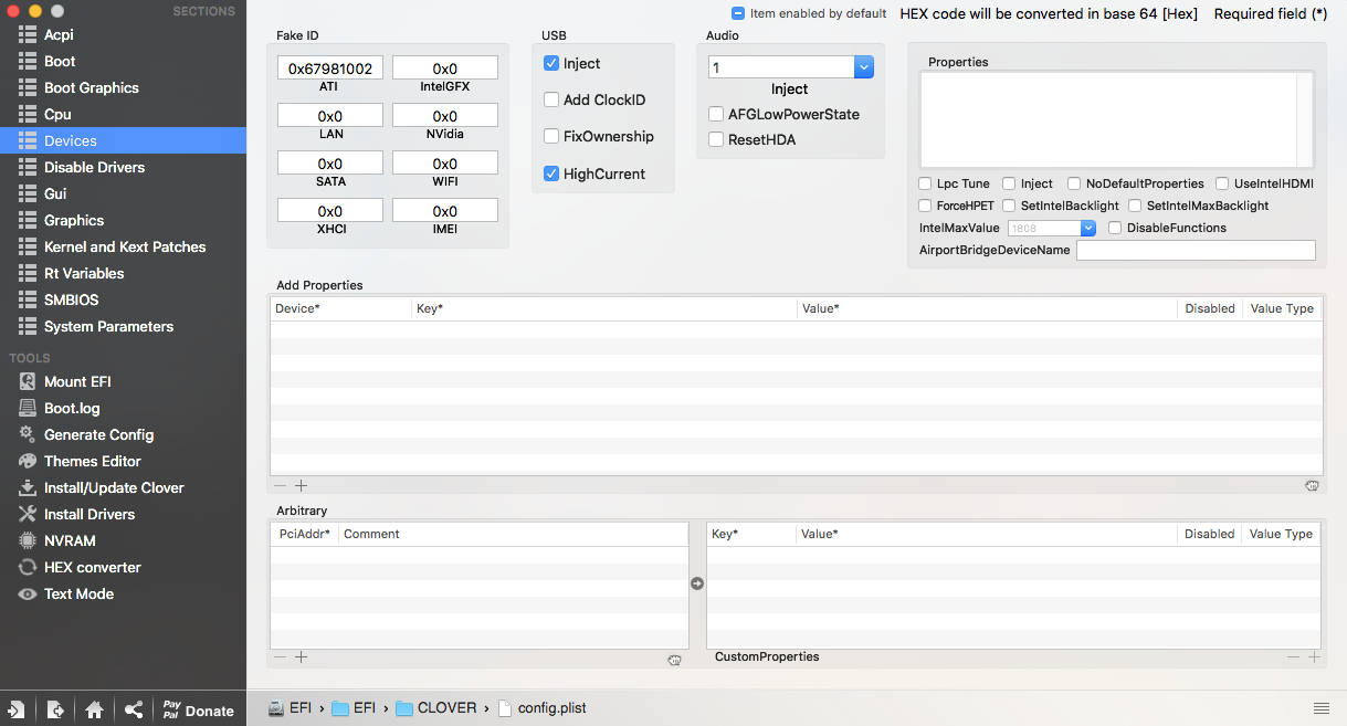

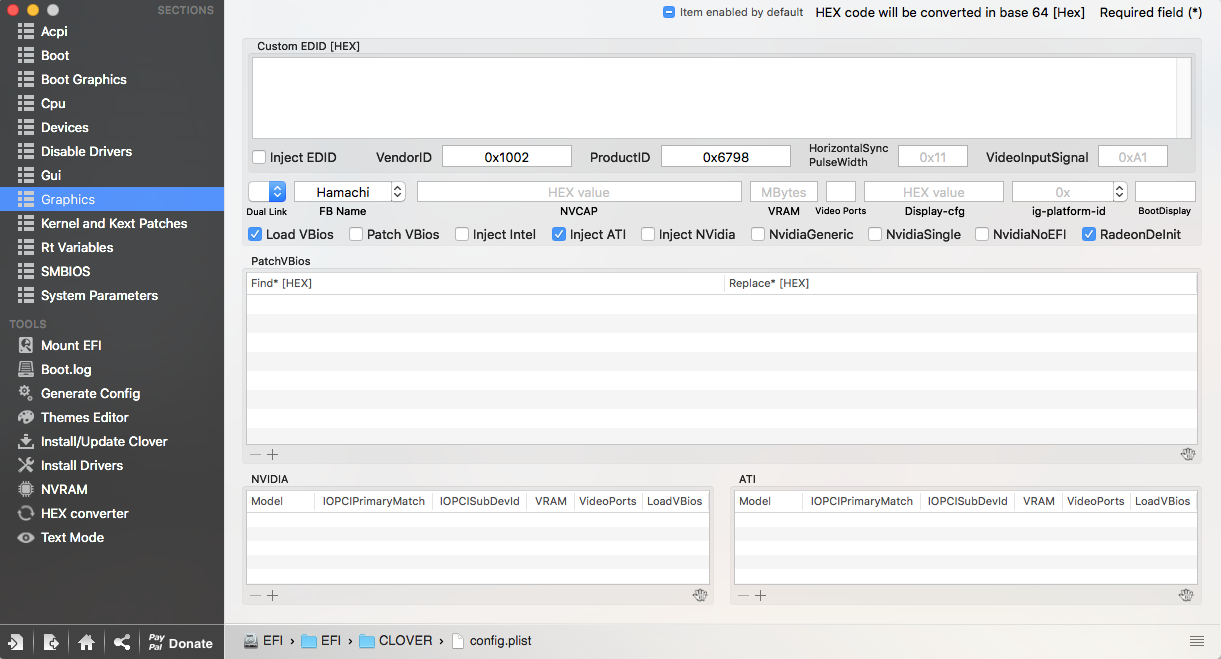

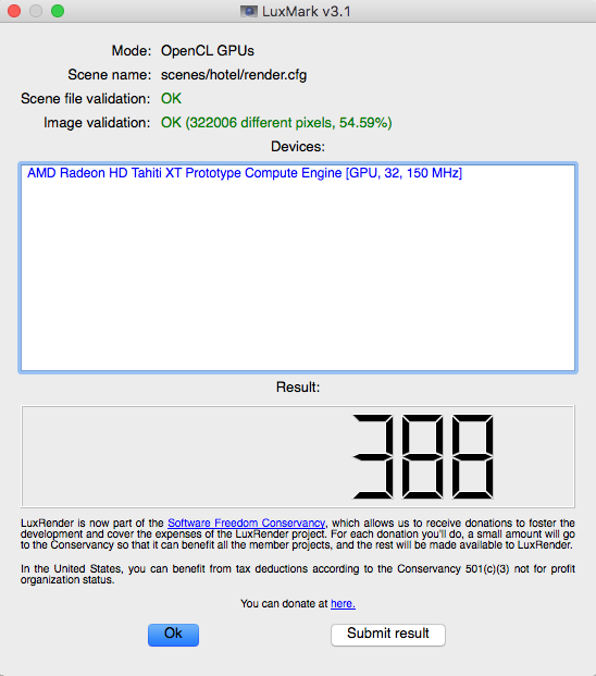

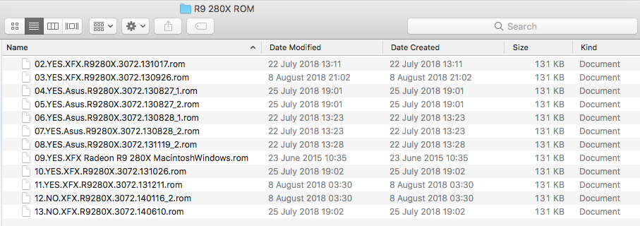

p.sudo Posted August 11, 2018 Share Posted August 11, 2018 Z77-DS3H rev. 1.1 i5 3570K XFX 280X DD MacPro5,1 or iMac13,2 BIOS: IGPU disabled/there is no VT-D for this MOBO What I've done so far: - Managed to make the XFX 280X DD work and tested several ROMs from Asus and XFX - The ROMs that worked, they all show that it's running @150MHz I've saw one person that used MacPro5,1 and deleted AppleTYuMCE.kext and then he was able to get proper Luxmark results. I did basically the same, but instead of deleting it, I tried by disabling it on Clover even used the same ROM, nothing changed. I've read about someone that tried some specific ROM and I've already tried that too, still stuck @150MHz. Thanks! Link to comment https://www.insanelymac.com/forum/topic/335147-help-xfx-280x-dd-stuck-150mhz-z77-d3h-rev-11-i5-3570k/ Share on other sites More sharing options...
