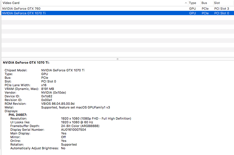

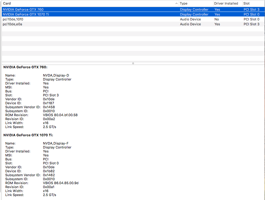

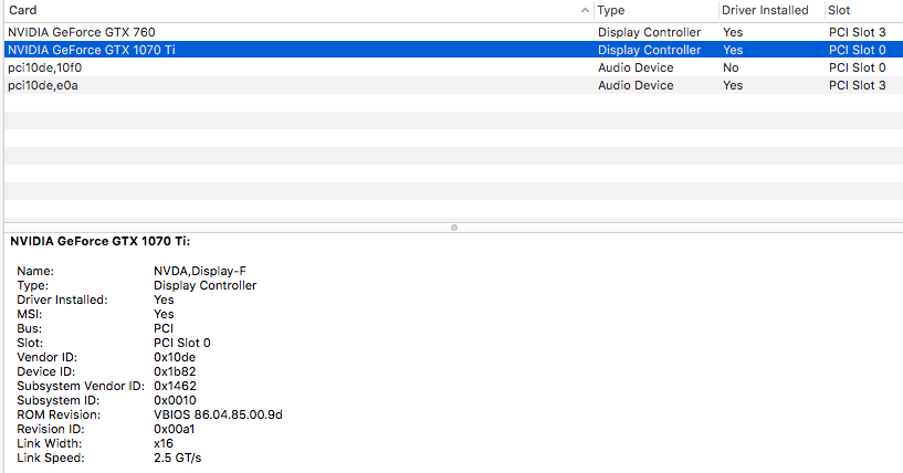

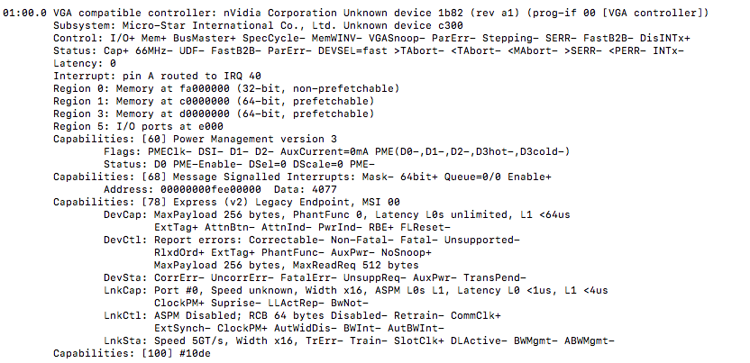

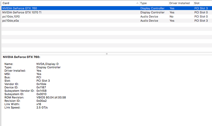

Just noticed that my GPU link speed is 2.5GT/s on PCI-e 16X which it supposed to be 8GT/s!
I installed second GPU all was recognize with no issues but both card had the same link speed...`I removed one card the speed stay the same.

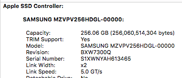

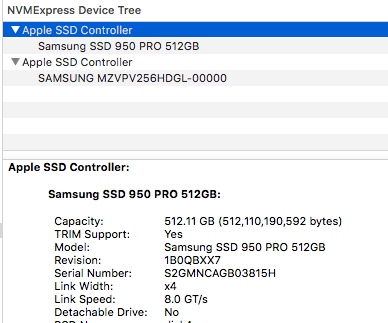

I have installed NVME SSD on my 3rd PCI-e and it gave me the correct link speed of 8GT/s on X4 PCI-e...
this is really strange...is that BIOS settings or OS ?

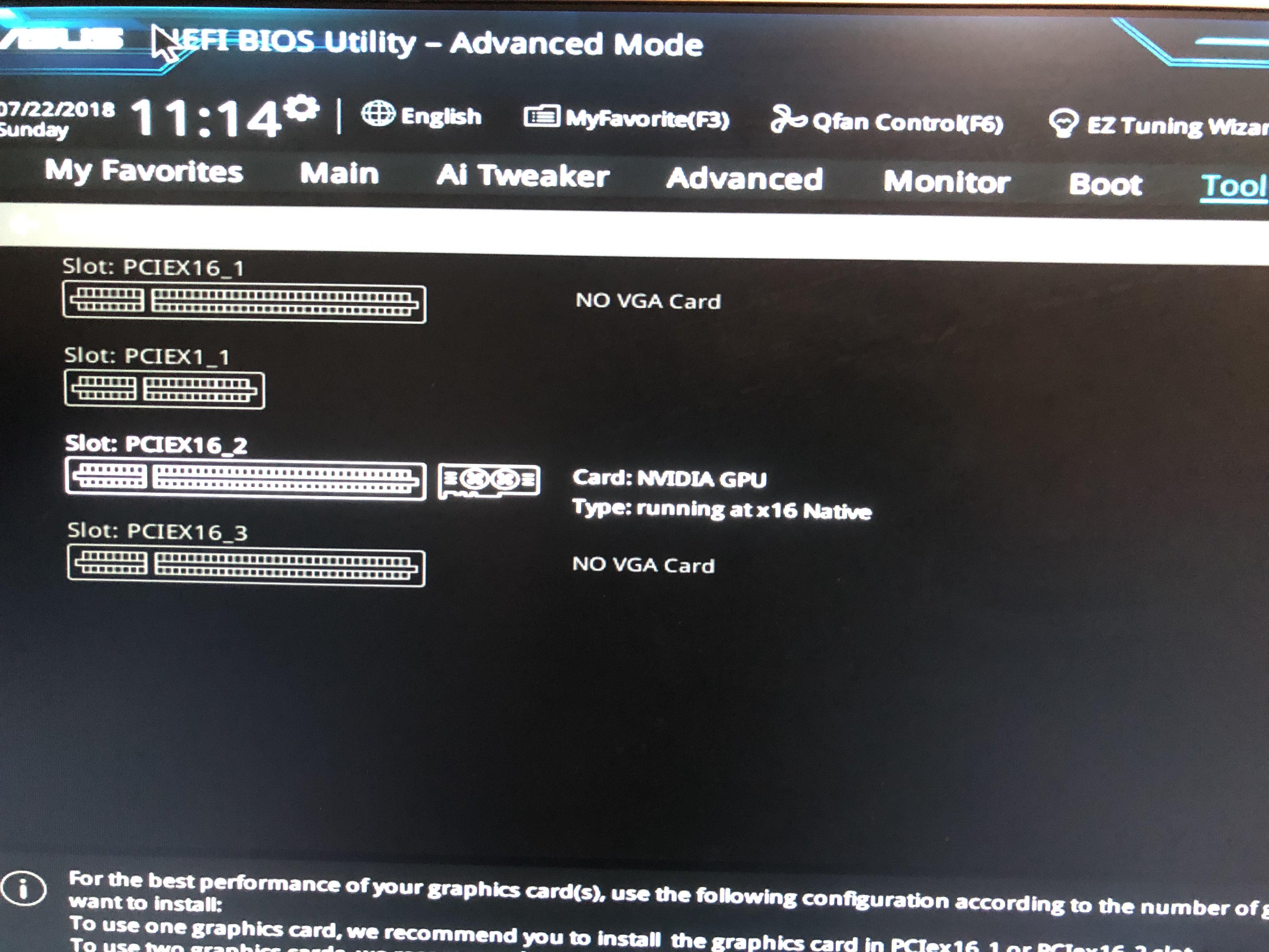

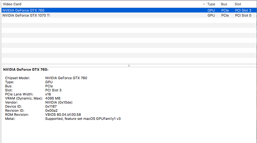

Also when installing 2 GPU in BIOS the MB shows me only one as you can see in the attached picture...I'm confused...

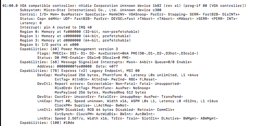

Fast update,
I read that PCI link speed is dynamic so it will update when GPU is in load (running game or others), so I run some encoding and after that I ran LSPCI and the link speed is now 5GT/s ...is that mean I'm all good?
Why I cannot see 8GT/s?
why the NVME always show 8GT/s?
