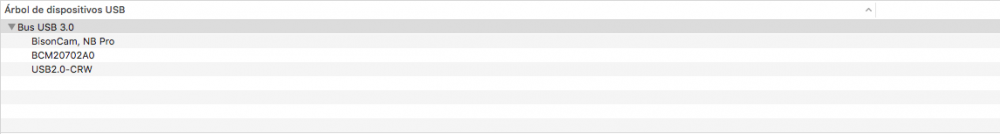

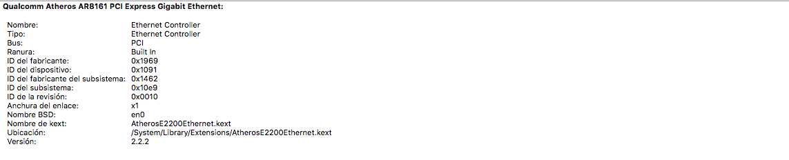

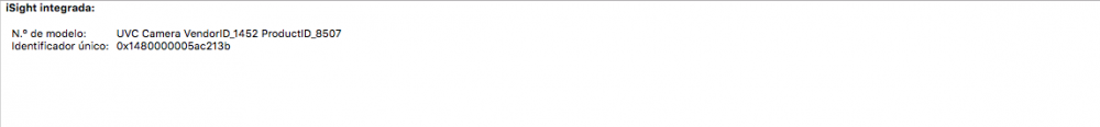

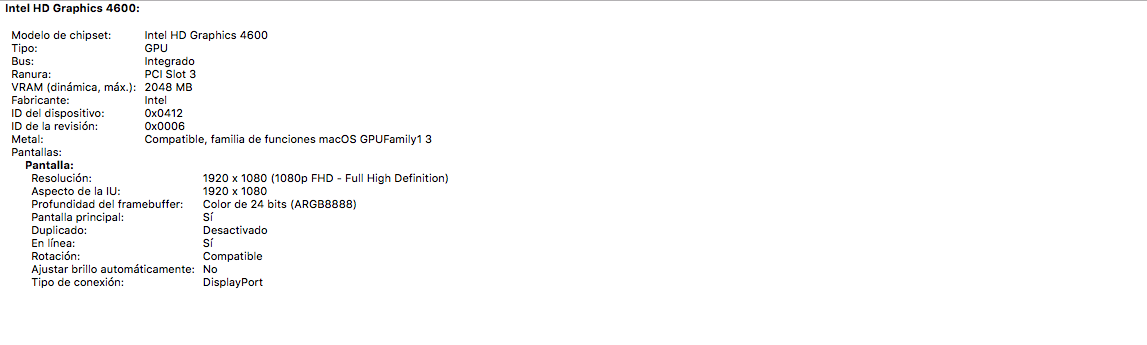

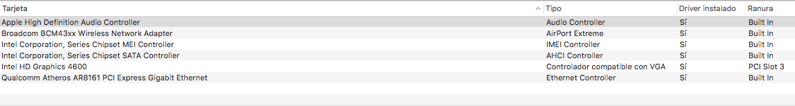

kali2000 Posted June 14, 2018 Share Posted June 14, 2018 (edited) GUIDE FOR MSI CX61 2PC Hi my friends… This is a complete guide for MSI CX61 2PC. Tested on 10.13.5 System features: Ø CPU: 4th generation Intel® Core™ i7-4712MQ Processor Ø RAM: 16GB DDR3 1600MHz Ø SATA: Intel(R) 8 Series Chipset Family SATA AHCI Controller Ø Graphics: Intel HD 4600 up patch to 2048MB Ø Optimus: nVidia GeForce 820M; disabled by DSDT Ø Audio: Realtek ALC269 Ø HDMI: Audio & video Ø LCD: 15.6" HD (1366x768) / FHD(1920x1080) LED backlight Ø Lan: Qualcomm Atheros AR8161 PCI-E Gigabit Ethernet Controller Ø WiFi & Bluetooth: replaced with compatible device... I use Broadcom BCM4352 Azurewave AW-CE123H WiFi + BT 867Mbps Bluetooth 4.0 Ø Trackpad: Elan Ø Optical device: BD Combo / DVD Super Multi; I replace it with SSD disc, now optical device is external. (Optional) Ø Card Reader: Realtek Ø USB: 1 USB2.0 & 2 USB3.0 Ø Web Cam: HD type (30fps@720p) - First off all, you have to do a OSx bootable USB, you can use the related method in this post… MaLd0n Guide - Once this is done, we begin the explanation. · Mount EFI partition from bootable USB. · Replace completely CLOVER folder, do not combine, replace. Located in Install pen folder from my pack · Now you have a MSI CX61 2PC USB install. - BIOS configuration. · Use E16GDIMS.50Q BIOS version. · PCI Latency: 32. · Intel SpeedStep: Enabled. · Sata mode: AHCI · USB configuration: Only during installation, you have change BIOS USB3.0 Support to Disabled. Then, you can return to Enable it. Others use Enabled. · Boot mode select: UEFI with CSM - Boot USB and do install. - Then install clover in the OSx disc. Use UEFI. - Mount EFI partition from OSx disc. - Replace completely CLOVER folder, do not combine, replace. Located in Post-Install folder from my pack. - Install all kext located in Post-Install folder with your preferred method. Congratulations… reboot and enjoy OSx… Thanks the entire InsanelyMac team and OSxLatitude team, especially to my friend Dinesh and MaLd0n for all the support ... Some pictures... MSI CX61 2PC.zip Edited June 14, 2018 by kali2000 Link to comment Share on other sites More sharing options...
kali2000 Posted June 19, 2018 Author Share Posted June 19, 2018 Updated... Add this SSDT to solve a small issue with USB tree... Now we have a full Hack... SSDT-2.aml Link to comment Share on other sites More sharing options...
kali2000 Posted June 25, 2018 Author Share Posted June 25, 2018 Updated 2 Replace SSDT-2 to add extra energy support in Apple devices... SSDT-3 is a custon SSDT to Broadcom BCM43xx, add it if you have a Broadcom WiFi device. SSDT-2 & SSDT-3 Link to comment Share on other sites More sharing options...
kali2000 Posted July 3, 2018 Author Share Posted July 3, 2018 Fix show correct battery percentage. DSDT.aml Link to comment Share on other sites More sharing options...
