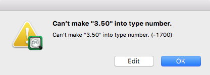

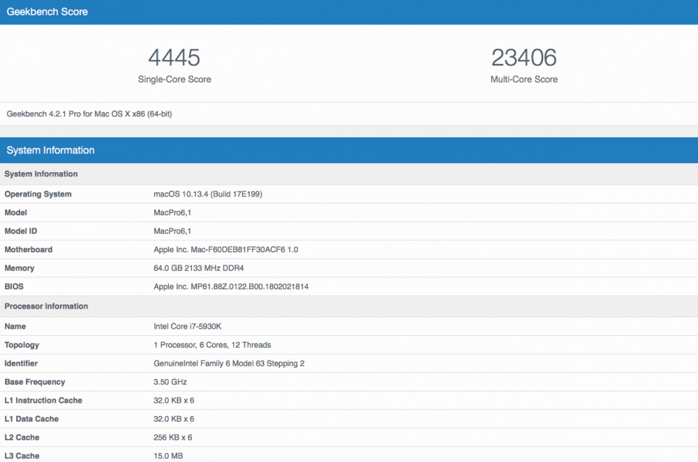

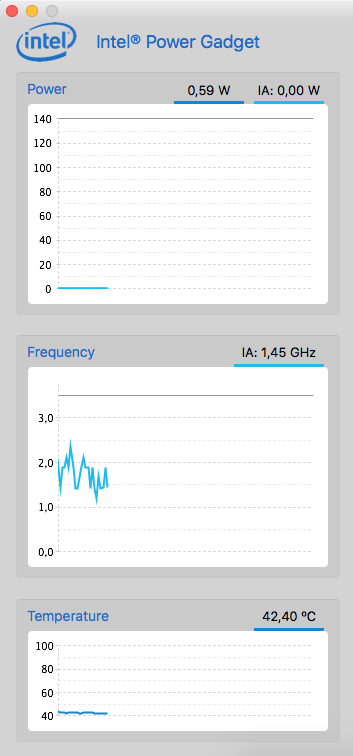

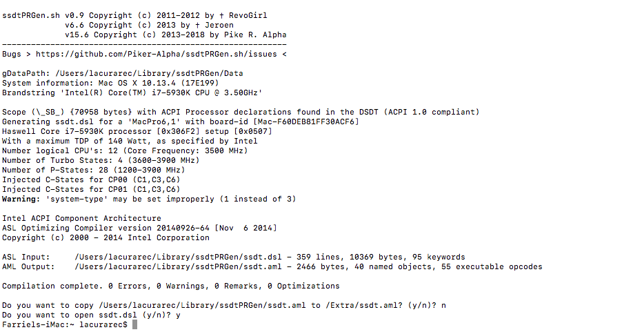

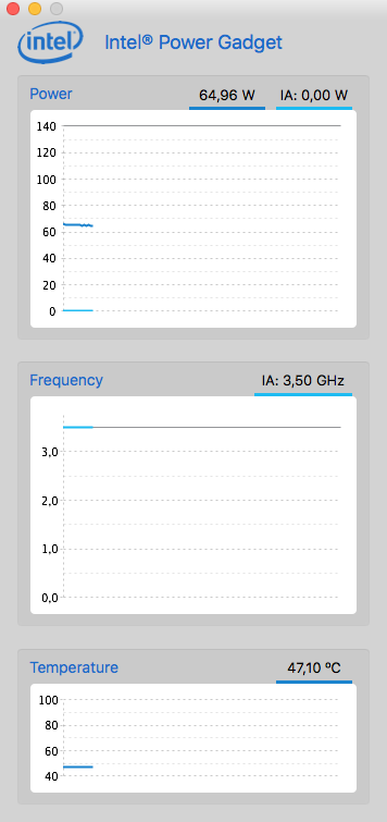

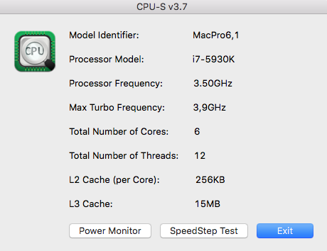

fariel23 Posted May 18, 2018 Share Posted May 18, 2018 (edited) Hello there!!! First of all before i was making this topic i did a research on the internet to find out if i can fix my issues by me self and so far I was not able to fix it so that’s why I decide to make this topic to see if anyone can help me out. - I have trouble getting my CPU SpeedStep working in High Sierra 10.13.4. so this way my cpu is always running at 3,5ghz. i try to make a SSDT and this is what i try so far: 1. in the bios is SpeedStep: ENABLE (don’t know if it need to be on or off) 2. i follow the following guide: Pike Alpha's ssdtPRGen.sh as you can see in the screenshot it did generated a ssdt file but it doesn't work and the speed stay the same. SSDT.aml SSDT.dsl 3. i also try the following app: CPU-S so far no luck - Geekbench result are not that great! After the installation was finnish i installed Geekbench app and ran a benchmark in single core the score where above 4300 an multicore was 22+ and after messing around now the score are Singlecore: 3586 and Multicore: 22687. I don’t remember what I did that the performance degress. - Nvida GTX980TI I installed the official drivers + the Cuda drivers and the graphics are working fine with the exception a few things: when I play video on youtube an do full screen there is a glitch and i feel somethings a bit laggy. I also notice in the app MacX Video Converter that there is No Hardware Encoding so I don’t know how to make It work either I did a research on the net but no luck! TWEAKS - I really hope to fix my hackintosh to the maximum if someone could take a look and can tweak my settings to get the most of it! it’s been long without a solution for this problems - in the attachments i ran the RunMe.app and attach the SendMe.zip and I also added a few screenshot so u can see the result. if u need something else let me know. thanks in advance link for the SendMe.zip: https://www120.zippyshare.com/v/7HRBywVW/file.html Edited May 18, 2018 by fariel23 Link to comment Share on other sites More sharing options...

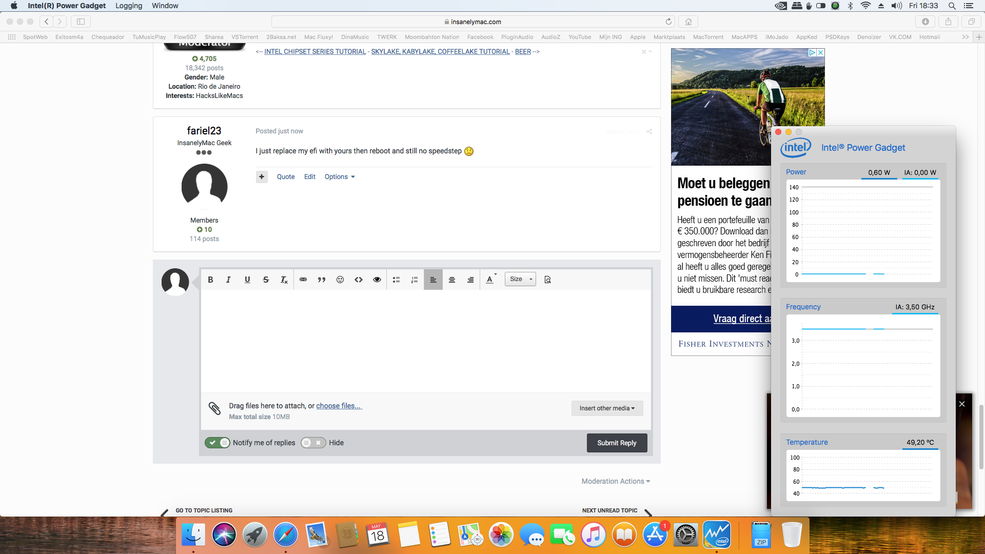

fariel23 Posted May 18, 2018 Author Share Posted May 18, 2018 (edited) I just replace my efi with yours then reboot and still no speedstep the fans are almost always at full speed and I have water-cooling cooler Edited May 18, 2018 by fariel23 Link to comment Share on other sites More sharing options...

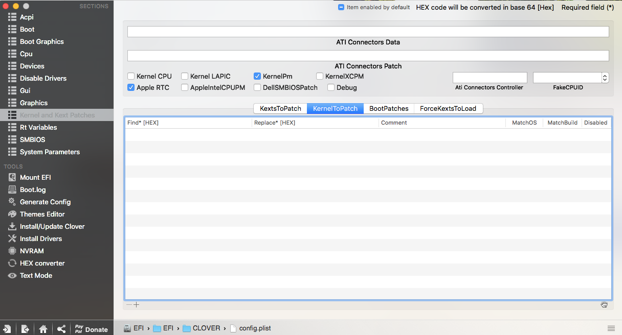

fariel23 Posted May 18, 2018 Author Share Posted May 18, 2018 I think you mean this but is empty what doe I need to put? Link to comment Share on other sites More sharing options...

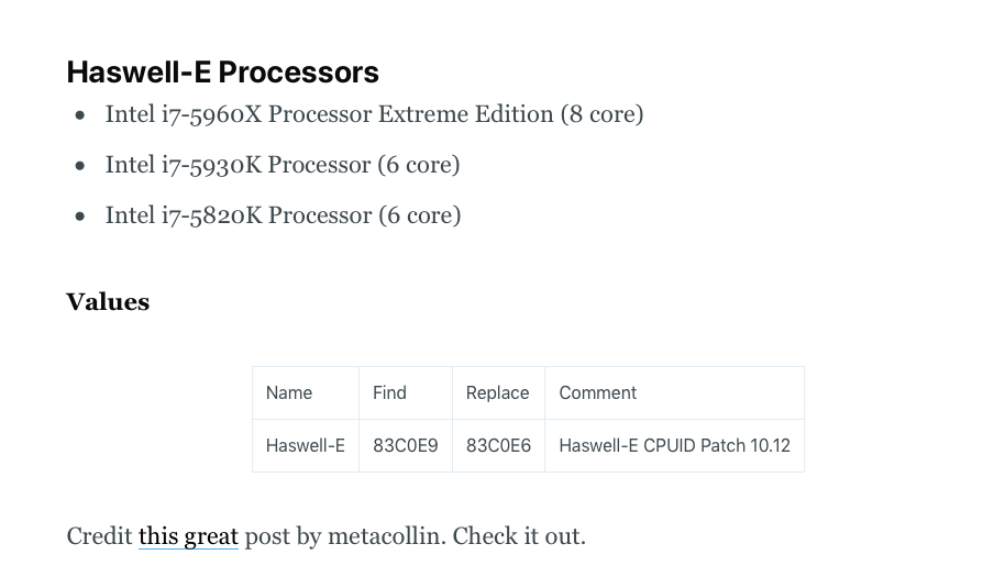

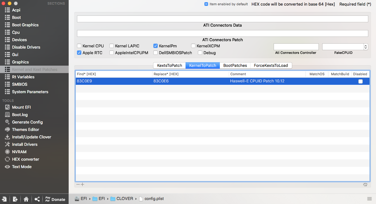

fariel23 Posted May 18, 2018 Author Share Posted May 18, 2018 I found this but is for 10.12: I gone to try it anyway but if someone know the patch for 10.13 would be great I reboot and still the same Link to comment Share on other sites More sharing options...

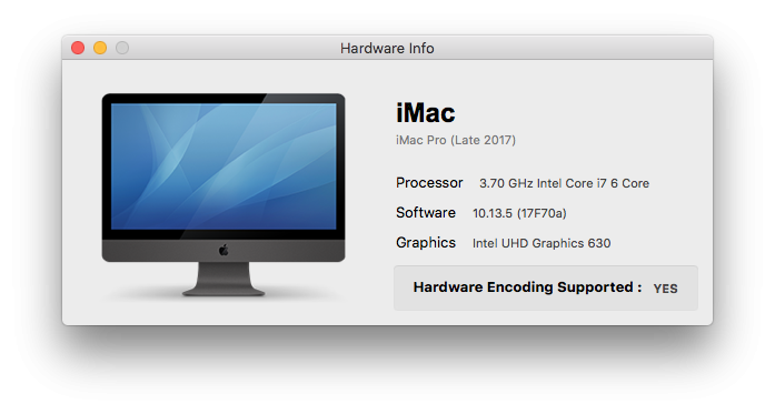

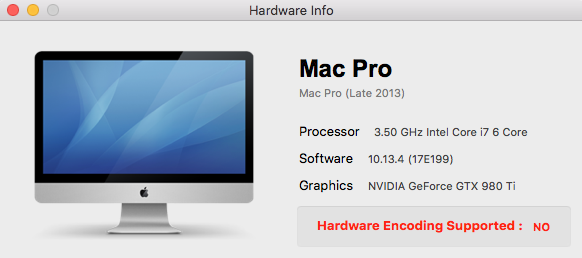

fariel23 Posted May 18, 2018 Author Share Posted May 18, 2018 do you know why MacX video Converter is showing no hardware encoding? Link to comment Share on other sites More sharing options...
MaLd0n Posted May 18, 2018 Share Posted May 18, 2018 i use it with IntelHD + RX 580, only DGPU idk if work good, need check it 1 Link to comment Share on other sites More sharing options...

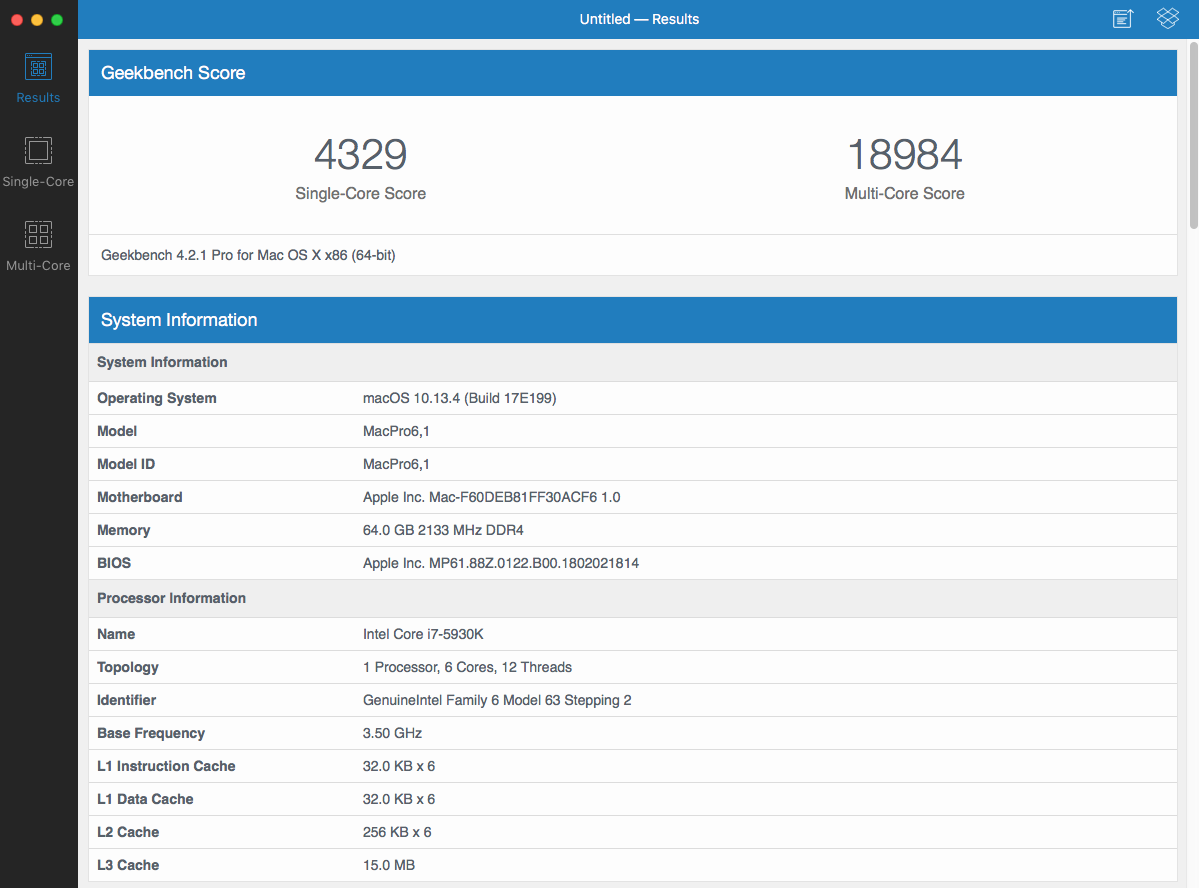

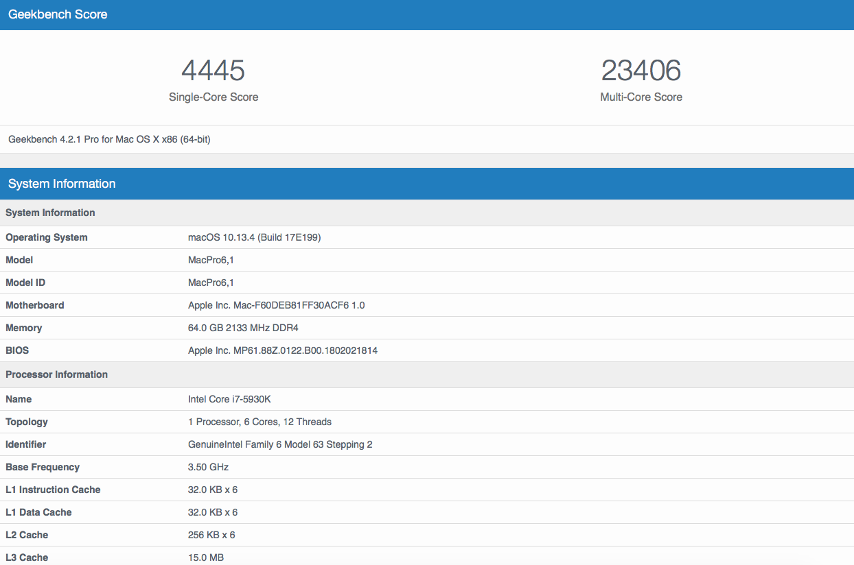

fariel23 Posted May 18, 2018 Author Share Posted May 18, 2018 Now in single core is good but in multicore performance is drop take a look: I don't know why Link to comment Share on other sites More sharing options...
MaLd0n Posted May 18, 2018 Share Posted May 18, 2018 u need a perfomance fix by oskrait / pmheart send me new files, run my app again 1 Link to comment Share on other sites More sharing options...
