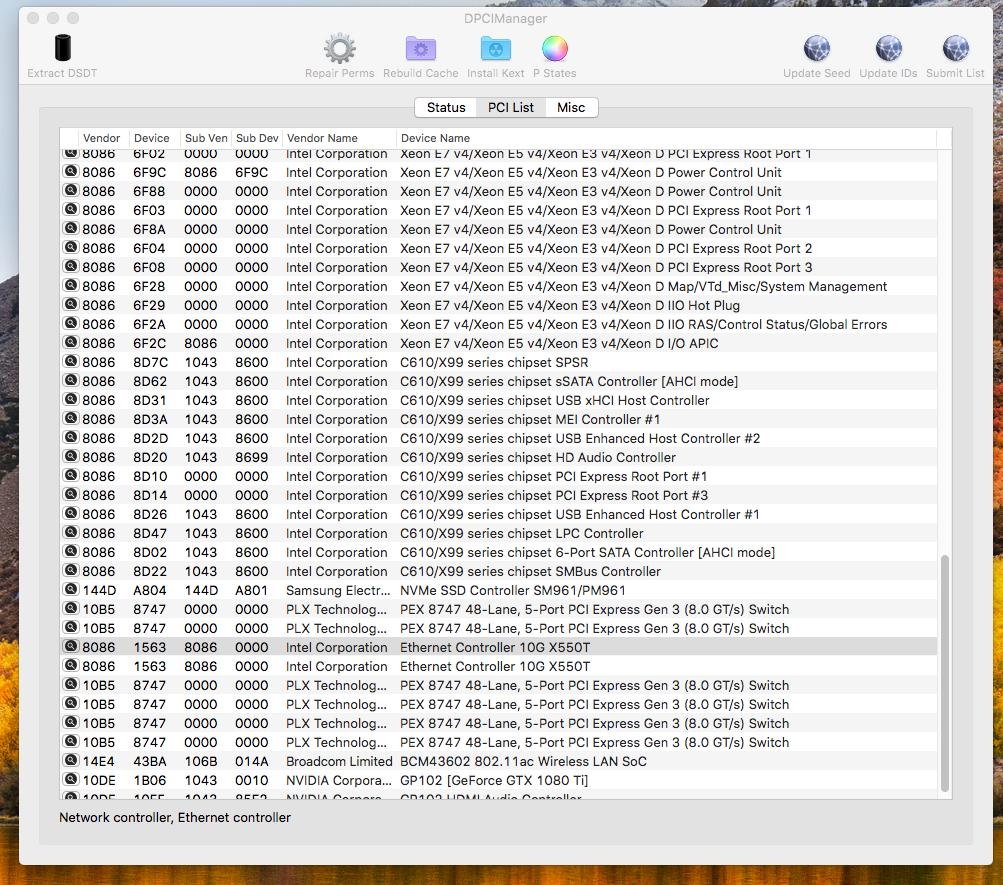

use DPCI MANAGER
DPCIManager.app.zip
PCI List Tab
Thanks for helping me

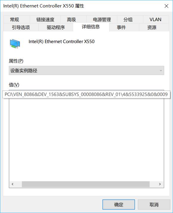

http://pci-ids.ucw.cz/read/PC/8086/1563
x540 driver ,Can modify it?

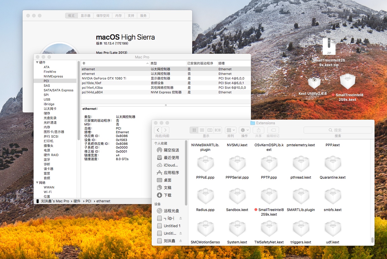

On ‎2018‎年‎4‎月‎9‎日 at 1:52 AM, MaLd0n said:
try in library/extensions, put kext in folder
SmallTreeIntel8259x.kext.zip
and run kext utility
Kext Utility.app.zip
https://www.tonymacx86.com/threads/intel-network-adapters-on-os-x-small-tree-drivers.156135/
 I don't know what to do

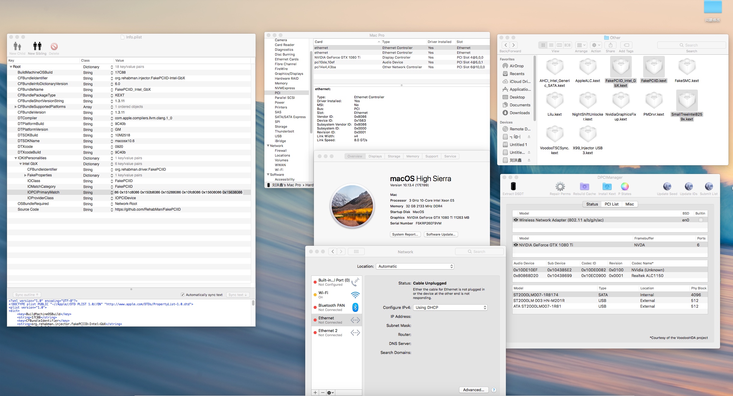

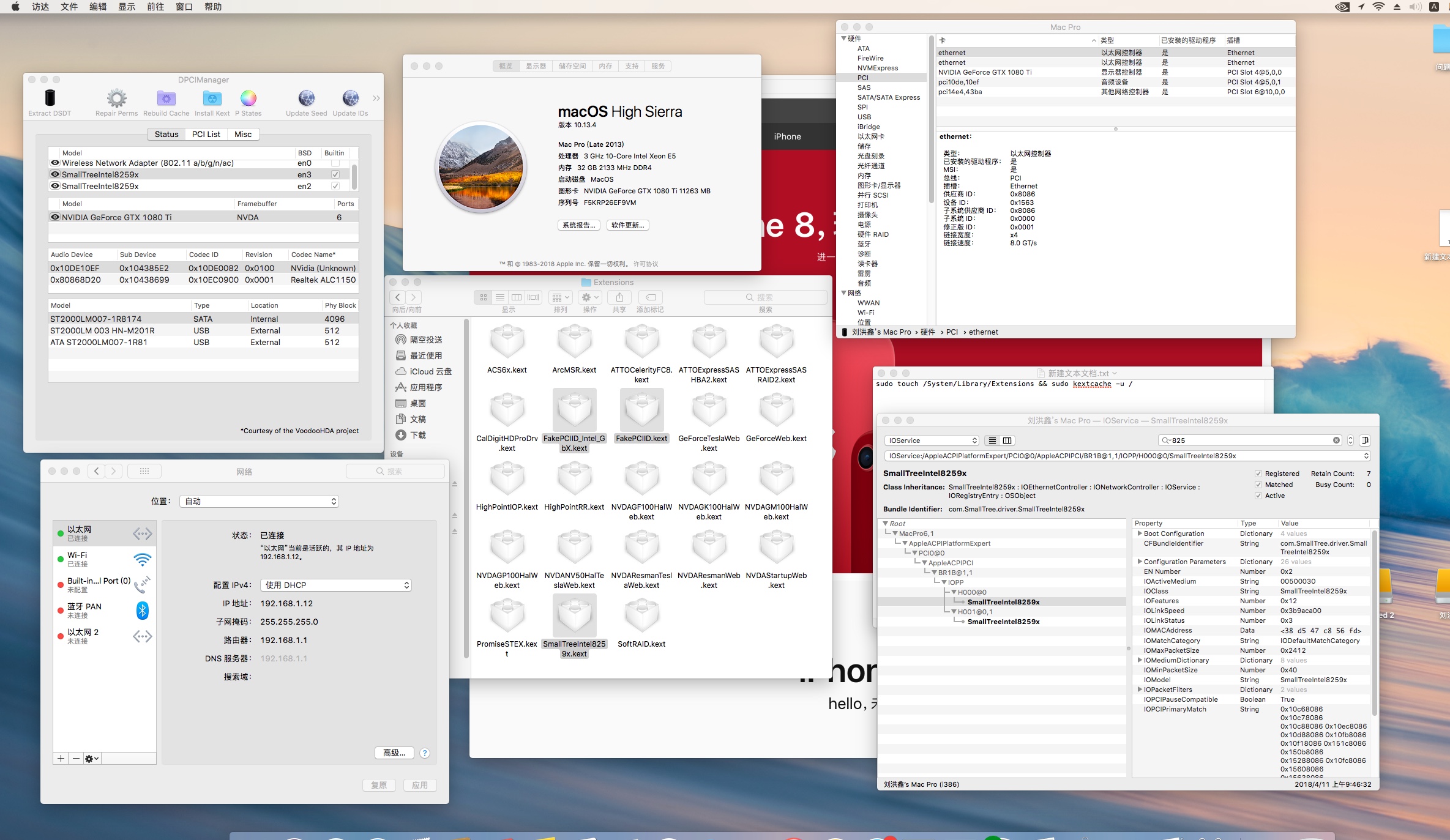

FakePCIID_Intel_GbX.kext  & FakePCIID.kext & SmallTreeIntel8259x.kext  in EFI\CLOVER\kexts\Other
driver controller : YES
status:cable unplugged
FakePCIID_3.zip
FakePCIID_Intel_GbX.kext :IOPCIPrimaryMatch 0x15638086

Edited by liuhongxin1993

I have moved the three .kext to the EFI partition and they work as expected on 10.15.3 but I am still not sure if this will unlock full potential, I think I'm not getting full bandwitch this way, perhaps with just the SmallTree driver instead of having to load 3 extensions just for one device.
I have tried to swap subsystemID's with ubuntu to no avail, for some reason ethtool does nothing when entering the correct code... Any ideas? @MaLd0n@liuhongxin1993??
