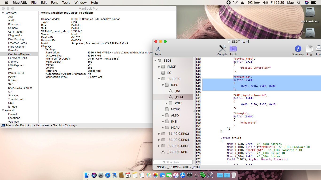

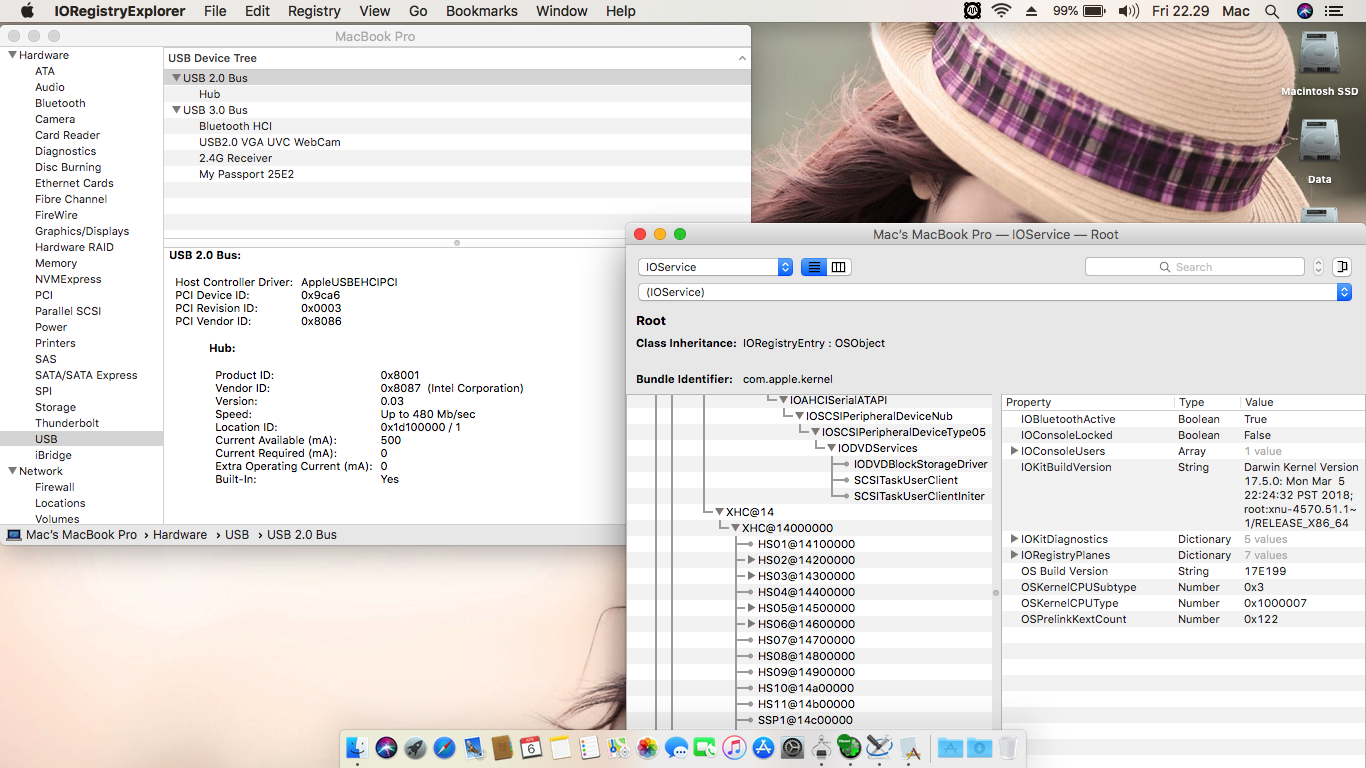

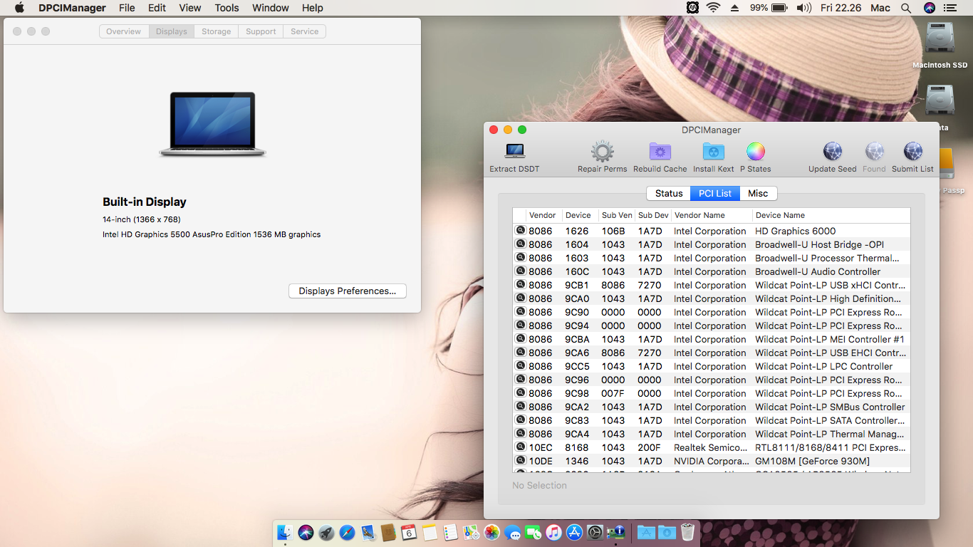

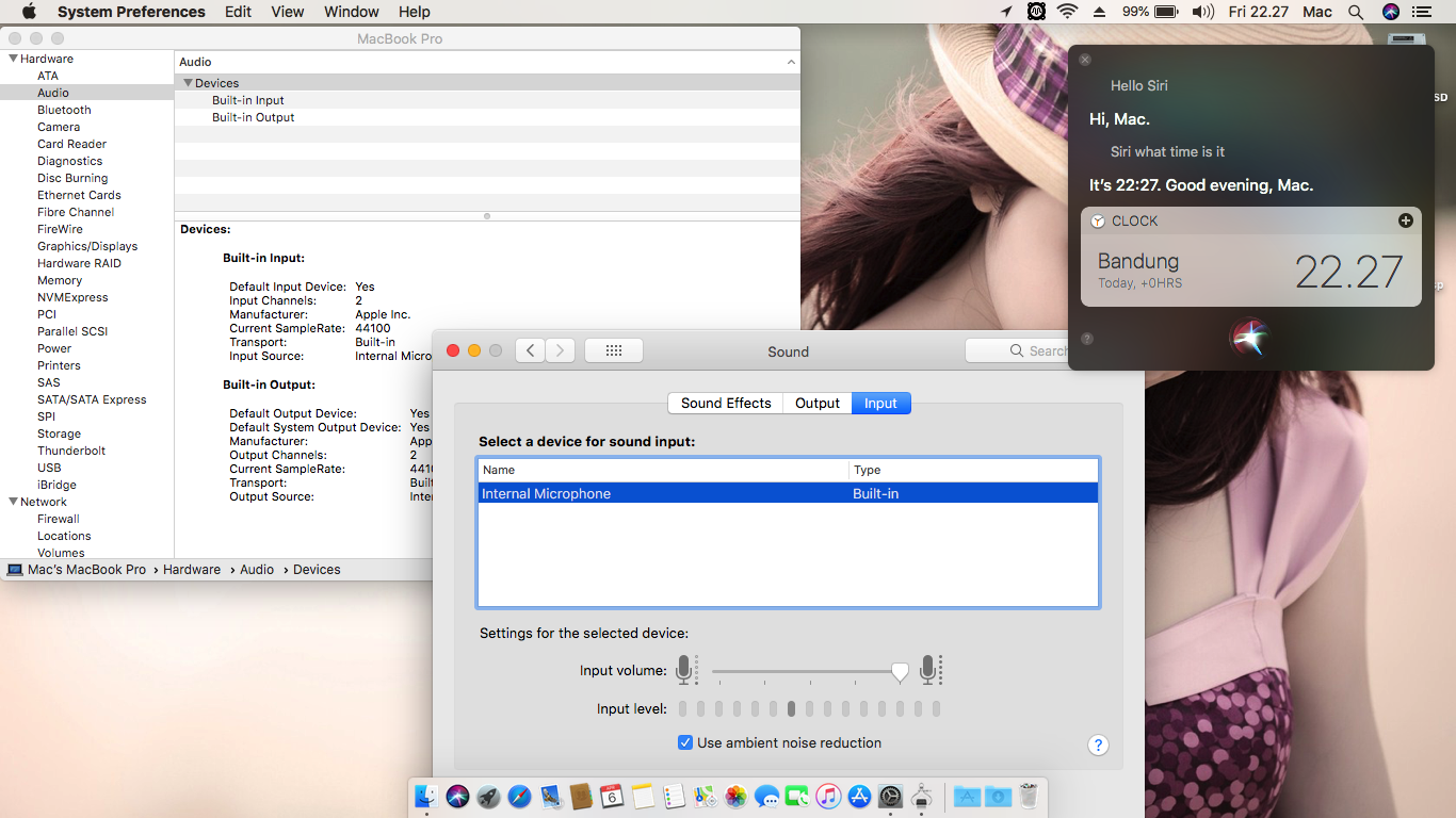

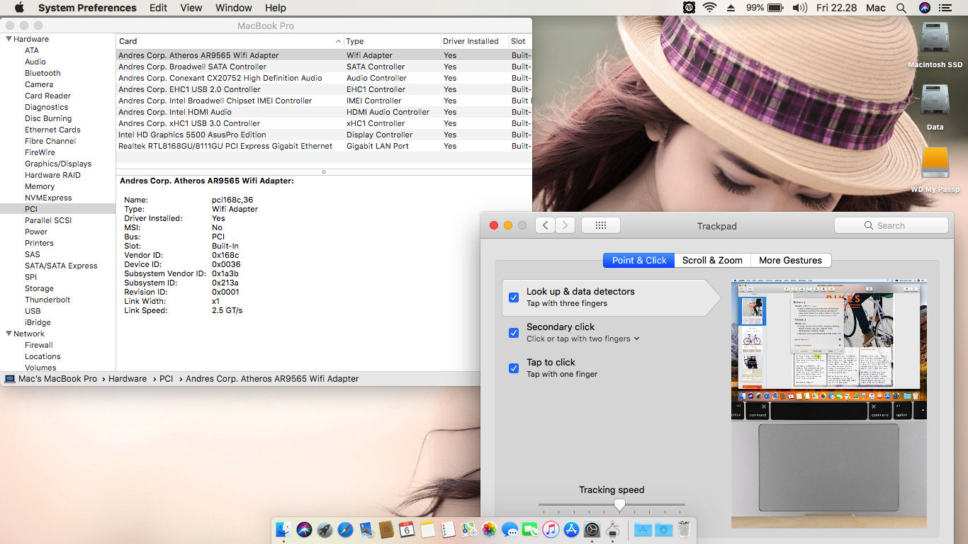

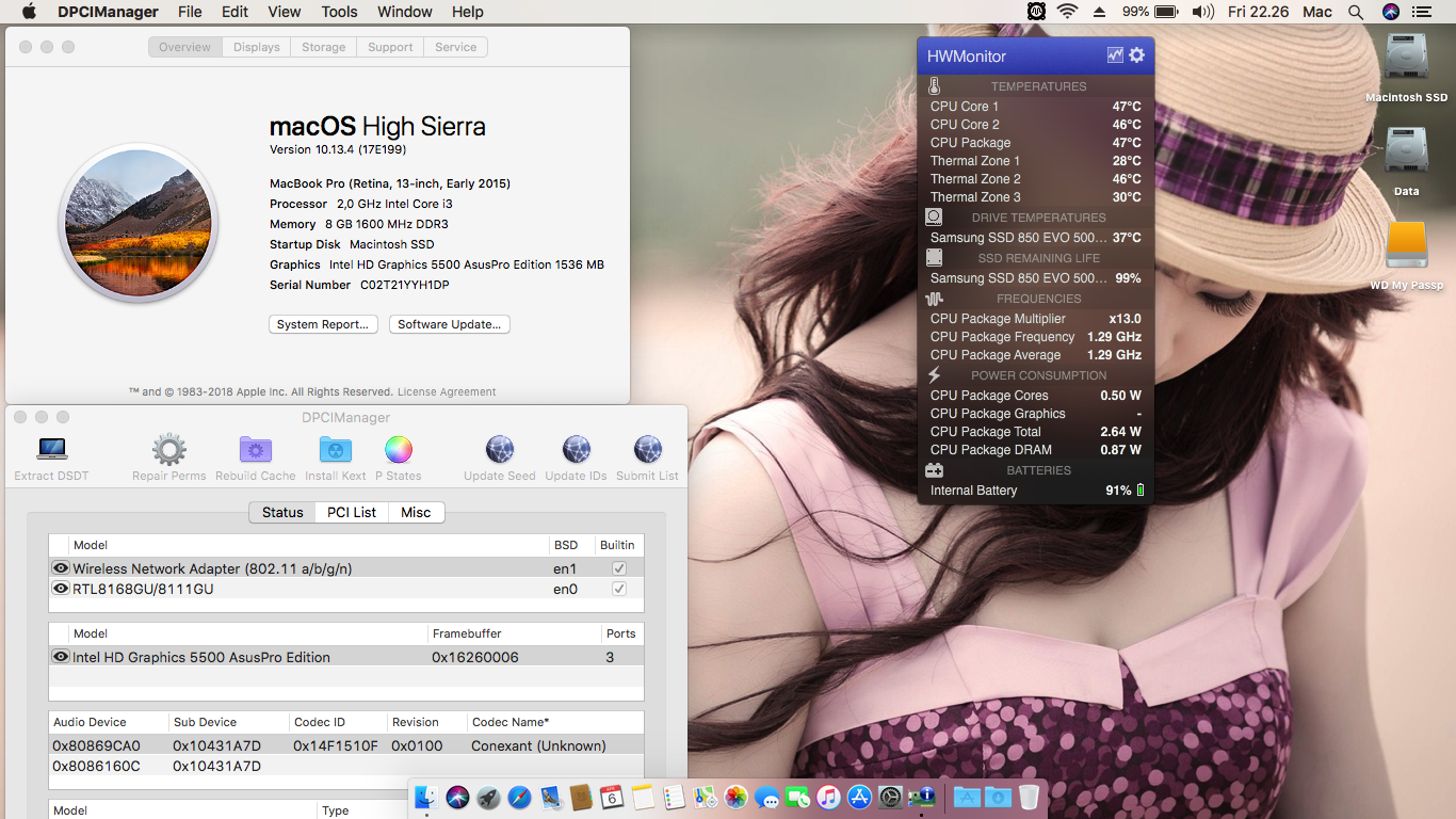

Andres ZeroCross Posted April 6, 2018 Share Posted April 6, 2018 (edited) A. Notebook Specifications Name : Asus A455LF-WX159D Processor : Intel Core i3 5005U IGPU : Intel HD Graphics 5500 Discrette GPU : Nvidia GT930M RAM : 8GB PC12800/1600Mhz Wifi Card : Atheros AR9565 Bios Version : 300 Audio Codec : Conexant Storage : Samsung SSD 850 Evo 500GB Boot Mode : UEFI with CSM Disabled B. How To Install I am not good for make a tutorial, so i upload my CLOVER folder (zipped), just use it (overwrite your USB Installer's Clover Folder) Set SATA Controller to AHCI at BIOS Make sure your BIOS version is "300" Set DVMT to 64MB XHC set to "Smart AUTO" C. Make a USB Installer with CreateInstallMedia method, install Clover Bootloader R4423 or above, then delete Clover Folder inside it and replace with mine ======= SPECIAL NOTE D. Normally for broadwell IGPU (IHD 5500), you only need to Inject Intel and set ig-platform-id=0x16160002 or 0x16260006. But some notebook will face RANDOM KERNEL PANIC or STUCK at IGPU log (hang) when you inject ig-platform-id. This is not DVMT Pre-Allocation Problem. I found the solution Just set FakeIGFX to 0x16268086, Tick Inject Intel and set ig-platform-id as 0x16260006 or 0x16160002. Now you will get QE/CI For me, i set those values at SSDT-1.aml (check my attachment file) ====== Whats Working?? - QE/Ci - Audio OUT and Mic - Wifi Card - LAN Ethernet - Battery Indicator - Fn + Brightness Button - Touchpad - Sleep, Restart and Shutdown - All USB Port (High Speed and Super Speed) - Battery Indicator - Etc Thanks My Clover Folder's Link : https://drive.google.com/open?id=1qzvT155DZ1r8cI0ceBW4OjWAEMUu491- Edited April 6, 2018 by Andres ZeroCross Add Clover Folder 4 Link to comment Share on other sites More sharing options...
