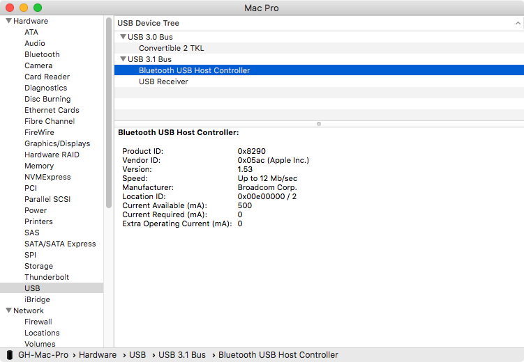

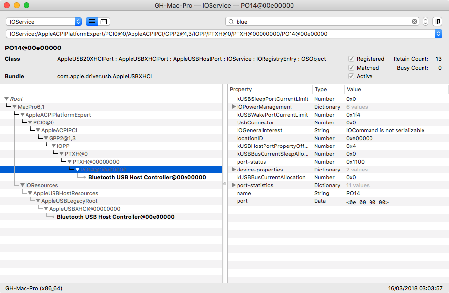

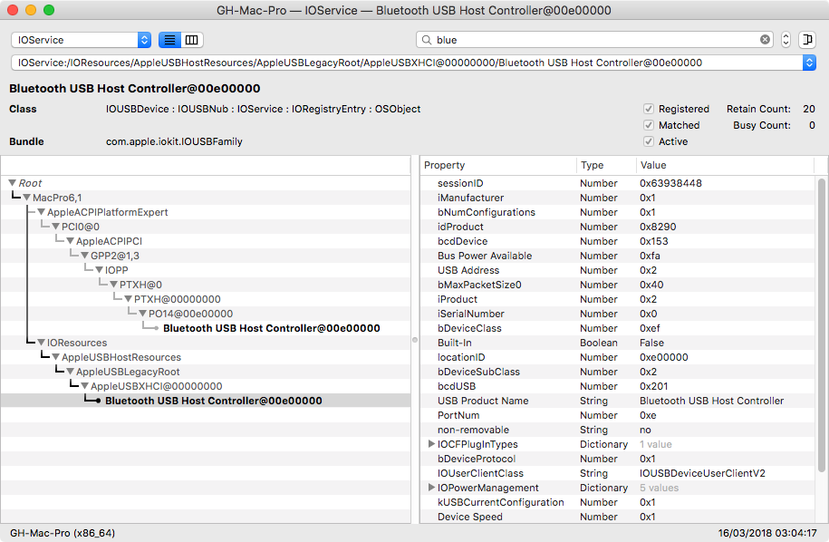

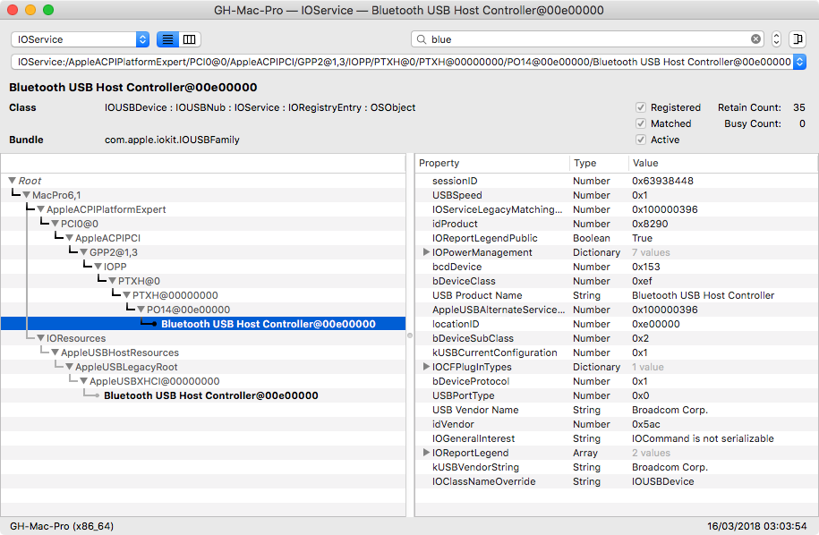

I used BCM943602CS for my Hackintosh. On High Sierra, the WiFi works well, however, the bluetooth doesn't work. I cannot find the bluetooth icon on the system preference pane. From the system report, I can see that the Device can be recognized as 'Bluetooth USB Host Controller'. From IORegistryExplorer, I've found that the device for it has a UsbConnector value of 0x0, which is weird. And the IOResources part says the device is not built-in. I don't know whether it has something to do with my MSI B350 Tomahawk (an AMD platform) motherboard. If someone has some advice, please help me out.
