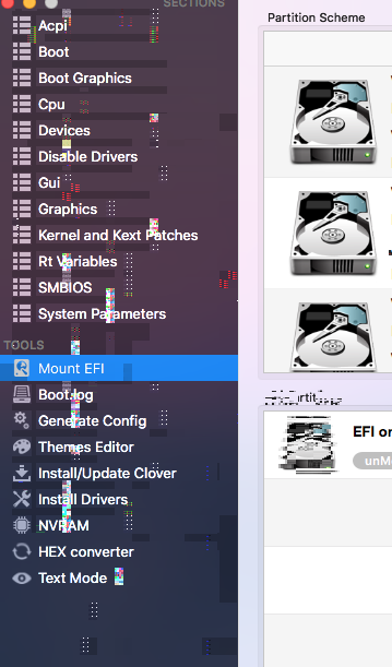

yaoqb Posted March 13, 2018 Share Posted March 13, 2018 (edited) i have strange glitch problem on my fresh 10.13.2 install the glitch trigered randomly it may start from subtitle video from firefox or some transparent panel from a program like clover configurator then the whole desktop will have the graphic glitch every program will be affected the glitch may clear when toggle the program window zoom in and out but will be likely popup again until restart the system the glitch can even be captured by the system's own screenshot short cut the following method i try didnt work nvidia webdriver latest lilu with NvidiaGraphicsFixup different powermanagement setting config.plist Edited March 13, 2018 by yaoqb update Link to comment https://www.insanelymac.com/forum/topic/333254-strange-graphic-glitches/ Share on other sites More sharing options...
CrashMidnick Posted March 16, 2018 Share Posted March 16, 2018 What is your graphic card ? Link to comment https://www.insanelymac.com/forum/topic/333254-strange-graphic-glitches/#findComment-2603498 Share on other sites More sharing options...
yaoqb Posted March 17, 2018 Author Share Posted March 17, 2018 i have a 660ti 2g on my build it works fine on sierra i google about my issue and find out that many builds with 660 or 660Ti suffering from glitches like this any suggestion on how to fix it ? thx in advance Link to comment https://www.insanelymac.com/forum/topic/333254-strange-graphic-glitches/#findComment-2603613 Share on other sites More sharing options...
CrashMidnick Posted April 4, 2018 Share Posted April 4, 2018 On 17/03/2018 at 4:47 AM, yaoqb said: i have a 660ti 2g on my build it works fine on sierra i google about my issue and find out that many builds with 660 or 660Ti suffering from glitches like this any suggestion on how to fix it ? thx in advance No fix, I was pretty sure that your GFX card was a 660(ti). Solutions : stick with Sierra or buy a new GFX card. I had a GTX660 and I bought a GTX770 (50€) which works great with High sierra. Some people said that they solved the problem by enabling iGPU but I did not check myself and it seems that it does not work for everybody... Link to comment https://www.insanelymac.com/forum/topic/333254-strange-graphic-glitches/#findComment-2607623 Share on other sites More sharing options...
