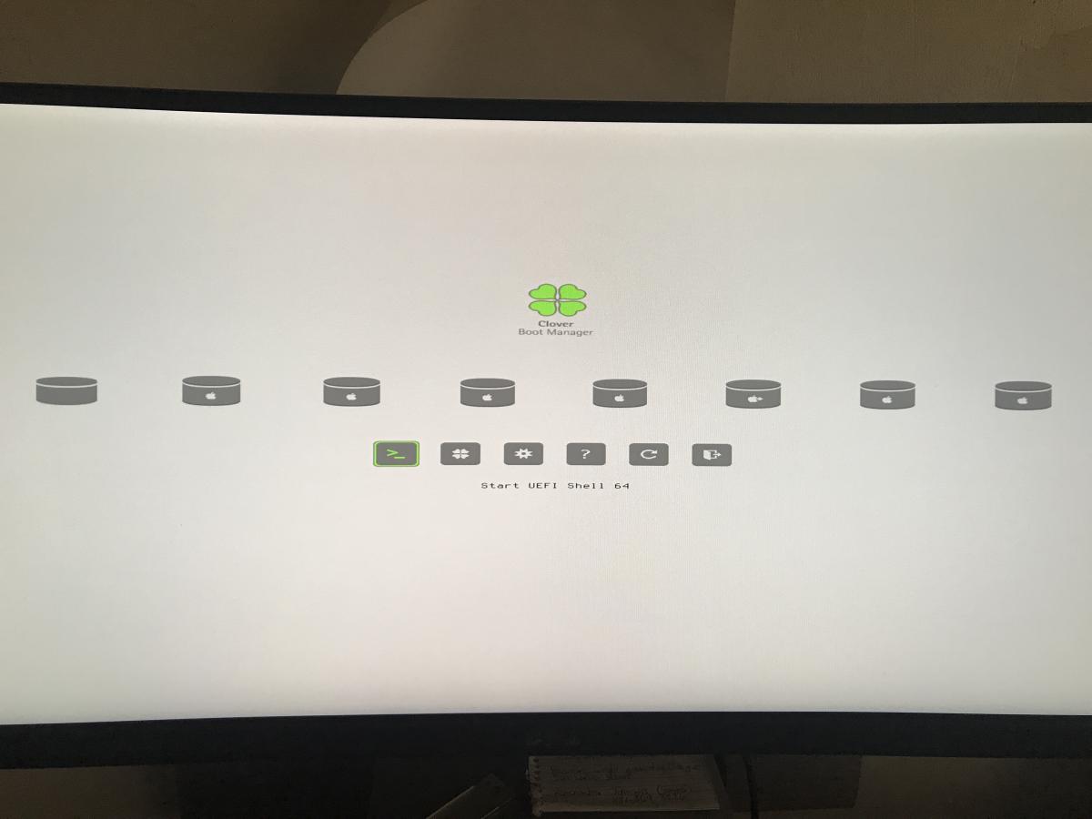

I’m trying to fresh install High Sierra to my M.2 SSD. I’ve been on the desktop but when I restart I’m back to this screen. It must be something in Clover Boot Manager that I’m not able to make permanent in Clover Configurator. Anybody have some idea?
I'm in but I won't shut it down until I figure out what is causing my Hack to stick at FakeSMCKeyStore.

Hi, I have the exact same error, my log it's almost identical to yours, all the acpi errors with SSDT, I think it's a cpu issue, I'm on a i5-2400, I was able to reach to that point by using the fakesmc from here, before I was only reaching the "AppleKeyStore::start" line. I will keep trying.
After many attempts I got it booting. It was caused by a DSDT patch missing, on the clover customs DSDT patches menus, I selected "Rename HDEF to AZAL". Works now :)
I’m unable to get to the desktop. Do you know how I can edit the DSDT from the Boot Manager?
Go to Options -> ACPI Patching -> Custom DSDT patches -> Rename HDEF to AZAL
Unable to Add or Edit.
I was using the default config.plist from clover install files, that one has the patches.
Can’t get to the config.plist via the Clover Boot Manager. Need to be on the desktop. I guess I’ll have to go the Remote route.

OK, bit late to the party but...
Trying to make a High Sierra HackIntosh on an HP XW6600, Dual E5450, 32Gb RAM, GTX970
I think it's Clover 4111 (?)
Tried console 64 thing and it doesn't have a uname (or anything else useful)
Clover Starts up with "HackIntoshBR" which I assume is a Brazilian grupe.
Hangs after FakeSMCKeyStore: Started
config.plist didn't have the patches section to begin with.
Took drive to MacBook, mounted EFI partition, editied config.plist, added section for patches, saved, rebooted.
Options -> ACPI Patching -> Custom DSDT patches - Empty ???
Ideas ?
