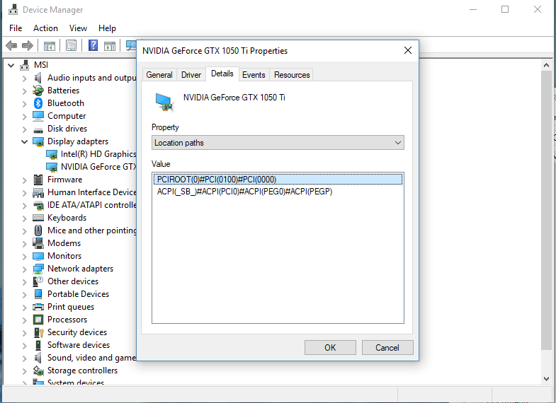

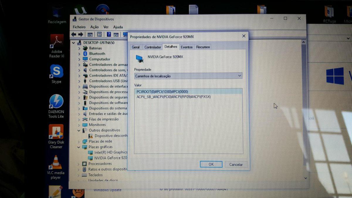

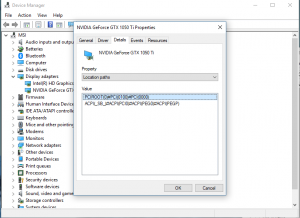

MaLd0n Posted January 26, 2018 Share Posted January 26, 2018 CLOVER.zip u need check device NVIDIA for disable u have windows? is here 1 Link to comment https://www.insanelymac.com/forum/topic/332021-msi-gv62-7re-1013-installation/#findComment-2577212 Share on other sites More sharing options...
ACDindia Posted January 26, 2018 Author Share Posted January 26, 2018 Thank you brother! I will check and get back to you!!! CLOVER.zip u need check device NVIDIA for disable u have windows? is here 27329798_1622742251128986_1714409452_o.jpg Here.. I am sending you a screen grab of the NVIDIA path... Please let me know what I should do now ? 1 Link to comment https://www.insanelymac.com/forum/topic/332021-msi-gv62-7re-1013-installation/#findComment-2577226 Share on other sites More sharing options...

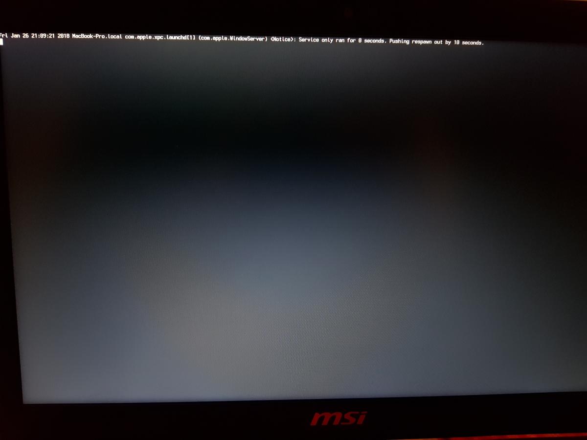

ACDindia Posted January 26, 2018 Author Share Posted January 26, 2018 Hi! I tried with your clover folder. The error of "Service existed with abnormal code 1" was still there but it did not crash. It went forward but then got stuck at the error (attached image) Service only ran for 0 seconds pushing respawning out by 10 seconds. Any leads ?? Thanks in advance.. 1 Link to comment https://www.insanelymac.com/forum/topic/332021-msi-gv62-7re-1013-installation/#findComment-2577292 Share on other sites More sharing options...
MaLd0n Posted January 26, 2018 Share Posted January 26, 2018 extract ur DSDT in windows use it RwPortableV1.5.2.zip save DSDT.bin 1 Link to comment https://www.insanelymac.com/forum/topic/332021-msi-gv62-7re-1013-installation/#findComment-2577295 Share on other sites More sharing options...

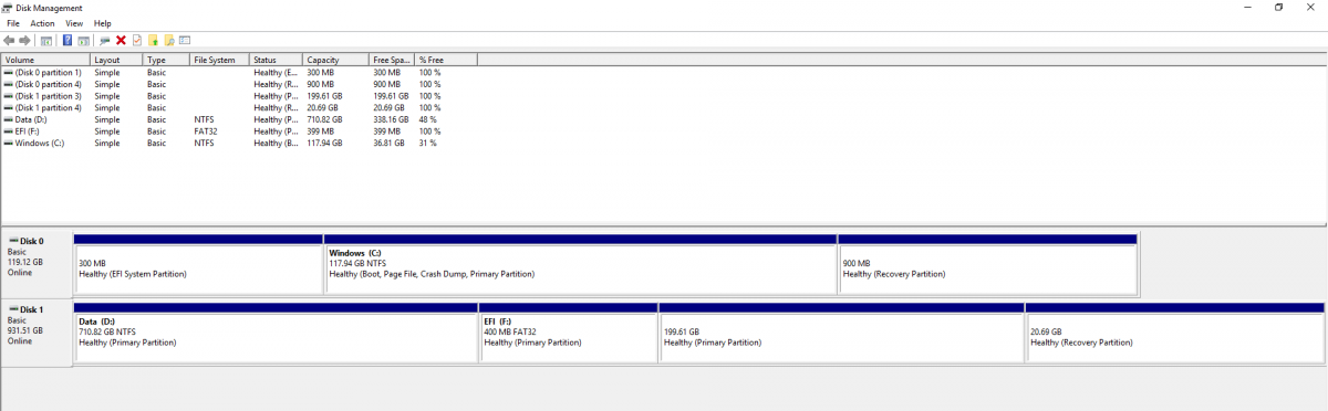

ACDindia Posted January 26, 2018 Author Share Posted January 26, 2018 u can use same folder in SSD/HDD too, install Clover and replace with foder above, after we can try solve battery, brightness, sound... Hey brother! I've tried installing the system and encountering the following errors: 1. While fomatting the drive for Mac: Mediakit reports not enough space for operation." I read that the EFI system should be larger than 200 MB, mine is 300 MB. 2. Still, I tried clicking on "Install macOS High Sierra", it ends up in an error: "this copy of install macOS high sierra is damaged". I am attaching the complete log of the same.... also my partition scheme (please note that the EFI partition on the second disk (HDD) was created by me, it isn't a system partition either. I thought maybe it will help so did it....... Any leads ? Thanks in advance!! Installer Log 26-Jan-2018_all.txt 1 Link to comment https://www.insanelymac.com/forum/topic/332021-msi-gv62-7re-1013-installation/#findComment-2577493 Share on other sites More sharing options...
MaLd0n Posted January 26, 2018 Share Posted January 26, 2018 idk, i format in DiskUtility in installer Link to comment https://www.insanelymac.com/forum/topic/332021-msi-gv62-7re-1013-installation/#findComment-2577644 Share on other sites More sharing options...

ACDindia Posted January 29, 2018 Author Share Posted January 29, 2018 k let me know Hey! Finally I installed hacOS successfully. For issue 1: My HDD lacked an EFI partition. For issue 2: Downloaded fresh copy of Install macOS High Sierra.app I will be running the files you sent me and will send you the data as soon as possible. Thank you @MaLd0N Link to comment https://www.insanelymac.com/forum/topic/332021-msi-gv62-7re-1013-installation/#findComment-2579276 Share on other sites More sharing options...

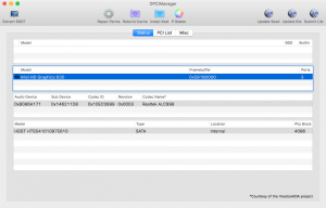

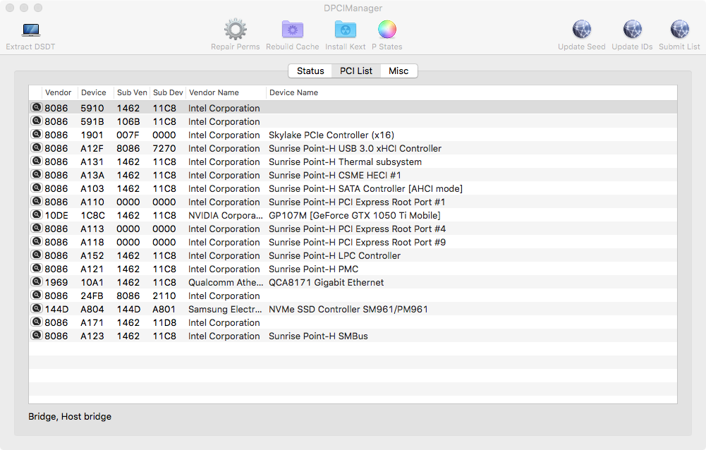

MaLd0n Posted January 29, 2018 Share Posted January 29, 2018 what ur audio codec? wifi model? ethernet card? touchpad? we need some information use dpci manager and try check DPCIManager.app.zip 1 Link to comment https://www.insanelymac.com/forum/topic/332021-msi-gv62-7re-1013-installation/#findComment-2579366 Share on other sites More sharing options...

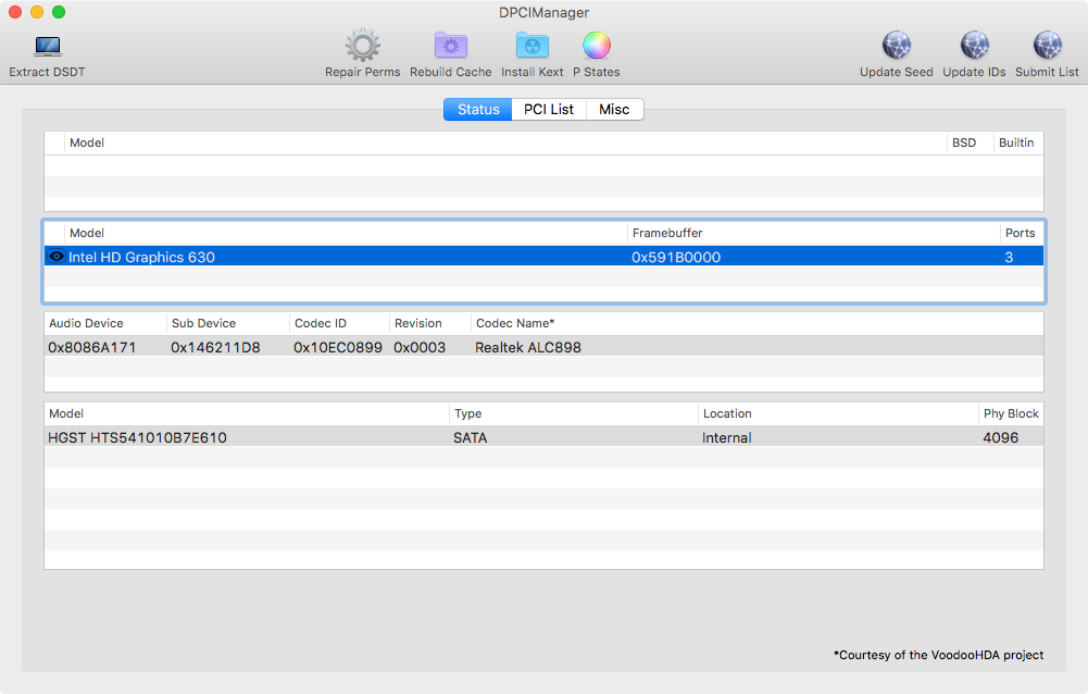

ACDindia Posted January 30, 2018 Author Share Posted January 30, 2018 what ur audio codec? wifi model? ethernet card? touchpad? we need some information use dpci manager and try check DPCIManager.app.zip Hey! Sorry for my late response. My internet was down... The screen grabs from the DPCI manager are attached. Please let me know if anything else is required... Thanking you! Link to comment https://www.insanelymac.com/forum/topic/332021-msi-gv62-7re-1013-installation/#findComment-2580041 Share on other sites More sharing options...

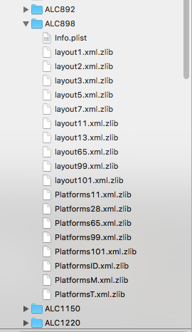

MaLd0n Posted January 30, 2018 Share Posted January 30, 2018 Ethernet http://www.insanelymac.com/forum/files/file/313-atherose2200ethernet/ Audio u can test some ids check here Use this DSDT and Inject id in config.plist and reboot, one by one, use AppleAlc + Lilu.kext DSDT.aml.zip here Link to comment https://www.insanelymac.com/forum/topic/332021-msi-gv62-7re-1013-installation/#findComment-2580205 Share on other sites More sharing options...
ACDindia Posted January 30, 2018 Author Share Posted January 30, 2018 Ethernet http://www.insanelymac.com/forum/files/file/313-atherose2200ethernet/ Audio u can test some ids check here MaLd0n 2018-01-30 às 11.02.00.png Use this DSDT and Inject id in config.plist and reboot, one by one, use AppleAlc + Lilu.kext DSDT.aml.zip here MaLd0n 2018-01-30 às 11.06.37.png Thank you so much brother! Thanks for all the efforts you’re putting.. I will surely get back to you once I’ve tried these. 1 Link to comment https://www.insanelymac.com/forum/topic/332021-msi-gv62-7re-1013-installation/#findComment-2580446 Share on other sites More sharing options...
