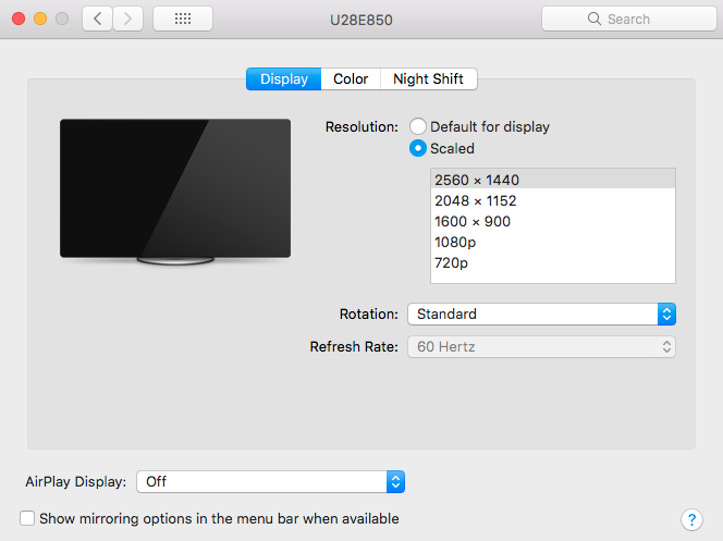

massyh Posted January 21, 2018 Share Posted January 21, 2018 Hi all, I have recently purchased a Samsung U28E850R monitor and it's connected to my Dell 3020m computer running Mac OS High Sierra via DP to Mini DP and for some reason I can't set my screen resolution to 3840x2160 and I don't understand why!. At the moment the maximum resolution I can set my screen to, is 2560x1440 also I'm unable to change the Refresh Rate "Screenshoots" . Any ideas would be appreciated. PS: my graphic card is intel HD 4600 and it works on 3840x2160 in Windows 10 Link to comment https://www.insanelymac.com/forum/topic/331862-unable-to-set-screen-resolution-to-3840x2160/ Share on other sites More sharing options...

massyh Posted January 21, 2018 Author Share Posted January 21, 2018 Yes I have been through the displays PrefPane in the setting "attached screenshot" and it's shows the Maximum Res available is as high as 2560 x 1440 to set! There is not any other resolutions available! I assume you've been through the Displays PrefPane to try and adjust the screen res but it does not work, right? You can also install Display Menu free app off the AppStore. It'll give you a little Finder bar's icon to set screen res and frequency amongst those offered by default by OS X/macOS. DisplayMenu.png Link to comment https://www.insanelymac.com/forum/topic/331862-unable-to-set-screen-resolution-to-3840x2160/#findComment-2573579 Share on other sites More sharing options...

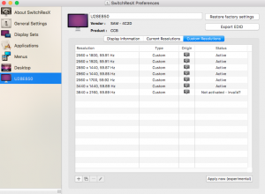

massyh Posted January 24, 2018 Author Share Posted January 24, 2018 Are you using HDMI or DP? Also, what is your clover profile? Until recently Macs did not support 4k over hdmi I'm using DP port. Might be something wrong in my Clover configuration! As "Herve" suggested, I've installed Lilu.kext + CoreDisplayFixup.kext and with them being installed properly and also SwitchResX app, I've finally added a few Custom Res "attached Screenshot" yet I couldn't add any Res near 4K as you can see the in the screenshot, 4K isn't activated. Link to comment https://www.insanelymac.com/forum/topic/331862-unable-to-set-screen-resolution-to-3840x2160/#findComment-2575933 Share on other sites More sharing options...
massyh Posted January 25, 2018 Author Share Posted January 25, 2018 In either/or but not in both at the same time; don't duplicate cached kexts! The advantage of /L/E is that it's really meant for add-on kexts and it's ignored if you boot without cache, unlike /S/L/E. It's always been recommended to keep /S/L/E fully vanilla, unless an add-on kext can only be loaded fromthere (eg: patched AppleHDA). Thanks for your help! I have tried many things and I have managed to add many Custom Res but couldn't get as better as screenshot above. I think as one of the member's posted earlier, Intel HD 4600 doesn't have native 4K resolution support in macOS. Maybe that's why I'm unable to set 4K Res or its something really wrong in my Clover configuration. 1 Link to comment https://www.insanelymac.com/forum/topic/331862-unable-to-set-screen-resolution-to-3840x2160/#findComment-2576839 Share on other sites More sharing options...

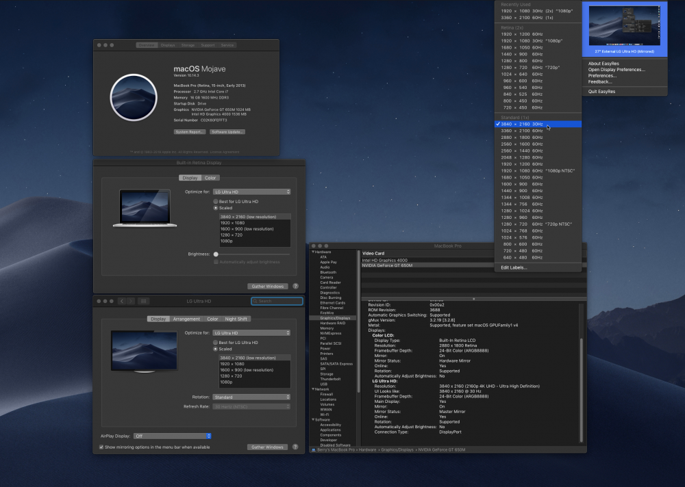

Berry Posted February 15, 2019 Share Posted February 15, 2019 HI Guys https://www.photobox.co.uk/my/photo/full?photo_id=501666659889 I use cable mini display cable to display cable my graphics are: NVIDIA GeForce GT 650M 1024 MB Intel HD Graphics 4000 1536 MB If you look at link with screen what I send You will see that LCD use my NVIDIA GT650M graphic cardAnd base what I get is 3840x2160 30HZ i check SwitchResX and when i give him custom resolution 3840x2160 60HZ and I get info that mac dont allow this resolution I try go down with Hertz by no work. Can you tell me how I can use this apllications (Lilu.kext + CoreDisplayFixup.kext )? Link to comment https://www.insanelymac.com/forum/topic/331862-unable-to-set-screen-resolution-to-3840x2160/#findComment-2664170 Share on other sites More sharing options...
