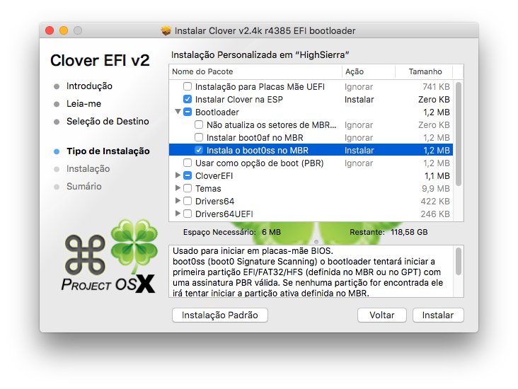

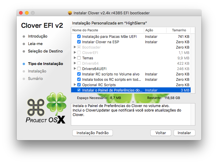

MaLd0n Posted January 19, 2018 Share Posted January 19, 2018 Clover boot manager has no MAC loader or anything. Just windows EFI. I can enter my base installation with the USB as emergency backup. I just deleted the old Clover folder and replaced with the new one. Anyways I made a backup folder from the old one. Did something wrong? C. My system is now as it was before. Always made a Backup before critical changes. k check, put DSDT in Clover/Acpi/Patched and add some hotpatches in ur old config.plist, just to avoid problems EC0 to EC 4543 305f 4543 5f5f GFX0 to IGPU 47465830 49475055 HDAS to HDEF 48444153 48444546 HECI to IMEI 48454349 494d4549 in next installation, install clover with these options or boot0ss and replace with my folder Link to comment https://www.insanelymac.com/forum/topic/331765-dsdt-build-for-maximus-hero-viii-help/#findComment-2571896 Share on other sites More sharing options...
Peke Posted January 19, 2018 Author Share Posted January 19, 2018 k check, put DSDT in Clover/Acpi/Patched and add some hotpatches in ur old config.plist, just to avoid problems EC0 to EC 4543 305f 4543 5f5f GFX0 to IGPU 47465830 49475055 HDAS to HDEF 48444153 48444546 HECI to IMEI 48454349 494d4549 in next installation, install clover with these options MaLd0n 2018-01-18 às 23.20.50.png or boot0ss MaLd0n 2018-01-18 às 23.21.36.png and replace with my folder I followed again the dsdt and clover file replacement again before doing what you send me in the last reply to check if I did something wrong. Of course I made some noob mistake the first time as now everything is fine. New Clover loader is really nice!! Here is the Ioreg attachment. Maximus’s iMac.zip 1 Link to comment https://www.insanelymac.com/forum/topic/331765-dsdt-build-for-maximus-hero-viii-help/#findComment-2571907 Share on other sites More sharing options...

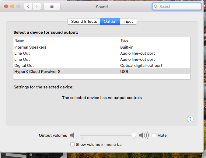

Peke Posted January 19, 2018 Author Share Posted January 19, 2018 now, put DSDT unzipped in Clover/Acpi/Patched DSDT.Peke Full.zip Put CodecCommander.kext in Clover/Kexts/Other and remove WhateverGreen.kext reboot and send me new ioreg with new DSDT New Ioreg and sound is ok through USB. Maximus’s iMac ver.2.0.zip 1 Link to comment https://www.insanelymac.com/forum/topic/331765-dsdt-build-for-maximus-hero-viii-help/#findComment-2571914 Share on other sites More sharing options...
MaLd0n Posted January 19, 2018 Share Posted January 19, 2018 New Ioreg and sound is ok through USB. ioreg is nice u test sleep? audio onboard work? Link to comment https://www.insanelymac.com/forum/topic/331765-dsdt-build-for-maximus-hero-viii-help/#findComment-2571917 Share on other sites More sharing options...
Peke Posted January 19, 2018 Author Share Posted January 19, 2018 Audio Onboard is ok. Sleep was working before with no problems. I´ll test it tomorrow as now I need to go. I`ll keep you informed. And thanks. You invested a lot of time helping me. I will write later a complete Guide over my installation to help others as I did from scratch with createinstallmedia, Bios settings ,SSD hfs+ (working with terminal over clover, etc). I think it would help others. I stay in touch. 1 Link to comment https://www.insanelymac.com/forum/topic/331765-dsdt-build-for-maximus-hero-viii-help/#findComment-2571919 Share on other sites More sharing options...

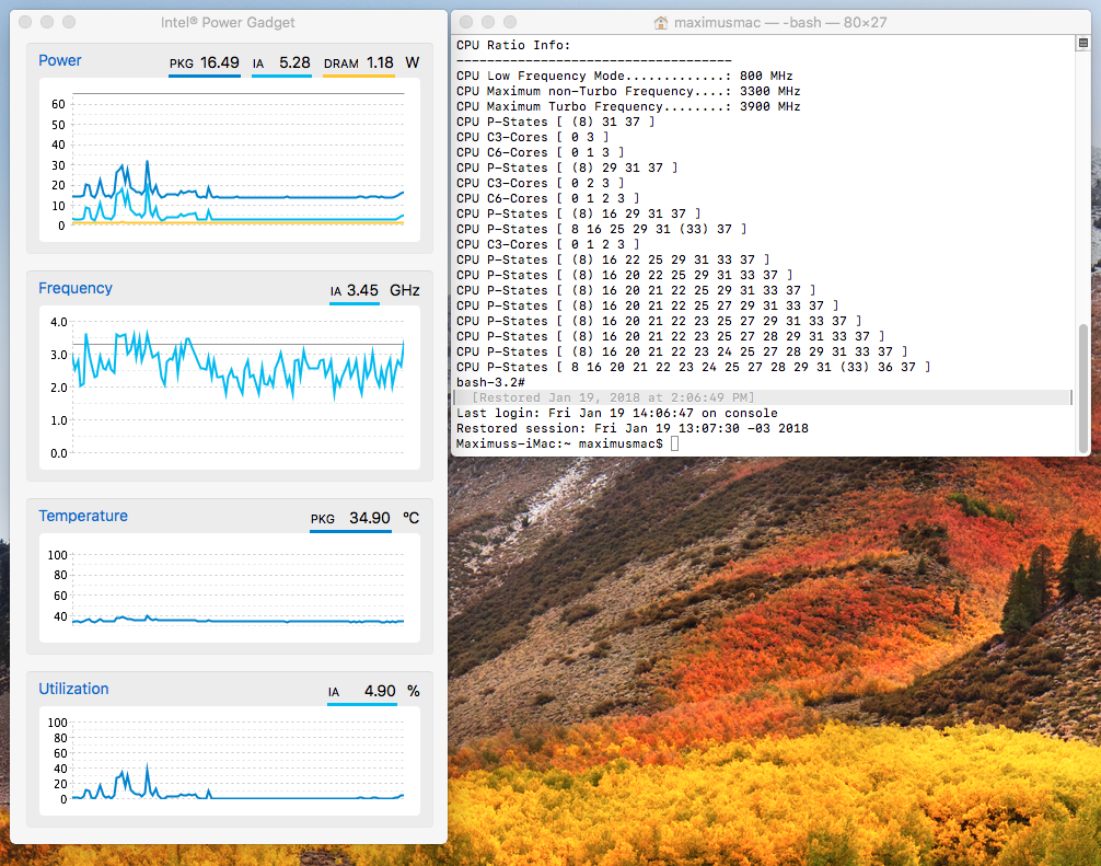

Peke Posted January 19, 2018 Author Share Posted January 19, 2018 Enjoy ur Hack! Hi Madlon. Yes! Already enjoying this beauty! Another question. Is necessary to use a custom made SSDT for my CPU now? Or is already covered with the new DSDT? I already followed some instructions with ssdtPRGen.Master and made my own for my processor (Its not loaded anyways.) I ask this because I checked with intel power gadget the frequency of my cpu and found it never drops below 1,5. GHZ and always near 2.4 GHZ even in idle. Is this normal? Attached the picture. Also the custom made new SSDT.aml if necessary to use it. Regards. C. ssdt.aml.zip 1 Link to comment https://www.insanelymac.com/forum/topic/331765-dsdt-build-for-maximus-hero-viii-help/#findComment-2572241 Share on other sites More sharing options...
MaLd0n Posted January 19, 2018 Share Posted January 19, 2018 u can check it here http://www.insanelymac.com/forum/topic/321021-guide-hwpintel-speed-shift-enable-with-full-power-management/page-1 some solutions in comments 1 Link to comment https://www.insanelymac.com/forum/topic/331765-dsdt-build-for-maximus-hero-viii-help/#findComment-2572247 Share on other sites More sharing options...
