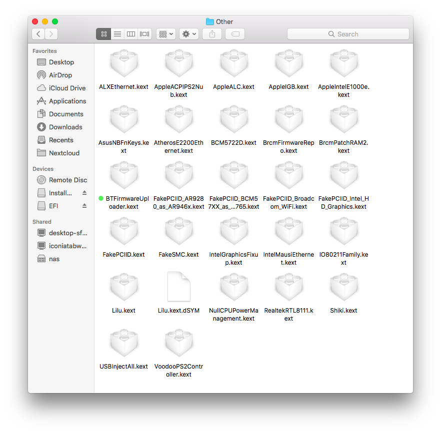

Gigamaxx Posted January 14, 2018 Share Posted January 14, 2018 I see about 4-5 different Ethernet kexts in the other folder, do you know which ethernet you do have, is it realtech or Intel? Try this use cursor arrows at clover boot screen to go to 'options" tab hit enter then on the top should be boot arg. Remove the slide=0 and kext dev mode. Try a normal boot. Link to comment https://www.insanelymac.com/forum/topic/331595-beach-ball-on-normal-boot-but-able-to-boot-safe-mode-okay/#findComment-2568950 Share on other sites More sharing options...

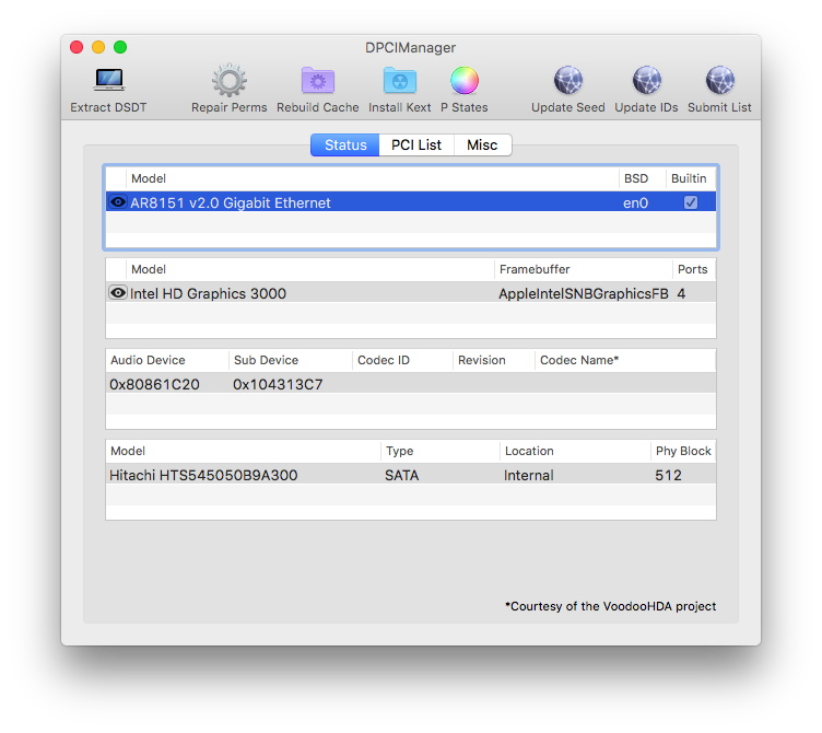

Gigamaxx Posted January 14, 2018 Share Posted January 14, 2018 Google and download DPCIManger appp and open it then select PCI list. Look for the ethernet vendor, device ID and other info. Take a screenshot by pressing (shift+cmd+3) you can right click on the eyeball icon on the left side of the ethernet device info and it should show which kext(s) it is using then you can remove the others. Link to comment https://www.insanelymac.com/forum/topic/331595-beach-ball-on-normal-boot-but-able-to-boot-safe-mode-okay/#findComment-2568961 Share on other sites More sharing options...

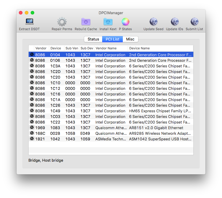

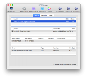

Deceiver Posted January 14, 2018 Author Share Posted January 14, 2018 Okay, so I downloaded DPCIManager. What a great tool. Here's what I came up with, attached. For the ethernet eyeball, it popped up a message with this: Ethernet<key>device-properties</key> <string>4b00000001000000010000003f0000000100000002010c00d041080a0000000001010600051c0101060000007fff0400160000006200750069006c0074002d0069006e0000000500000001</string> So I'm not entirely sure if that's referring to any kexts at all? Link to comment https://www.insanelymac.com/forum/topic/331595-beach-ball-on-normal-boot-but-able-to-boot-safe-mode-okay/#findComment-2569007 Share on other sites More sharing options...

Gigamaxx Posted January 16, 2018 Share Posted January 16, 2018 At the bottom the Atheros Ethernet ARB151, try to find a kext for that version and remove the others in your clover folder. Right click on that eyeball on the left to see if it shows an applicable apple kext for it. Link to comment https://www.insanelymac.com/forum/topic/331595-beach-ball-on-normal-boot-but-able-to-boot-safe-mode-okay/#findComment-2570302 Share on other sites More sharing options...
oneforall Posted January 20, 2018 Share Posted January 20, 2018 You can use HWInfo64 (windows version) to know about hardware and put the kexts in the folder accordingly. you don't need lots on kexts to bootup just fakesmc, voodoops2, usbinjectall, graphicfixup and nullpowermanagement will also do the job. LAN, wifi & audio kext can be installed afterwords with kextutility. Make sure to check kernelLapic(Supported by 3rd gen cpu) option instead of XPMC uncheck appleIntelCPUPM. Link to comment https://www.insanelymac.com/forum/topic/331595-beach-ball-on-normal-boot-but-able-to-boot-safe-mode-okay/#findComment-2572921 Share on other sites More sharing options...
