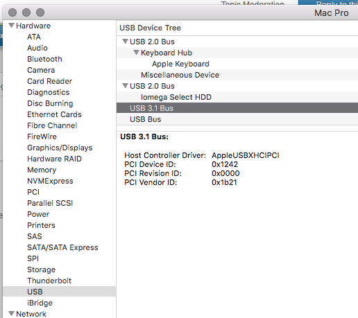

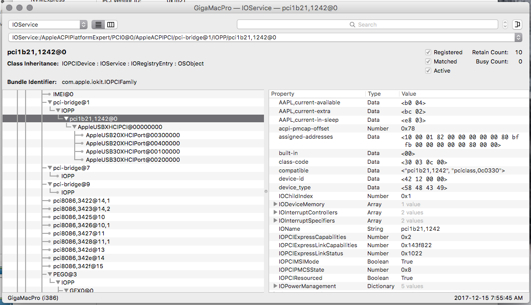

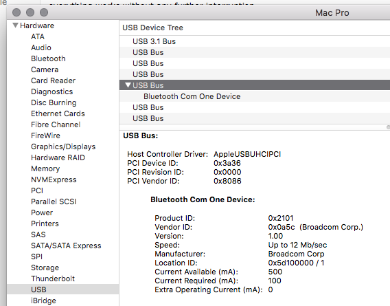

Screenshots:
post-508994-0-45667100-1513342583_thumb.png post-508994-0-76755600-1513342595_thumb.png post-508994-0-21629400-1513343551_thumb.png
