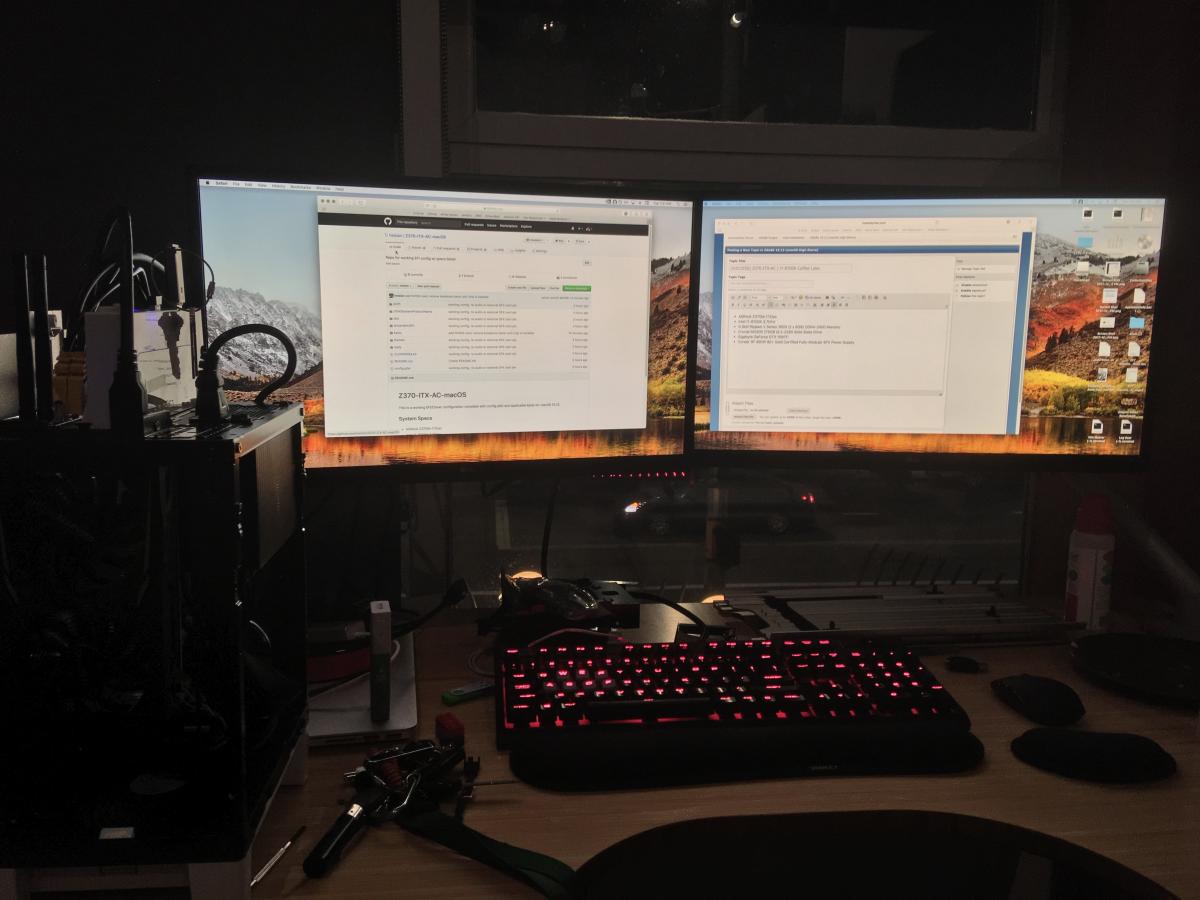

macOS 10.13.2

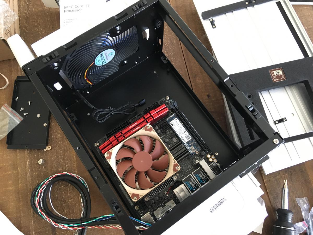

Specs:
  • ASRock Z370M-ITX/ac
  • Intel i7-8700K 3.7GHz
  • G.Skill Ripjaws V Series 16GB (2 x 8GB) DDR4-2400 Memory
  • Crucial MX300 275GB M.2-2280 Solid State Drive
  • Gigabyte GeForce GTX 1050Ti
  • Corsair SF 450W 80+ Gold Certified Fully-Modular SFX Power Supply
Clover EFI folder
Working:
- Computing things
- Sound
- Sleep
- Graphics
- Ethernet
- APFS
- SMBIOS iMac 19,1
Not working:
- Bluetooth/WiFi (did not buy a chip)

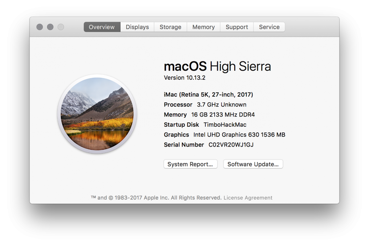

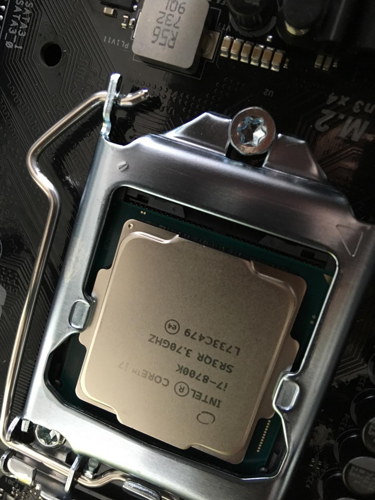

- High Sierra not recognizing i7-8700K as a CPU (see last photo attachment).
I've seen others post screenshots of their 8700K being recognized, but mine didn't end up that way and I dunno why. Regardless, everything seems to work fine so far. Ran Valley, did some coding, etc. See GitHub repo for full config details.
