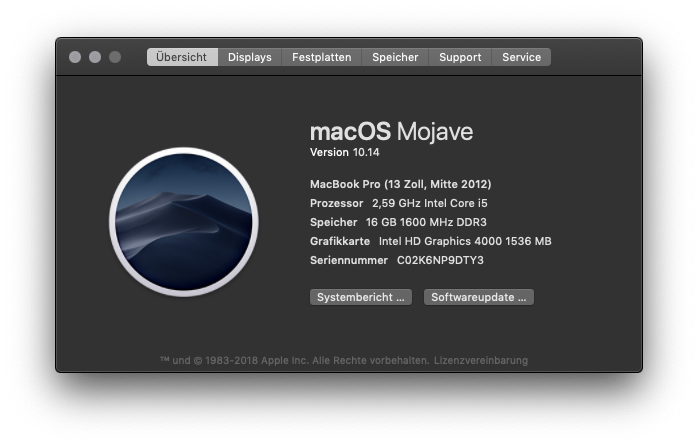

dreadkopp Posted December 7, 2017 Share Posted December 7, 2017 (edited) Just wanted to leave this here since i finally finished this machine. UPDATE: MOJAVE READY: Since informations where a bit hard to find and i encountered a bunch of problems + rehabmans HP Probook scripts leave you with a mess i thought i share my Clover folder with you guys. I came from a MacBookPro9,1 which sadly had a broken GMUX so i needed a replacement. This Elitebook is pretty great with 1600x900 14'' Screen it's basically somewhere between mbp9,1 and mbp9,2 High Res. CPU is upgradable as well as Ram. This config is for the HD4000 version, not the one with the AMD Mobile card. You don't want that since the AMD actually isn't much faster than the HD4000 but eats much more power. With the 55Wh Battery i get roughly 3 hours out of this machine. It's basically the better mbp9,1 for ~200€ You might need to switch the Intel Centurio Wifi for a supported HP Branded Broadcom. HP Broadcom BCM943224HMS workd fine. -> https://github.com/dreadkopp/8470p_10.1x.x FanControl not 100% done but should be okay + I haven'T found a way to make the pointing knob thingy usable yet. Everything else should work fine. SSDT.aml generated for i5 3320m. If you run another CPU you want to replace that one. The slightly faster CPU (100 Mhz base Clock / 200 Mhz Turbo) in the elitebook in comparison with a real mbp9,2 but runnin 10.13.0 : and another screen just for fun : Edited December 2, 2018 by dreadkopp 2 Link to comment https://www.insanelymac.com/forum/topic/330391-hp-elitebook-8470p-the-better-macbookpro/ Share on other sites More sharing options...
