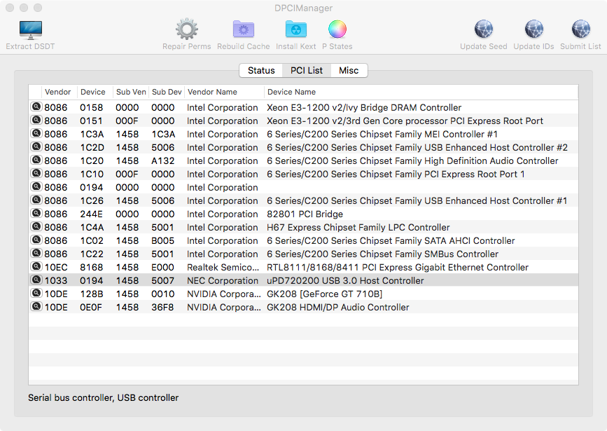

MaLd0n Posted December 6, 2017 Share Posted December 6, 2017 use it DPCIManager.app.zip go to Pci List and check model, ids Link to comment https://www.insanelymac.com/forum/topic/330172-getting-usb3-to-work/#findComment-2545391 Share on other sites More sharing options...
cadash Posted December 7, 2017 Author Share Posted December 7, 2017 Here it is. Link to comment https://www.insanelymac.com/forum/topic/330172-getting-usb3-to-work/#findComment-2545423 Share on other sites More sharing options...
