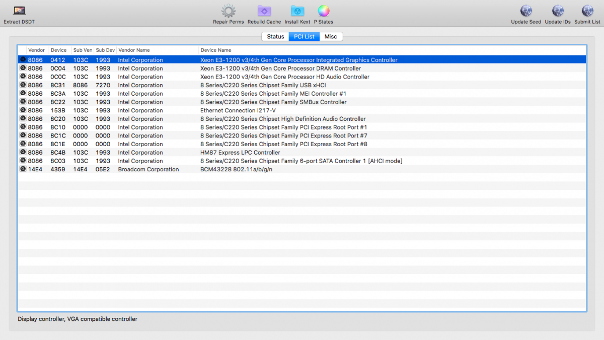

dbFui Posted November 11, 2017 Author Share Posted November 11, 2017 Intanto che aspetto il download e ripeto i tuoi passaggi per l'aggiornamento ti posto lo screen: Link to comment https://www.insanelymac.com/forum/topic/329551-wi-fi-su-hp-650-g1-10131/#findComment-2532914 Share on other sites More sharing options...

dbFui Posted November 11, 2017 Author Share Posted November 11, 2017 Fatto ora sopra Sorry Link to comment https://www.insanelymac.com/forum/topic/329551-wi-fi-su-hp-650-g1-10131/#findComment-2532928 Share on other sites More sharing options...
foskvs Posted November 11, 2017 Share Posted November 11, 2017 Confermo. Non è compatibile. Link to comment https://www.insanelymac.com/forum/topic/329551-wi-fi-su-hp-650-g1-10131/#findComment-2532931 Share on other sites More sharing options...
dbFui Posted November 11, 2017 Author Share Posted November 11, 2017 Ok, grazie ! Proverò con un dongle Wi-Fi USB.... Link to comment https://www.insanelymac.com/forum/topic/329551-wi-fi-su-hp-650-g1-10131/#findComment-2532934 Share on other sites More sharing options...
