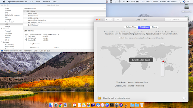

Specifications :
1. Processor : Intel Core i5 7200U (Kaby Lake)
2. RAM : 8GB DDR4 PC17000 (I add 4GB For another slot)
3. Storage : WD Caviar Blue 1TB
4. LAN : Realtek RTL8168
5. Wifi + Bluetooth : The Default Device has been replaced withBroadcom BCM94532Z M.2 NGFF Interface
6. Touchpad : Synaptic Series
7. Codec Audio Chipset : ALC 236 Rev 0x0002
8. Ukuran dan Resolusi Layar : 14" dan 1366 x 768
9. OS : macOS High Sierra 10.13 (17A405) + Windows 10 Enterprise
10. Bootloader : Clover 4243
11. Boot Mode : All OS at UEFI Mode
12. GPU : Intel HD 620 (THERE IS NO NVDIA GPU at my NOTEBOOK)
Tools and Softwares
1. USB FlashDrive with 8GB
2. "Install macOS High Sierra.app" from AppStore, i downloaded 10.13 Latest version
3. Use CreateInstallMedia Command
4. Clover Rev. 4259
5. UEFI Mode Boot
6. Clover Configurator.app Rev. 4.54.0.0
Special Problem :

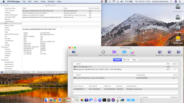

1. We can't change DVMT Pre-Allocation under bios and BIOS has Protected to modifying from shell command,so just use PATCH Binary for "AppleIntelKBLGraphicsFramebuffer" with Clover.
What's working

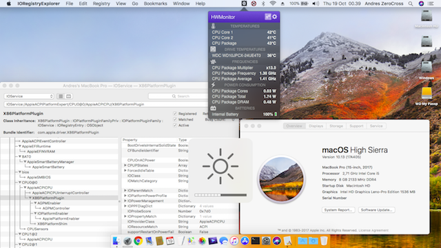

1. Speed Step and HWP
2. Shutdown, Restart
3. All Port USB
4. Camera

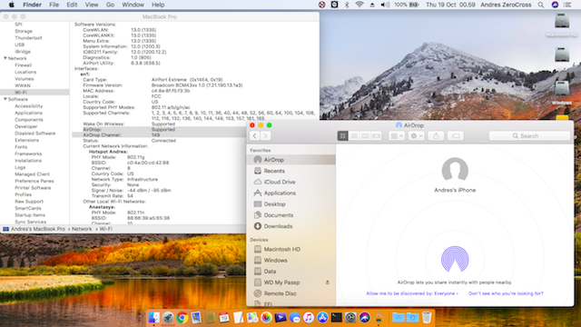

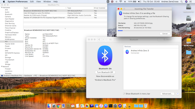

5. Wifi, Bluetooth and AirDrop
6. LAN

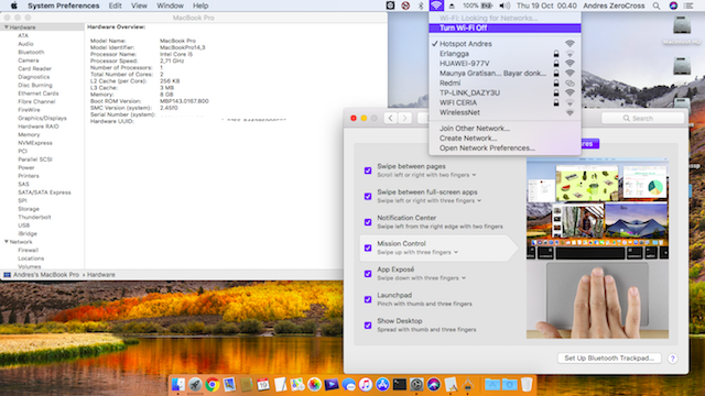

7. Touchpad
8. Fn Brightness with Patch DSDT

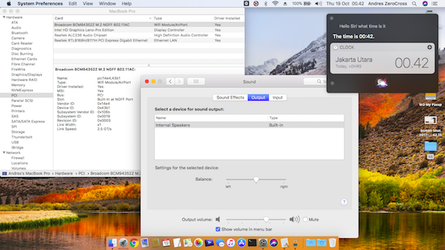

9. Mic dan Audio Output

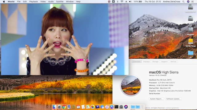

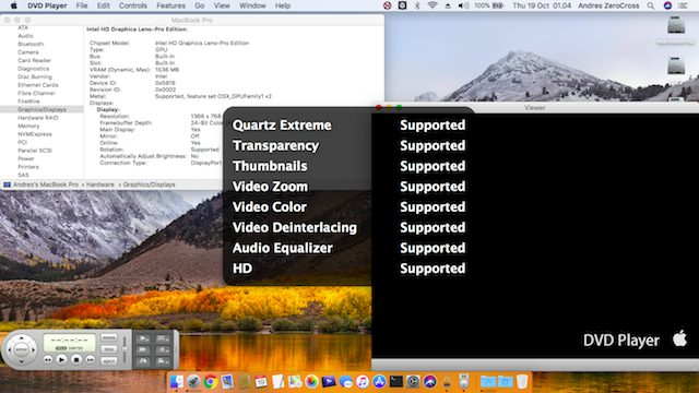

10. QE/CI Graphics
11. Battery Indicator (Manual Patch DSDT)
12. Etc.

9. Now go to Graphics Section and write this value at "ig-platforms-id" 0x591E0000 or 0x591B0000
10. Reboot, and you will get QE/CI for Intel HD 620, Full Working of LAN and Audio
