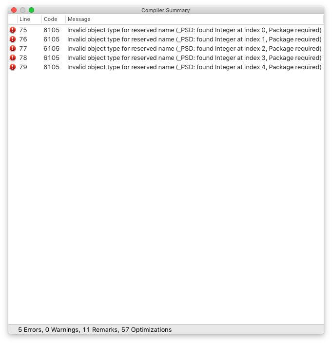

aerz Posted October 21, 2017 Share Posted October 21, 2017 Hi everyone I'm trying to fix the issue about sleep/wake. The problem is that I click on Sleep, the computer goes to sleep well and I wake up by clicking the mouse and I could see the desktop until I start moving the mouse with lag and finally the graphics card crash (frame buffer, I suppose) and the computer restarts itself. On clover I tried different boot flags, but didn't work. Also I tried some common patches on DSDT provided by Clover Configurator, but I can't solve it yet. My Hackintosh configuration: ASRock G31M-S Intel 2 Duo E2200 (Conroe) Gigabyte GeForce GT 210 1GB DDR3 Last thing that I try is get a clean DSDT from terminal: ioreg -arw0 -d1 -c AppleACPIPlatformExpert | xpath /plist/array/dict/dict[2]/data[2]/text\(\) | base64 -D -o ~/Desktop/DSDT.aml Then I opened MaciASL and Patch the DSDT with this: http://olarila.com/files/Packs/ASRock/G31M%20S.txtBut I got some errors on the _PSD (CPU0) method that I can't fix So, I don't know the right way and the next step. I attached origin zip with my OEM ACPI and a dump of "kextstat -k". Any ideas to the next step? Is a good option try to fix the S-States? kextstat.txt origin.zip Link to comment https://www.insanelymac.com/forum/topic/328768-asrock-g31m-s-cant-wake-after-sleep/ Share on other sites More sharing options...

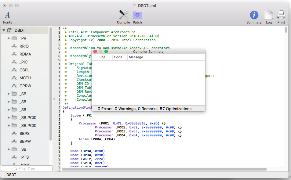

Guest ricoc90 Posted October 21, 2017 Share Posted October 21, 2017 Your DSDT with that patch compiles without issues here. DSDT.aml.zip Link to comment https://www.insanelymac.com/forum/topic/328768-asrock-g31m-s-cant-wake-after-sleep/#findComment-2520412 Share on other sites More sharing options...
aerz Posted October 22, 2017 Author Share Posted October 22, 2017 Your DSDT with that patch compiles without issues here. Schermafbeelding 2017-10-22 om 00.55.33.png DSDT.aml.zip You're right, the DSDT compiles, thanks! Otherwise, the problem about sleep continues. Any ideas about this? Link to comment https://www.insanelymac.com/forum/topic/328768-asrock-g31m-s-cant-wake-after-sleep/#findComment-2520553 Share on other sites More sharing options...
