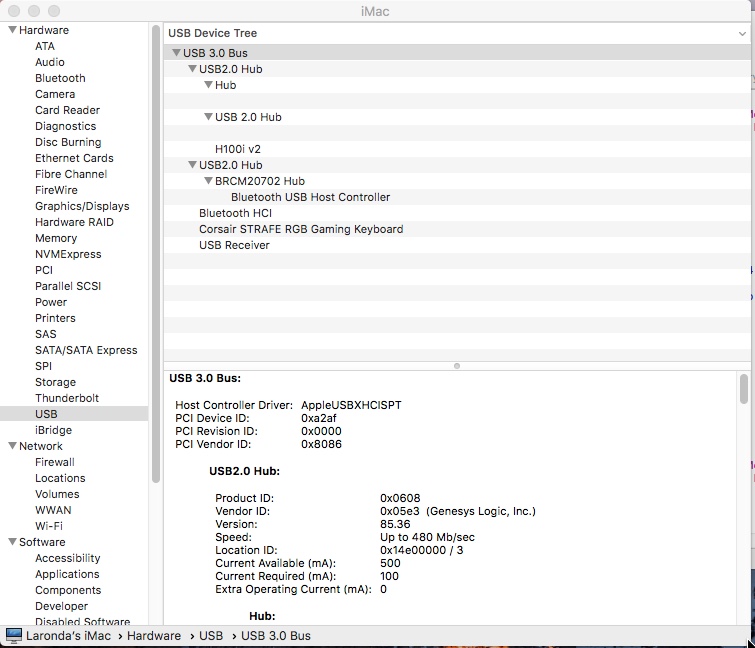

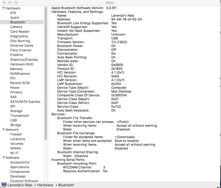

sciblu06 Posted October 20, 2017 Share Posted October 20, 2017 I'm new to this forum. I decide to install MacOS Sierra 10.12.6 on my custom pc. My system board Rog Maximus IX code has wifi and bluetooth builded in. I understood the they would not work. I decide to buy an Apple wifi + BT airport card. The card I have is BCM94360CDAX from Amazon, https://www.amazon.com/gp/product/B012LOT512/?tag=tonymacx86com-20. When I installed PCI-e card the wifi is recognized but not bluetooth. In system information under bluetooth, the manufacturer is unknown. Is there a way to fix it or is my card bad. Link to comment https://www.insanelymac.com/forum/topic/328700-airport-card-bcm94360cdax-bluetooth-doesnt-work/ Share on other sites More sharing options...
sciblu06 Posted October 21, 2017 Author Share Posted October 21, 2017 WOW, I been trying figure out for a whole week why the bluetooth didn't work. My system board Z270 Asus Maximus code IX has wifi and bluetooth built in. Since you mention to disable them. I was able to go into the bios and disable both of them. Lo behold when the hackintosh booting up the bluetooth setting can be turned off and on. I never would have though the built in wifi and bluetooth on the system board would cause so much trouble. Thank you for helping me out. Link to comment https://www.insanelymac.com/forum/topic/328700-airport-card-bcm94360cdax-bluetooth-doesnt-work/#findComment-2519839 Share on other sites More sharing options...
foskvs Posted October 10, 2018 Share Posted October 10, 2018 Your usb configuration is probably wrong. Attach ioreg. Link to comment https://www.insanelymac.com/forum/topic/328700-airport-card-bcm94360cdax-bluetooth-doesnt-work/#findComment-2639934 Share on other sites More sharing options...
