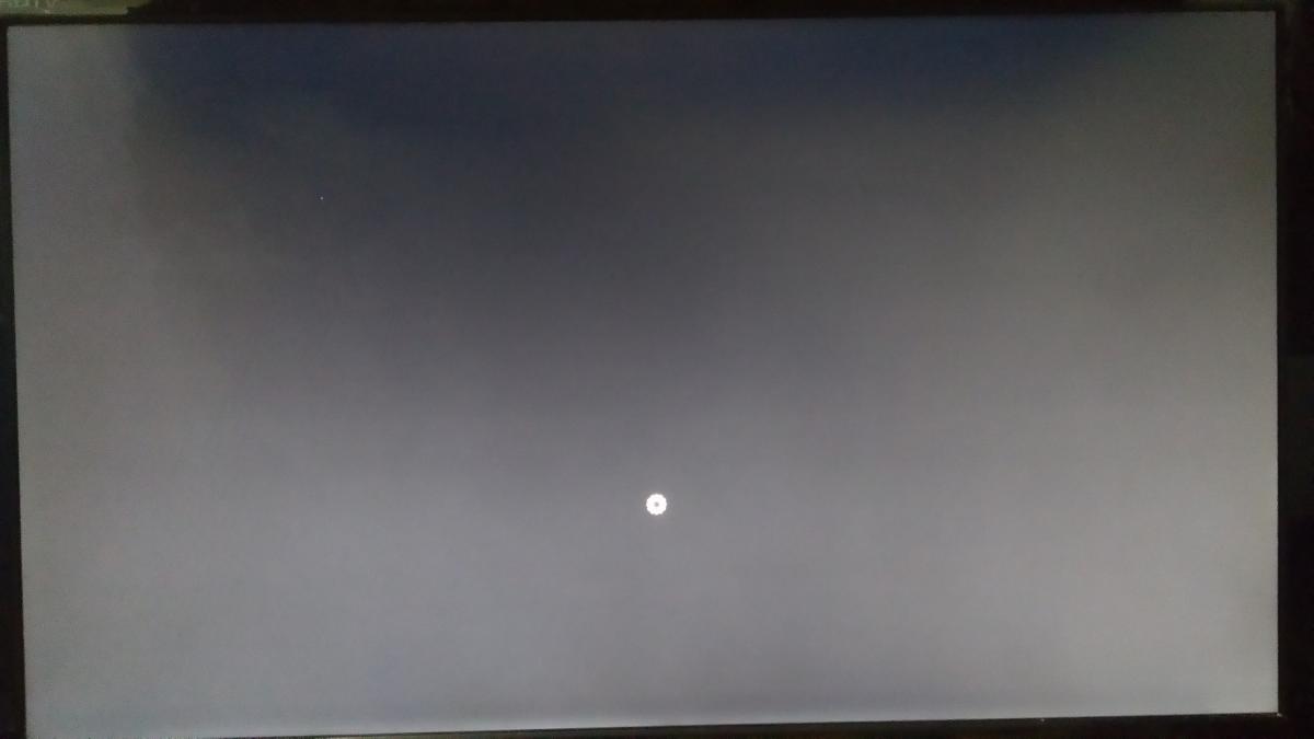

DS-1 Posted October 19, 2017 Share Posted October 19, 2017 Hi guys, I'm having this issue with the hackintosh i5 3570k in the signature. After a Sierra update, the hackintosh rebooted without issues. Then, after another reboot, it stucked, like shown in the picture (white circle running for hours!). Can anyone please help me in restoring the boot?Thanks a lot! Link to comment https://www.insanelymac.com/forum/topic/328667-sierra-hackintosh-stucked-on-white-spinning-circle-after-boot/ Share on other sites More sharing options...
DS-1 Posted October 20, 2017 Author Share Posted October 20, 2017 Solved. I had this issue because of not updated web drivers. So I booted without the "nvidia web drivers" flag and the system booted fine. Then I updated the drivers and everything went fine. Link to comment https://www.insanelymac.com/forum/topic/328667-sierra-hackintosh-stucked-on-white-spinning-circle-after-boot/#findComment-2519368 Share on other sites More sharing options...
