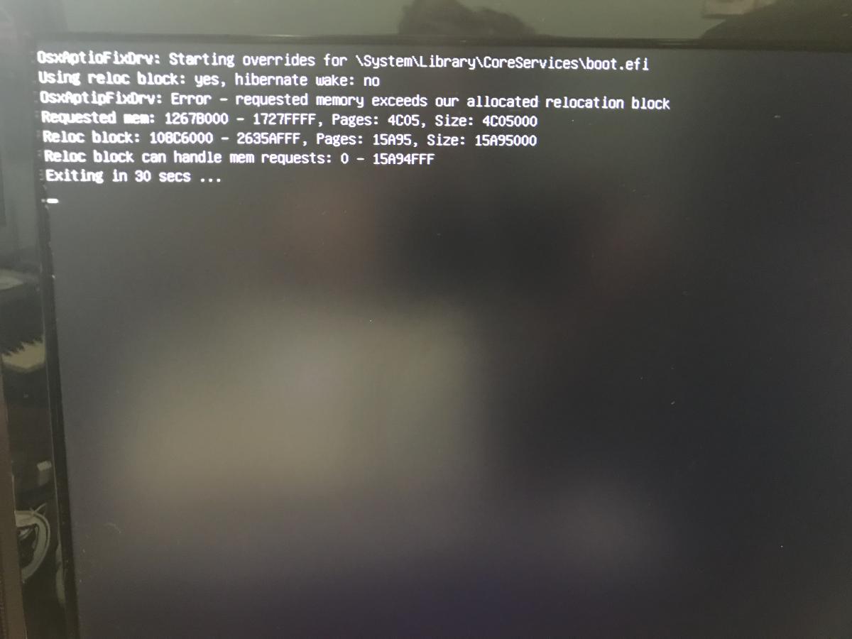

srmusico Posted October 11, 2017 Share Posted October 11, 2017 Hello guys, im trying to install sierra on my new system. 64 GB RAM Crucial Ballistix Sport i7 6850K MSI X99A Gaming 7 1 TB SSD Samsung 500 GB SSD Samsung 1 TB HDD Gigabyte GeForce GTX 1060 G1 Gaming 3GB GDDR5 Im using my Clover Sierra 12.6 USB. i have followed the guide of Metacollin for X99 systems and Broadwell-e . But I can't enter in the installer. https://nickwoodhams.com/x99-hackintosh-osxaptiofixdrv-allocaterelocblock-error-update/ Here is my clover USB folder. EFI.zip Please help me with this jajaja thanks you so much! Link to comment https://www.insanelymac.com/forum/topic/328394-sierra-on-msi-x99a-gaming-7-and-i7-6850k/ Share on other sites More sharing options...
srmusico Posted October 12, 2017 Author Share Posted October 12, 2017 Here is the error when I try to enter in the installer: Link to comment https://www.insanelymac.com/forum/topic/328394-sierra-on-msi-x99a-gaming-7-and-i7-6850k/#findComment-2514218 Share on other sites More sharing options...
Regi Yassin Posted October 12, 2017 Share Posted October 12, 2017 delete test2-2016.efi and OsxAptioFixDrv-64.efi use this instead OsxAptioFix2Drv-free2000.efi.zip 1 Link to comment https://www.insanelymac.com/forum/topic/328394-sierra-on-msi-x99a-gaming-7-and-i7-6850k/#findComment-2514268 Share on other sites More sharing options...

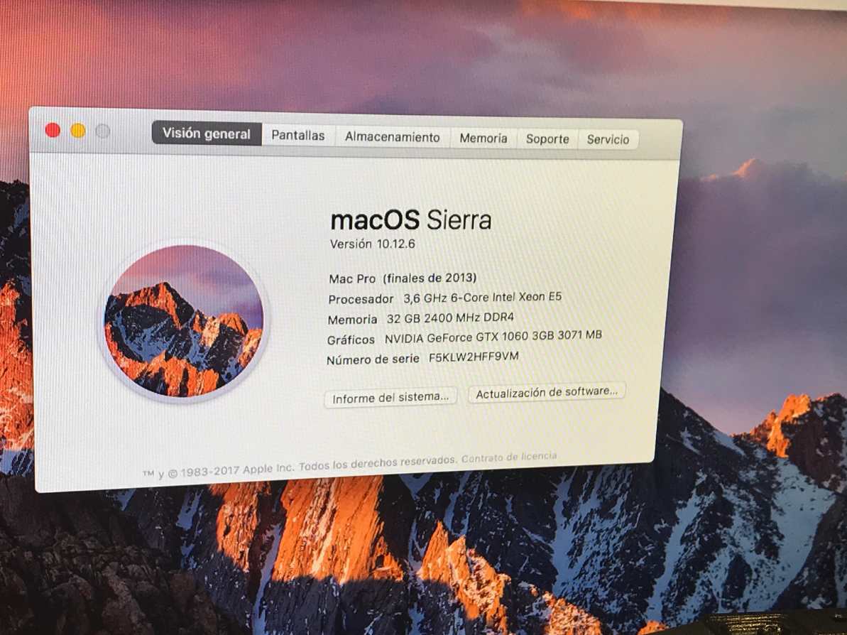

srmusico Posted October 12, 2017 Author Share Posted October 12, 2017 Hello guys!, first of all, thanks you so much for your help. I have tried Regi solution. and I have entered in the installation and now I have it installed!!! The system says that I have an unknown 3,6 GHZ processor. The first part is done. I can boot. Now, could you say me Fabiosun , why is not recommended the first solution?? thanks you so much!!! also , what is 4G in my bios? Link to comment https://www.insanelymac.com/forum/topic/328394-sierra-on-msi-x99a-gaming-7-and-i7-6850k/#findComment-2514356 Share on other sites More sharing options...

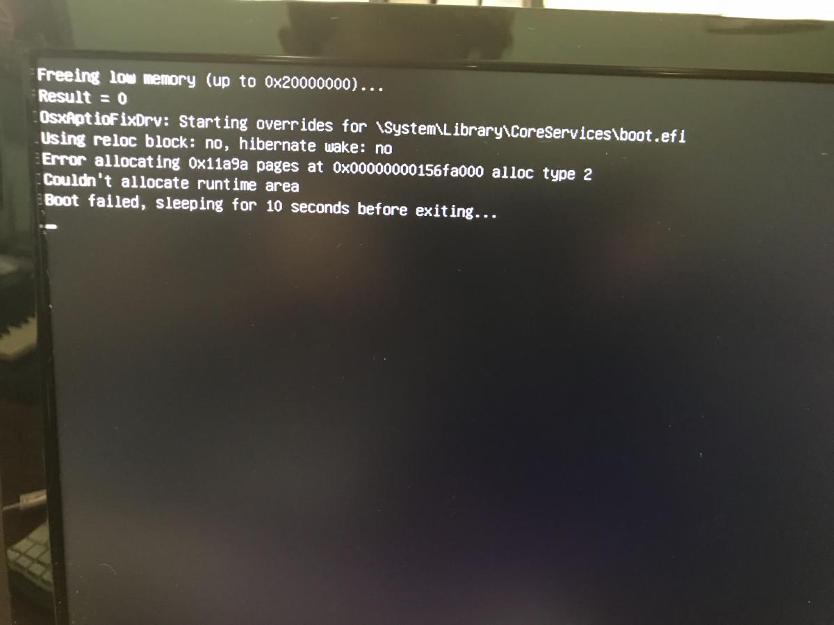

srmusico Posted October 12, 2017 Author Share Posted October 12, 2017 Hello guys. Im having a boot problem when I put the 4 sticks of 64 gb ram I just tried in all of the 8 slots that I have in my MOBO. I can boot with one stick only. if I put the rest I get this error: What do you think? thanks! Link to comment https://www.insanelymac.com/forum/topic/328394-sierra-on-msi-x99a-gaming-7-and-i7-6850k/#findComment-2514385 Share on other sites More sharing options...

Regi Yassin Posted October 12, 2017 Share Posted October 12, 2017 try to use some part of the efi you can find here: http://www.insanelymac.com/forum/topic/316516-macos-sierrahigh-sierra-on-broadwell-eep-not-a-guide-but-maybe-a-working-in-progress/page-1 It should help you in 10.12.6 and also in High Sierra if you update if you want try delete test2-2016.efi and before booting enable in your bios 4g Also Regi. Yassin advice could work but devs and coder like @apianti do not advice to use it i cant boot without it, using OsxAptioFixDrv2-64.efi or OsxAptioFixDrv-64.efi, sometimes its booting, sometimes not, cant remember the exact words, any advice? 1 Link to comment https://www.insanelymac.com/forum/topic/328394-sierra-on-msi-x99a-gaming-7-and-i7-6850k/#findComment-2514422 Share on other sites More sharing options...

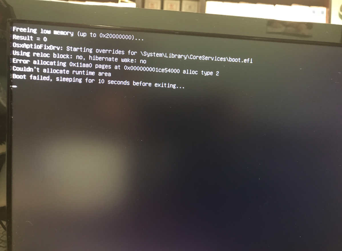

srmusico Posted October 12, 2017 Author Share Posted October 12, 2017 ok so with ccccccc free2000.efi you can install and login? if so install nvidia web driver and before you reboot find on google latest lilu.kext and nvidiadriverfixup and put them in clover/kext/other for now you have to try to have a booting system..then we will try to use right uefidriver64 :-) Hi! I have the 4 16gb sticks in the Pc (64 gb total) Sometimes boot , sometimes not. Only booting with nvda_drv=1 If I don’t use nvda I can’t boot. Only one time have booted with nvidia webdriver working. After ,I have tried again and never. The same error. So, this method as you have said is inestable jajaja . Link to comment https://www.insanelymac.com/forum/topic/328394-sierra-on-msi-x99a-gaming-7-and-i7-6850k/#findComment-2514617 Share on other sites More sharing options...
srmusico Posted October 13, 2017 Author Share Posted October 13, 2017 Ok There is a hope your system could work Positive way to see life above Mmmh I see only 32 gb in description If you have all inserted is bad Negative way to see life If you can do these few things 1) add in your signature your system data 2) write here how you create your usb pen 3) if you know well how you create it, i mean without strange tools Try to boot with it always from an usb 2.0, better not from case but if possible from MSI If you see only 32gb with 64gb inserted in corret way you could have a dimm module defective Let me know In some way you will have a working system Positive way Hello, sorry for the confusion, that image was okey, because was taken when I was testing if all the modules were good. All modules are ok and are recognized by the Pc and the Hackintosh . In that photo I only had 32 inserted (2 modules) About the clover usb, I have two. One with pure clover installation , and one with the hated M. Beast jaja Both upgraded to last clover . And both the same problem . Now I have installed everything in the SSD. Clover also. But with USB configuration , so I have the same problems. I need to get a estable way to boot. Thanks you for your attention! Enviado desde mi iPhone utilizando Tapatalk Link to comment https://www.insanelymac.com/forum/topic/328394-sierra-on-msi-x99a-gaming-7-and-i7-6850k/#findComment-2514788 Share on other sites More sharing options...

srmusico Posted October 16, 2017 Author Share Posted October 16, 2017 Hello Fabio! Thanks for your help, i have found the solution with the amazing help of @mald0n I can boot with emuvariableuefi.efi , test2-2016.efi and oOsxAptioFixDrv.efi and without any problem Thanks again for all the help!! Link to comment https://www.insanelymac.com/forum/topic/328394-sierra-on-msi-x99a-gaming-7-and-i7-6850k/#findComment-2516752 Share on other sites More sharing options...
