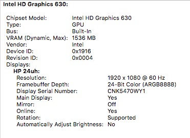

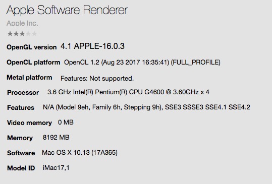

andreamike Posted October 9, 2017 Share Posted October 9, 2017 Hello,I am running High Sierra with Pentium G4600 (Intel HD 630) on MSI B250I.I have tried the FakeID 0x59128086 and ig-platform id 0X59120000 but I was getting the gIOScreenLockState 3.I changed to a FakeID of 0x19168086 and ig-platform of 0x19160000 and is booting using this kext:AppleALC.kext, AtherosE2200Ethernet.kext, CodecCommander.kext, FakePCIID_Intel_HD_Graphics.kext, FakeSMC.kext, IntelGraphicsFixup.kext, IntelMausiEthernet.kext, Lilu.kext, NullCPUPowerManagement.kext, NvidiaGraphicsFixup.kext,, RealtekRTL8111.kext, Shiki.kext, USBInjectAll.kext, WhateverGreen.kext, XHCI-200-series-injector.kextand a FakeCPUID 0x0306A0 for the Pentium processor.OpenGL seams working but my dock bar is not transparent yet.Any help?Thanks,Andrea Link to comment https://www.insanelymac.com/forum/topic/328262-run-intel-hd-630-on-pentium-g4600/ Share on other sites More sharing options...

mneves Posted January 31, 2018 Share Posted January 31, 2018 Did you manage to fix this? I have the same g4600 with HD 630 on High Sierra 10.13.3, but no hardware acceleration and gIOScreenLockState error. Link to comment https://www.insanelymac.com/forum/topic/328262-run-intel-hd-630-on-pentium-g4600/#findComment-2581067 Share on other sites More sharing options...

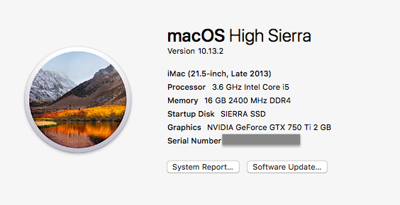

kcfamily Posted February 4, 2018 Share Posted February 4, 2018 Hello,My Friend: My suggestion not to continue testing the PENTIUM G4600 and HD630 on Hackintosh.You will get some error (Path finder,Autocad 2017/2018,Safari,Chrome ,etc). Also caused not to visit certain sites in Safari and Chrome,It is very difficult and not easy to carry out routine tasks. I had changed the graphic card to the Gigabyte GTX750-Ti and Used NVIDIA WebDriver-378.10.10.10.25.103 ,It’s very smooth for 10.13.2 Hackintosh. My Hardware/ Gigabyte H270m-ds3h Pentium G4600 (Disable HD630) Gigabyte GTX750-Ti 2GB 16GB DDR4-2400 WD 250GB SSD 1 Link to comment https://www.insanelymac.com/forum/topic/328262-run-intel-hd-630-on-pentium-g4600/#findComment-2584447 Share on other sites More sharing options...
