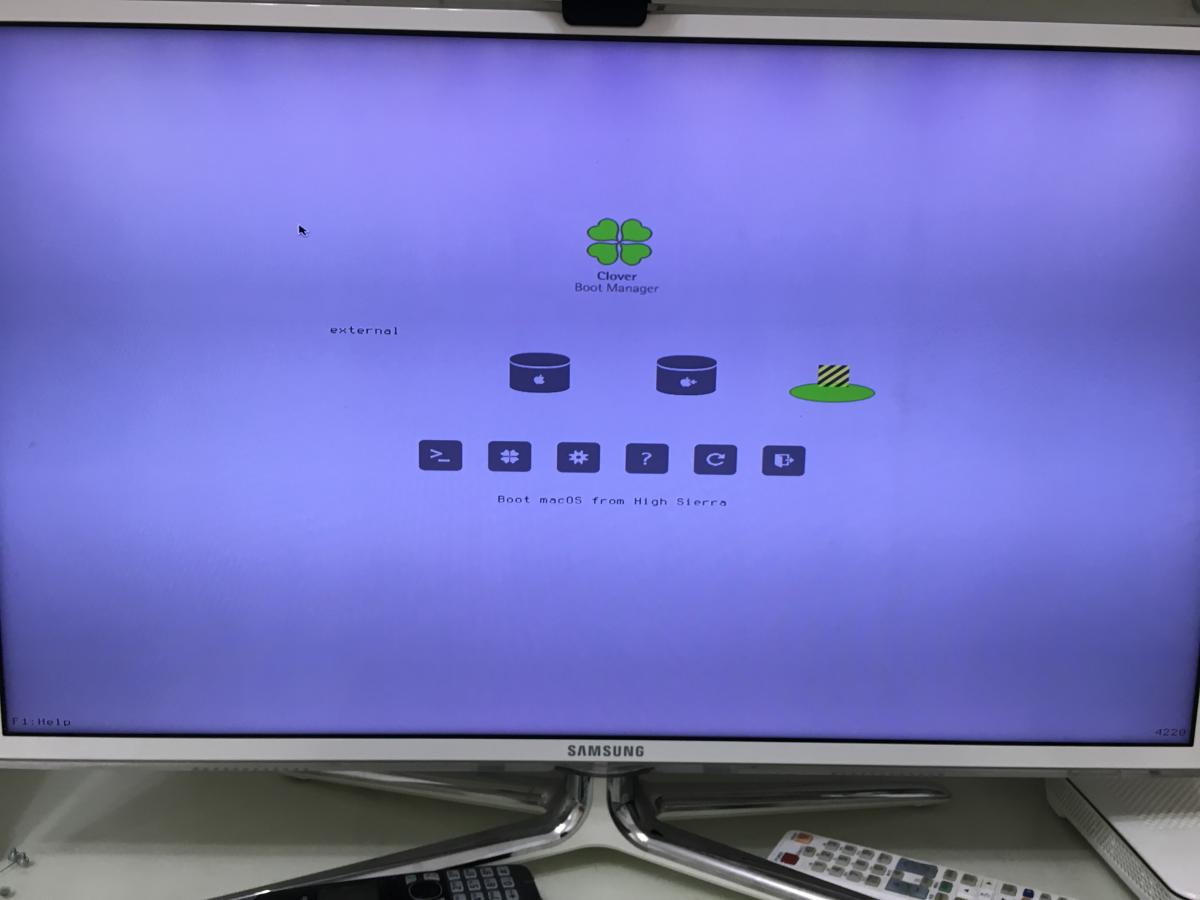

Mario1964 Posted September 28, 2017 Share Posted September 28, 2017 Hello Guys i have a little problem and i need ur help! I install High Sierra on this SSD -as HFS+ it works -after converstion to APFS it won't boot anymore This is how clover recognize it : There's a solution to this ? Thx Link to comment https://www.insanelymac.com/forum/topic/327680-external-ssd-apfs-wont-boot-help/ Share on other sites More sharing options...
Mac-on-PC Posted October 6, 2017 Share Posted October 6, 2017 Yesterday I tried to install High Sierra on an SSD disk. After the installation, HS could not boot. Until I acknowledge that I've added a copy of apfs.efi into the drive64UEFI folder on a legacy bios machine. So I copy / paste the apfs.efi driver from drive64UEFI to drive64 folder in clover and High Sierra could boote without problems. Link to comment https://www.insanelymac.com/forum/topic/327680-external-ssd-apfs-wont-boot-help/#findComment-2509925 Share on other sites More sharing options...
