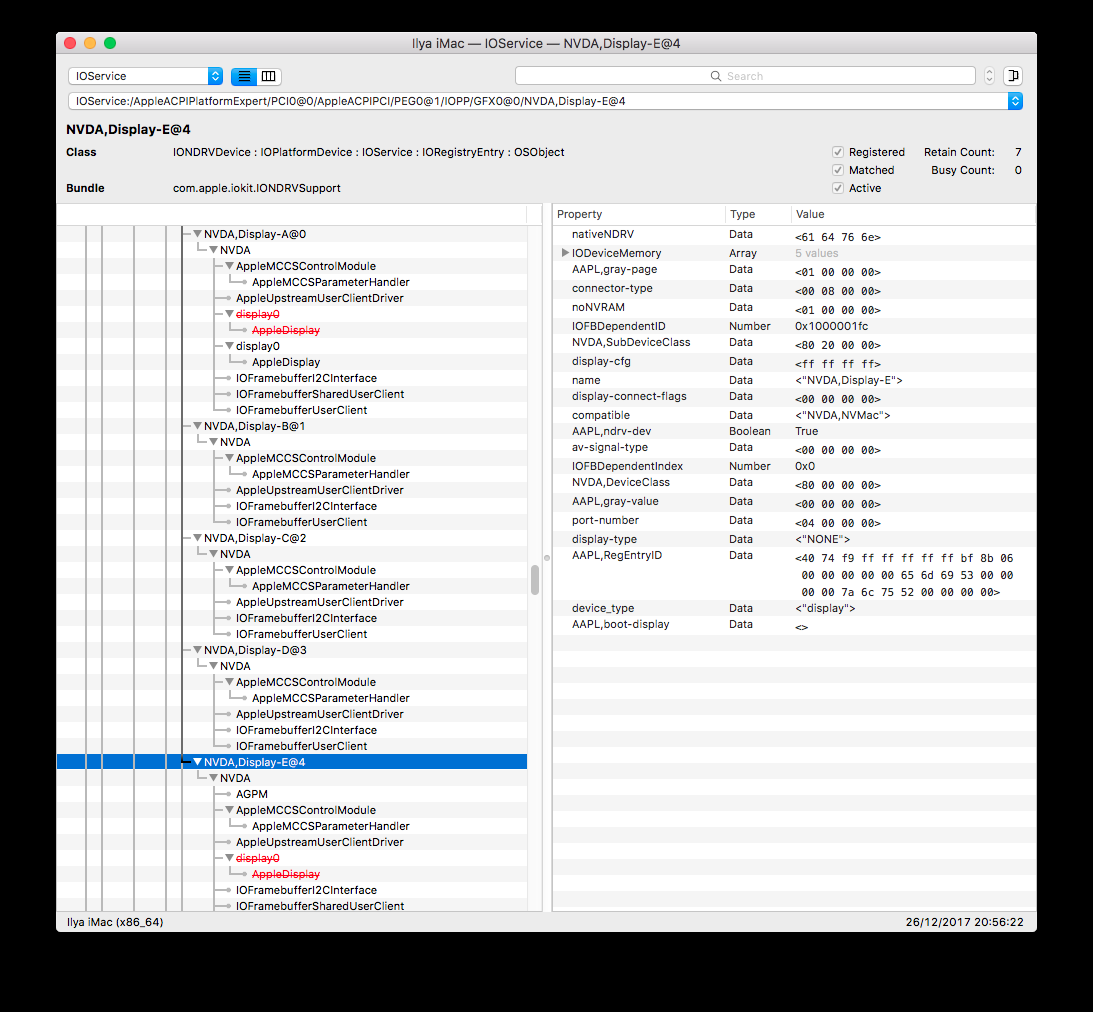

nikitenich Posted January 3, 2018 Share Posted January 3, 2018 I find the solution for Sierra! Inject with arbitary @X,AAPL,boot-display property for your boot display (the one that works in BIOS without the CSM), where X is number of your boot display in ioreg. It is determined by turning off the monitor and checking the ioreg changes. In my case it's 4. In High Sierra this solution doesn't work - black screen on both monitors. <key>Arbitrary</key> <array> <dict> <key>Comment</key> <string>Nvidia Display</string> <key>CustomProperties</key> <array> <dict> <key>Key</key> <string>@4,AAPL,boot-display</string> <key>Value</key> <data> </data> </dict> </array> <key>PciAddr</key> <string>01:00.00</string> </dict> </array> Link to comment Share on other sites More sharing options...
