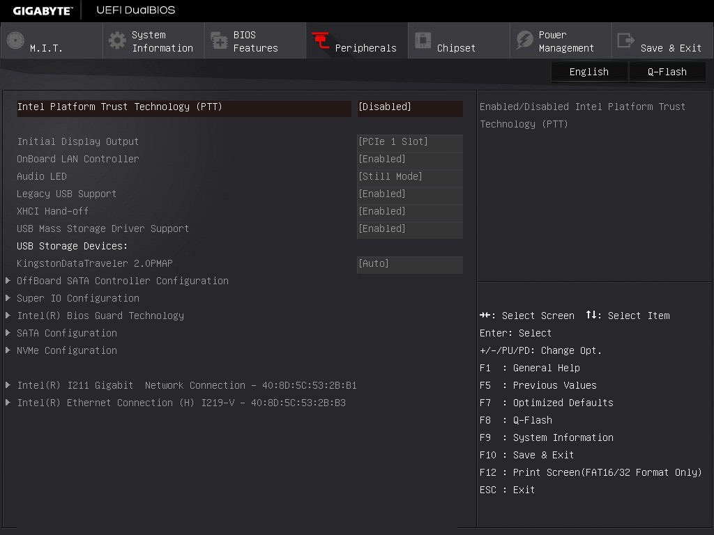

TheShadowKnows Posted September 6, 2017 Author Share Posted September 6, 2017 What are your system specs? Can you put them in your signature line? Do you have a graphics card? Intel i5-6500 GA-Z170X-UD5 RX 480 I still have this issue if I use the iGPU. Link to comment https://www.insanelymac.com/forum/topic/326863-screen-saver-on-10126-keeps-freezing-locking-up-system-and-i-have-to-force-restart/#findComment-2490692 Share on other sites More sharing options...
Gigamaxx Posted September 6, 2017 Share Posted September 6, 2017 Intel i5-6500 GA-Z170X-UD5 RX 480 I still have this issue if I use the iGPU. I have the same setup Can you post your config.plist. Remove serial number if you want. Are bios settings like this? SuperIO or Serial port =disabled CFG Lock =disabled (In CPU settings ) XHCI Handoff =enabled XMP =enabled Link to comment https://www.insanelymac.com/forum/topic/326863-screen-saver-on-10126-keeps-freezing-locking-up-system-and-i-have-to-force-restart/#findComment-2490700 Share on other sites More sharing options...
