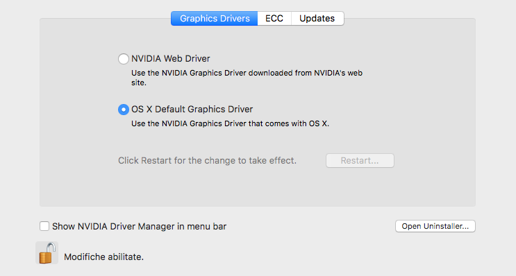

Gian Maverick Posted May 14, 2017 Share Posted May 14, 2017 Hello I am on a small hackintosh running 10.12.4 on z170i Pro gaming with Evga Gtx 1070. I installed the last Nvidia driver (Nvidia WebDriver-378.05.05.05f02), I modified the plist too as Nvidia says like this, but with no luck: <key>SystemParameters</key> <dict> <key>InjectKexts</key> <string>Yes</string> <key>InjectSystemID</key> <true/> <key>NvidiaWeb</key> <true/> </dict> The system start, I have the Nvidia driver manager panel, the driver doesn't work... It always hold on "OS X Default Graphics Driver" and if I switch to Nvidia web driver and restart, nothing happen and it start with the OS X default driver. Do you have any advise I can do to fix this problem? I also have the onboard Wifi and Bluethoot not working, but may be I have to open another topic for this.. P.s. I attached my .plist file config.plist.zip Link to comment https://www.insanelymac.com/forum/topic/323649-nvidia-webdriver-378050505f02-pascal-not-working-on-z170i-pro-gaming/ Share on other sites More sharing options...
vusun123 Posted May 14, 2017 Share Posted May 14, 2017 Hello I am on a small hackintosh running 10.12.4 on z170i Pro gaming with Evga Gtx 1070. I installed the last Nvidia driver (Nvidia WebDriver-378.05.05.05f02), I modified the plist too as Nvidia says like this, but with no luck: <key>SystemParameters</key> <dict> <key>InjectKexts</key> <string>Yes</string> <key>InjectSystemID</key> <true/> <key>NvidiaWeb</key> <true/> </dict> The system start, I have the Nvidia driver manager panel, the driver doesn't work... It always hold on "OS X Default Graphics Driver" and if I switch to Nvidia web driver and restart, nothing happen and it start with the OS X default driver. Do you have any advise I can do to fix this problem? I also have the onboard Wifi and Bluethoot not working, but may be I have to open another topic for this.. P.s. I attached my .plist file You have to install EmuVariable efi driver from the Clover package in order for it to work 1 Link to comment https://www.insanelymac.com/forum/topic/323649-nvidia-webdriver-378050505f02-pascal-not-working-on-z170i-pro-gaming/#findComment-2423250 Share on other sites More sharing options...
