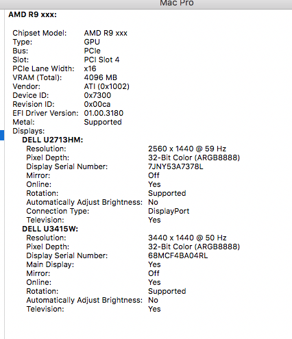

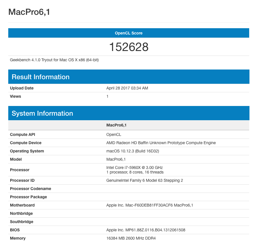

surfinchina Posted April 30, 2017 Share Posted April 30, 2017 I'm there with a fully accelerated nano with 64 compute units (thanks okrasit!) which boots with no helper card or igpu (thanks again okrasit . But the ports are bothering me. My 27" screen can work on any port but the 34" screen only works on HDMI. Am I missing something? Link to comment https://www.insanelymac.com/forum/topic/323282-r9-nano-dp-and-screen-size-weirdness/ Share on other sites More sharing options...
surfinchina Posted May 12, 2017 Author Share Posted May 12, 2017 I fixed it. The big screen was on DP1.2 so I changed it in the screen menu to DP1.1 and it's fine now. Link to comment https://www.insanelymac.com/forum/topic/323282-r9-nano-dp-and-screen-size-weirdness/#findComment-2422164 Share on other sites More sharing options...
