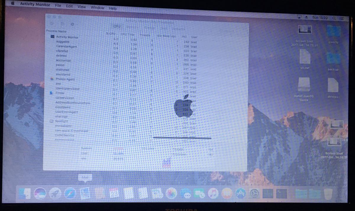

Foxic Posted April 23, 2017 Share Posted April 23, 2017 Hi everyone, I'm stuck and hoping someone has run into this and solved it.I'm trying to get sierra running on a p750, specs:Sandy bridge i3 2350mHd3000 graphics 8086 0116 (should be native)Nvidia 540 (probably won't work, don't care)Low res screen (not dual link)Atheros ar9285Realtek Ethernet Full spec: http://www.toshiba.co.uk/discontinued-products/satellite-p750-15l/ I've got Sierra and clover installed (r4061) but I boot to a black screen, type password, hit enter and I'm at the desktop. But its glitchy as hell. I've just tried to install clover on the hard drive. Double clicked it, I got half an installer icon on the dock and everything's frozen. The mouse still works at full speed but can't click anything. Everything is also massively hot. HWMonitor half opened enough for me to see the cpu multiplier change from 22 to 8, temps were 75 C and voltages looked realistic. Could it just be throttling due to the heat? AppleLPC is loaded, and I had AppleIntelCPUPowerManagement ready in verbose boot. Original dsdt and patched attached along with config.plist. Any help would be greatly appreciated. Thanks config.plist.zip P750 DSDT.zip Bradley’s MacBook Pro IOReg.zip Kextstat.txt 1 Link to comment https://www.insanelymac.com/forum/topic/323115-toshiba-satellite-p750-15l-1012/ Share on other sites More sharing options...
Foxic Posted April 23, 2017 Author Share Posted April 23, 2017 Lump of fluff removed from the fan so it can now spin. Temps reduced. Still have glitches and non-responsiveness. Typing in terminal it'll randomly stop updating the text and i have to click to another window and back to terminal to get it to update. 1 Link to comment https://www.insanelymac.com/forum/topic/323115-toshiba-satellite-p750-15l-1012/#findComment-2410797 Share on other sites More sharing options...
Foxic Posted April 26, 2017 Author Share Posted April 26, 2017 If I sleep and wake the system the system lag/graphics lag goes away. Booting with disable intel idle state enabled in clover makes no difference. 1 Link to comment https://www.insanelymac.com/forum/topic/323115-toshiba-satellite-p750-15l-1012/#findComment-2412246 Share on other sites More sharing options...

MaLd0n Posted April 26, 2017 Share Posted April 26, 2017 Check CLOVER.zip the first releases of sierra, Hd3000 have Glitches, but if u update system....done. if u update to 10.12.4, need Clover Clover_v2.4k_r4049.zip Check if ur Nvidia GPU is disable now 1 Link to comment https://www.insanelymac.com/forum/topic/323115-toshiba-satellite-p750-15l-1012/#findComment-2412582 Share on other sites More sharing options...
Foxic Posted April 26, 2017 Author Share Posted April 26, 2017 Hi MaLd0n, thanks for that, I'll give it a go this evening. I should be on 10.12.4 (App Store installer from about 2 weeks ago) and I'm using clover r4061, r4049 wouldn't boot at all following the initial install, I just got a black screen post boot and pre desktop. The only way I can disable the nvidia card is with disable_nvidia=1, there's no facility within the bios and I'm not having much luck finding an unlocked version 1 Link to comment https://www.insanelymac.com/forum/topic/323115-toshiba-satellite-p750-15l-1012/#findComment-2412603 Share on other sites More sharing options...
MaLd0n Posted April 26, 2017 Share Posted April 26, 2017 i disable GPU in DSDT, need test let me know 1 Link to comment https://www.insanelymac.com/forum/topic/323115-toshiba-satellite-p750-15l-1012/#findComment-2412726 Share on other sites More sharing options...
Foxic Posted April 26, 2017 Author Share Posted April 26, 2017 Thanks MaLd0n, I still have the system lag on most boots until after a sleep cycle (sometimes its ok straight away, no reason or rhyme to it). The battery icon was available earlier but following a reboot won't stick around when enabled. Working: Audio output via internal speakers Ethernet Camera Trackpad works but System Preferences shows No Trackpad Found - Fixed with SmartTouchpad v4.6.5 Keyboard works USB3 Works (recognised) HD3000 QE/CI Wake from 'sleep' (see below) SD card slot (recognised) Not working: Wifi Bluetooth Mic Sleep puts the machine to sleep but it wakes a second or 2 later with a black screen, sits there for a while with fans spinning then auto sleeps again and repeats. Oddities The hardware buttons (Wifi, volume up/down/mute) work but also function as eject at the same time. Link to comment https://www.insanelymac.com/forum/topic/323115-toshiba-satellite-p750-15l-1012/#findComment-2412770 Share on other sites More sharing options...
