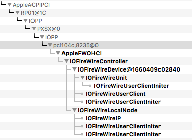

Funky frank Posted April 6, 2017 Share Posted April 6, 2017 Hi, After upgrade to 10.12.4, the firewire driver seems to block the OS as soon as my speakers turn to off automatically. In this moment the firewire audio interface seem to block. This was no problem in OSX 10.9.4 Current interrupts are: This is the nodes it attaches to: Or is this maybe related to a power management on the firewire bus? Any idea? Link to comment https://www.insanelymac.com/forum/topic/322574-changing-firewire-interrupts-stuttering-firewire/ Share on other sites More sharing options...

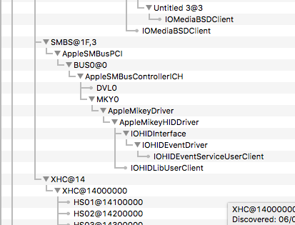

Funky frank Posted April 6, 2017 Author Share Posted April 6, 2017 Hm, no. Can you tell me what you did exactly change? Because it turns out that the HPET device already was in the ACPI, in exactly the same way. It seems that the ATI gfx and the firewire PCIe using the same IRQ... Maybe I should simply place the firewire PCIe to another slot? Also I have a question regarding the SBUS device: Your entry has this method: Method (_DSM, 4, NotSerialized) // _DSM: Device-Specific Method { If (LEqual (Arg2, Zero)) { Return (Buffer (One) { 0x03 }) } Return (Package (0x02) { "address", 0x57 }) } While rehab man provides this ssdt dix: Method (_DSM, 4, NotSerialized) // _DSM: Device-Specific Method { If (LNot (Arg2)) { Return (Buffer (One) { 0x57 }) } Return (Package (0x02) { "address", 0x57 }) } So its returning different values, it seems... What does that mean? Link to comment https://www.insanelymac.com/forum/topic/322574-changing-firewire-interrupts-stuttering-firewire/#findComment-2399853 Share on other sites More sharing options...
MaLd0n Posted April 6, 2017 Share Posted April 6, 2017 test both patches and check kextstat | grep SMBus need return Last login: Thu Apr 6 15:27:16 on console MaLd0n:~ mald0n$ kextstat | grep SMBus 44 1 0xffffff7f81d87000 0x4000 0x4000 com.apple.iokit.IOSMBusFamily (1.1) 185F0EBF-0262-3370-BD47-8FE4C8AA726E 86 2 0xffffff7f82979000 0x12000 0x12000 com.apple.driver.AppleSMBusController (1.0.18d1) C90534F9-E82B-347A-B4CB-9D3303F4653C 113 0 0xffffff7f82976000 0x3000 0x3000 com.apple.driver.AppleSMBusPCI (1.0.14d1) B290F731-FAA9-305D-943A-707BB224E53E MaLd0n:~ mald0n$ today i'm using full sbus with mikey driver btw check patches and usefull links here http://www.insanelymac.com/forum/topic/235523-dsdt-auto-patcher/ and here http://olarila.com/forum/viewtopic.php?f=19&t=385 years 2008/2012 just put in repository, check repository and patch there the original patch is... into method label _DSM parent_adr 0x001F0003 remove_entry; into device name_adr 0x001F0003 insert begin Device (BUS0)\n {\n Name (_CID, "smbus")\n Name (_ADR, Zero)\n Device (DVL0)\n {\n Name (_ADR, 0x57)\n Name (_CID, "diagsvault")\n Method (_DSM, 4, NotSerialized)\n {\n Store (Package (0x02)\n {\n "address", \n 0x57\n }, Local0)\n DTGP (Arg0, Arg1, Arg2, Arg3, RefOf (Local0))\n Return (Local0)\n }\n }\n } end just remove DTGP Link to comment https://www.insanelymac.com/forum/topic/322574-changing-firewire-interrupts-stuttering-firewire/#findComment-2399867 Share on other sites More sharing options...
Funky frank Posted April 6, 2017 Author Share Posted April 6, 2017 Hm this is interesting: With both patches the same kexts, BUT with your variant (returning 0x03), the system becomes quite unstable even while ssd accessing. It even hard resets. Link to comment https://www.insanelymac.com/forum/topic/322574-changing-firewire-interrupts-stuttering-firewire/#findComment-2399871 Share on other sites More sharing options...
MaLd0n Posted April 6, 2017 Share Posted April 6, 2017 This problem has nothing to do with sbus if u dont use dtgp, need use it If (LEqual (Arg2, Zero)) { Return (Buffer() { 0x03 } ) } Return (Package() Link to comment https://www.insanelymac.com/forum/topic/322574-changing-firewire-interrupts-stuttering-firewire/#findComment-2399874 Share on other sites More sharing options...
