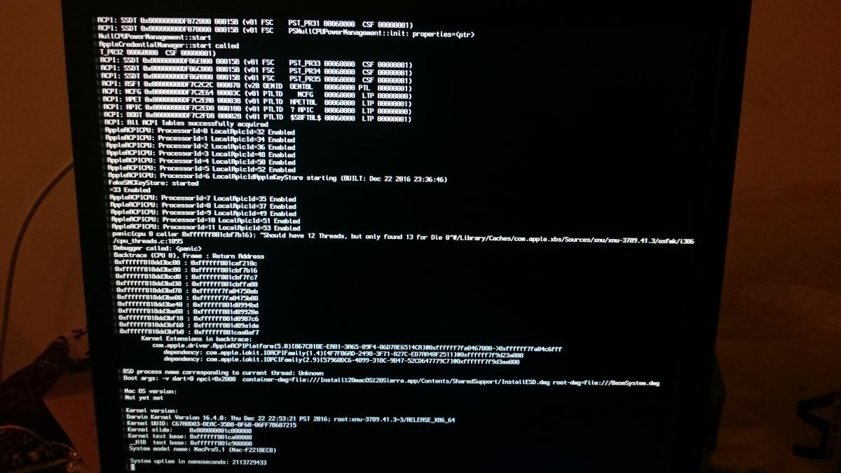

waqy Posted March 25, 2017 Share Posted March 25, 2017 Hi guys, got a Fujitsu R570-2 desktop computer. It's got an Intel Xeon L5640 with 6 cores and 12 threads at 2.3GHz. Despite being able to make a couple of hackintosh machines over the last couple of years, I just can't seem to boot into the Sierra installer using Clover EFI. I've used a variety of flags ( -v, -s, cpus=1, -x, maxmem=4096, etc) but I can't seem to get into the installer. The predominant error message is always "Should have 12 threads, only found 13" This occurs with any number if I have multithreads disabled or core numbers reduced in the BIOS settings as well. Is this processor even supported? Should I be using somethign else apart from Clover? Your help would be very much appreciated. 1 Link to comment https://www.insanelymac.com/forum/topic/322158-intel-xeon-l5640-sierra-kernel-panic-booting-into-installer/ Share on other sites More sharing options...

waqy Posted March 25, 2017 Author Share Posted March 25, 2017 Have replaced full folder, but same error unfortunately: Link to comment https://www.insanelymac.com/forum/topic/322158-intel-xeon-l5640-sierra-kernel-panic-booting-into-installer/#findComment-2391527 Share on other sites More sharing options...

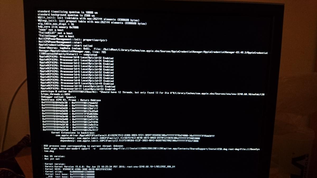

waqy Posted March 26, 2017 Author Share Posted March 26, 2017 https://www.google.de/amp/s/mackonsti.wordpress.com/2012/02/13/extract-dsdt-using-ubuntu-live-cd/amp/ When you get your dsdt attach It along with your config.plist for the very Frist Time you have to use macbook pro 7.2 SMBios After the Installation you can Change It to macpro 5.1 I managed to extract the tables through Ubuntu. I then ran it through MaciASL and then googled any errors I had and now there isn't any. I've attached the DSDT.aml and config as well. Edit: As a last resort, I used my macbook pro to install Sierra on to the hard drive of the desktop via a usb caddy. I then put the drive in the computer but I still get the same kernel error unfortuately Archive.zip 1 Link to comment https://www.insanelymac.com/forum/topic/322158-intel-xeon-l5640-sierra-kernel-panic-booting-into-installer/#findComment-2391930 Share on other sites More sharing options...

waqy Posted March 27, 2017 Author Share Posted March 27, 2017 Try this dsdt So I copied those files to my USB. Now getting the following error, although no kernel panics (yet) According to the SMBIOS this machine is : 1 Link to comment https://www.insanelymac.com/forum/topic/322158-intel-xeon-l5640-sierra-kernel-panic-booting-into-installer/#findComment-2392617 Share on other sites More sharing options...
Rocky12 Posted March 27, 2017 Share Posted March 27, 2017 change the SMBios to MacBook 7.1 or 7.2 2 Link to comment https://www.insanelymac.com/forum/topic/322158-intel-xeon-l5640-sierra-kernel-panic-booting-into-installer/#findComment-2392620 Share on other sites More sharing options...
waqy Posted March 27, 2017 Author Share Posted March 27, 2017 change the SMBios to MacBook 7.1 or 7.2 Macbook Pro 7.1 or Macbook Air 7.2?? I changed it to 7.2 and the kernel panic comes back again 1 Link to comment https://www.insanelymac.com/forum/topic/322158-intel-xeon-l5640-sierra-kernel-panic-booting-into-installer/#findComment-2392626 Share on other sites More sharing options...
