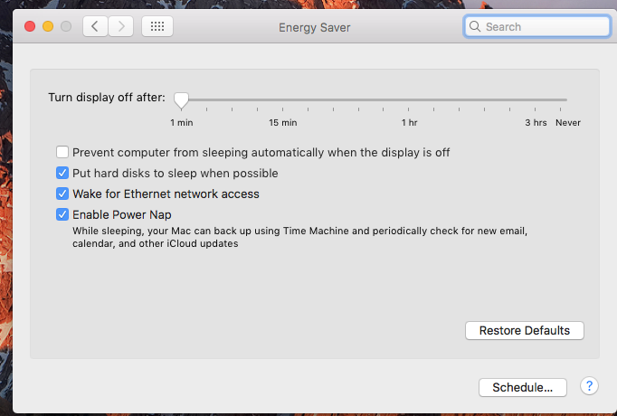

kobe80 Posted March 23, 2017 Share Posted March 23, 2017 Hi friends, Every time my machine goes to sleep, it just reboots. Any ideas? Wondering if there's a bios setting or config file edit, or kext to install.. System:Asus X99-A USB 3.1 5960X (8-core, 3.0 ghz) Clover Sierra 10.12.3 Screenshot of settings attached. Link to comment https://www.insanelymac.com/forum/topic/322106-x99-a-reboots-on-sleep/ Share on other sites More sharing options...
mfc88 Posted March 23, 2017 Share Posted March 23, 2017 Hi friends, Every time my machine goes to sleep, it just reboots. Any ideas? Wondering if there's a bios setting or config file edit, or kext to install.. System: Asus X99-A USB 3.1 5960X (8-core, 3.0 ghz) Clover Sierra 10.12.3 Screenshot of settings attached. Could be multiple factors, but let's try this... 1. In your config.plist boot arguments, set "Darkwake=0" 2. Just add the attached kext to your EFI->CLOVER->kexts->10.12 folder 3. Reboot. 4. Try sleep. If not, you may need USBs properly set up and with power options. And/or you're missing CPU power management. I personally don't use sleep because it's so unreliable. Sometimes it works perfectly fine, sometimes it corrupts keychain and sometimes it causes a CPU kernel panic. VoodooTSCSync.kext.zip Link to comment https://www.insanelymac.com/forum/topic/322106-x99-a-reboots-on-sleep/#findComment-2389773 Share on other sites More sharing options...
kobe80 Posted March 23, 2017 Author Share Posted March 23, 2017 i already had VoodooTSCSync, but i changed config.plist to darkwake=0 & it didn't fix it. :/ Link to comment https://www.insanelymac.com/forum/topic/322106-x99-a-reboots-on-sleep/#findComment-2389787 Share on other sites More sharing options...
