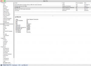

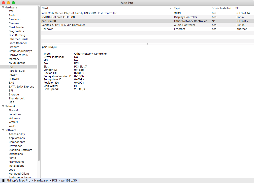

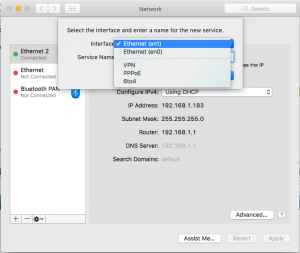

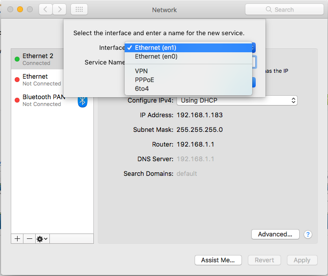

fluxus123 Posted March 16, 2017 Share Posted March 16, 2017 Hello bright community! I have just got myself a WiFi card with Atheros AR3980 chipset (devID 168c,30 - Sub Ven 106b Sub Dev 009a), which I thought was supposed to work out of the box(?), as it's the same that Apple uses natively (checked the info.plist in AirportAtheros40.kext)(?) I plugged in the card, restarted, then tried to set it up in System Pref under Network by adding the device with the "+" but WIFI doesn't show up, only my 2x ethernet ports and bluetooth. In system profiler under PCI I just see this: pci168c,30: Type: Other Network Controller Driver Installed: No MSI: No Bus: PCI Slot: PCI Slot 7 Vendor ID: 0x168c Device ID: 0x0030 Subsystem Vendor ID: 0x106b Subsystem ID: 0x009a Revision ID: 0x0001 Link Width: x1 Link Speed: 2.5 GT/s When using Kextstat in Terminal it tells me that the corresponding kexts are loaded: 113 1 0xffffff7f82998000 0xe6000 0xe6000 com.apple.iokit.IO80211Family (1200.12.2) A08E69B1-9559-358F-A363-9083B344DA10 <112 50 22 8 7 6 5 4 3 1> 114 0 0xffffff7f82a7e000 0x14c000 0x14c000 com.apple.driver.AirPort.Atheros40 (700.74.5) 448A2423-55B3-3033-BE5F-CB19CB92D35E <113 50 12 7 5 4 3 1> In IOReg it shows to be connected under an odd tree/device/address - not the usual I have seen (RP0x etc) I have attached the IOReg file below. Do I need to edit my dsdt to make this work? I have attached my current DSDT as well. Oh, turning on dsdt mask for Lan and Wifi in clover also didn't work. Hitting a brick wall here. Thanks a lot for all your helpful comments and suggestions already! Atheros Issue IORegistry.zip DSDT.aml.zip Link to comment https://www.insanelymac.com/forum/topic/321929-atheros-ar3980-supposed-to-work-oob/ Share on other sites More sharing options...

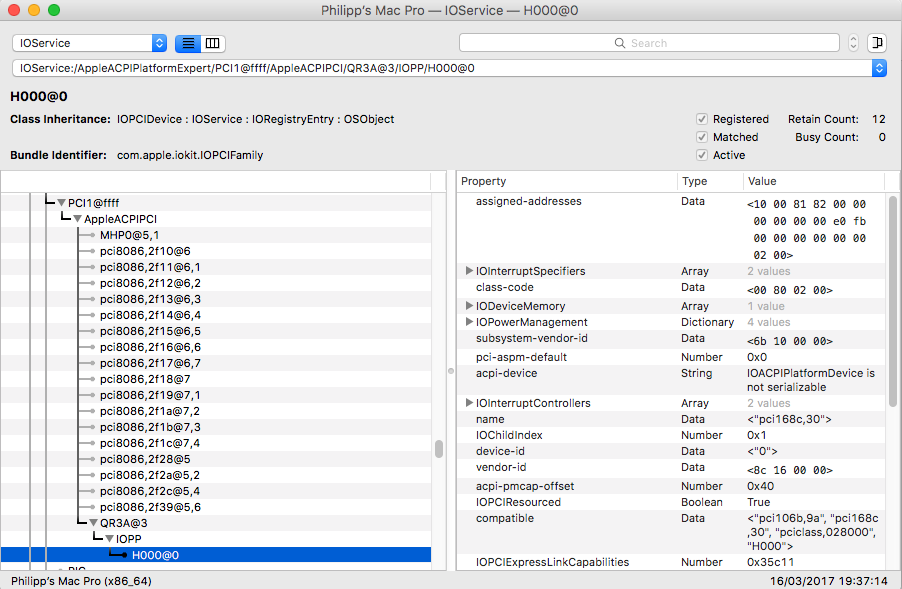

fluxus123 Posted March 16, 2017 Author Share Posted March 16, 2017 'not sure why you've posted twice the same thread. User error I guess... AR9380-based wireless cards normally work OOB indeed. http://forum.osxlatitude.com/index.php?/topic/2120-inventory-of-supported-and-unsupported-wireless-cards/ The kexts may not load for several reasons: 1) hardware disabled in BIOS 2) unwanted/incorrect kext patch 3) clashing multiple copies of the kext 4) erroneous entry in boot loader config I cannot see anything wrong in the DSDT that would block the card from working. You could try to rename device H000 to ARPT, but it should not make any difference. Maybe you can post a zipped copy of your Clover EFI folder that contains config.plist + injected kexts... Hi Hervé! Thanks for your reply! ...double posting??? When I pressed the post new thread button the first time nothing happened. Was a bit like a frozen browser. When I clicked it again the loading bar started doing something and successfully posted. Not sure what happened... Thanks for your suggestions. "The kexts may not load for several reasons:" using kextstat shows that the Atheros40.kext is actually loaded (see first post) 1. I cannot remember having anything disabled in BIOS relating to WiFi 2. no kext patch done in config relating to this, at least i don't think so, as never needed it before, ethernet was working out of the box and I only just got the card. Config.plist is attached to confirm 3. I don't have any additional copies of the kext. 4. as in 2. not that I am aware off, but what do I know... config.plist is attached. If you spot any anomalies it would be great to know! I am not injecting any kexts, other than fakesmc and RehabMan/Slice HW sensors. "Other" folder is empty too. If there is nothing wrong in DSDT then it must be bios, or config.plist I guess? any other digging I could do via terminal by grepping for things? config.plist.zip Link to comment https://www.insanelymac.com/forum/topic/321929-atheros-ar3980-supposed-to-work-oob/#findComment-2385909 Share on other sites More sharing options...
